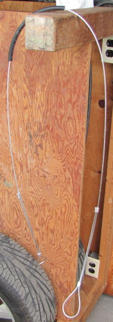

The last time I had a problem with this, I built a double loop pulling cable.
The double clips nearest the loops aren't crimped, so they slide and you can choke the two loops
down for a tight fit around the axle. Set them at 180 apart for an even pull. The rubber hose in
the middle makes a nice handle.
I had planned to run the pulling end through a large weight and use it like a slide hammer,
but with the right pulling point on the axle, the clip just gave up it and the axle popped right out.
5 bucks worth of parts at Home Depot.
