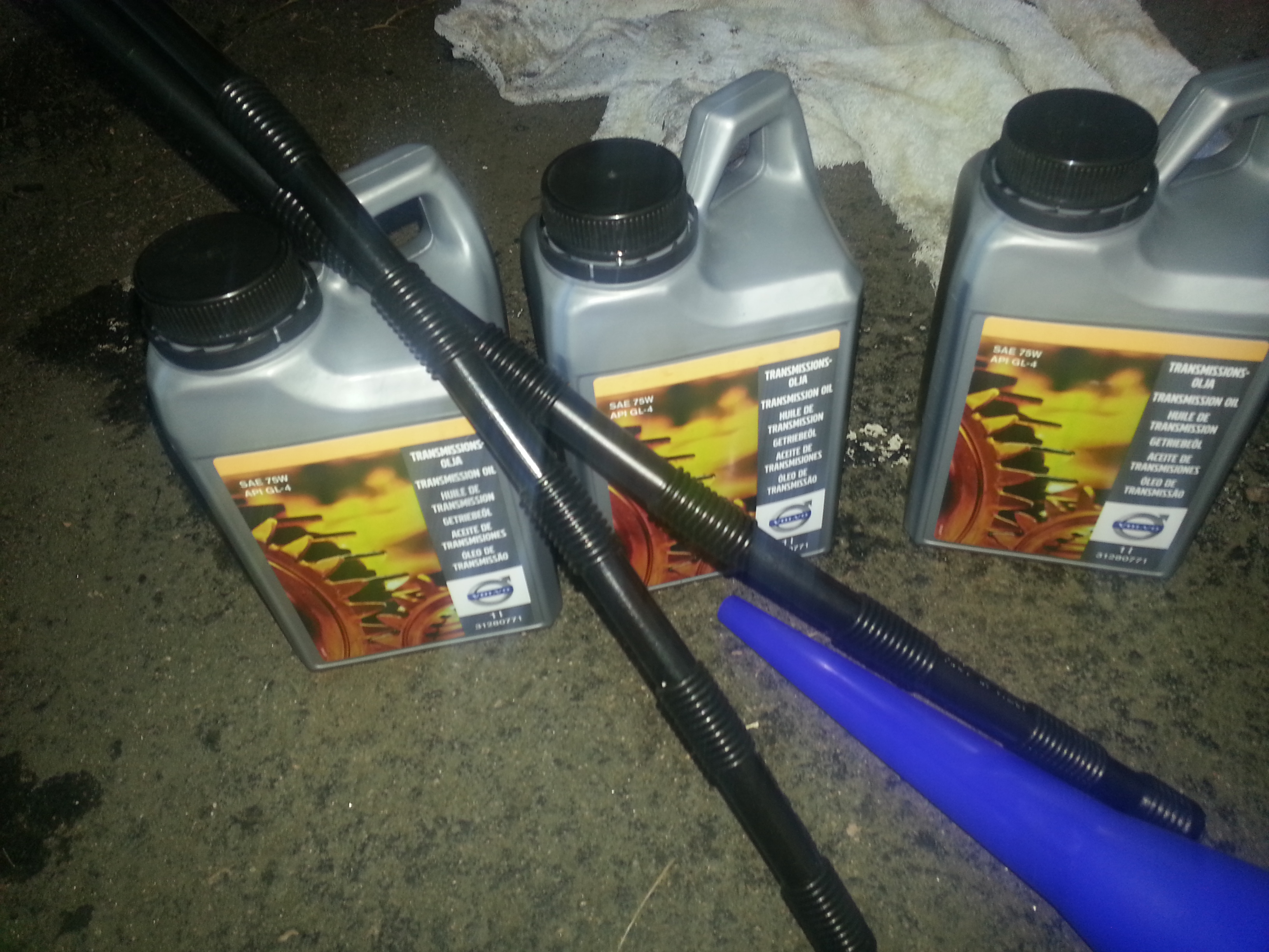

What you are going to need:
1. 2 liters of Volvo Transmission fluid #31280771
(I'm not going to argue about OEM vs Brand X. I did my research and if this is what my mechanic uses (fanatical Volvohead) for his M56H tranny, then THIS is what I use.)
2. A 24mm Socket
3. A 24mm Wrench
4. 2 new crush washers
5. A socket extension at least 10 inches long
6. A funnel and tubing or a pump of some kind
7. A large oil change container.
8. A lot of rags.
9. Jack.
10. Jack stands.

If you are using a funnel and hose make sure you have enough to make it past the wheel well and elevate it above the fill hole. Pour your lovely new transmission fluid in and hear your car sigh with pleasure. You will know it is full when it starts to run out of the fill hole. Using a flashlight look into the transmission and you will see the fluid is flush with the base of the hole with surface tension holding there. Put the fill plug in and you are almost done! Before placing the wheel back on wipe up as much fluid as you can to help you confirm the integrity of the seal on the drain plug. Put the wheel back on, jack up, take the stands out, lower and tighten the wheel. All done son. Put your stuff away, clean up and take a spin! Did I notice a difference in the action of the tramsmission? Not really. Do I feel better after changing the fluid in my tranny after 107,000K? Yep.

Just a quick point:
The volvo transmission fluid containers say right on the side that they are 75W API GL-4. This should be plenty of info to help us pick a suitable replacement that's not from the dealer.
Good gear oil is actually pretty cheap and any 75W-90 that says it's a GL-4 should be fine. Maybe ask the folks on BobIsTheOilGuy.com for advice beyond that.
One last thing on the oil: if the original Volvo oil is a GL-4 I would be damn sure /NOT/ to use a GL-5. I have not experienced this first-hand but I have read that GL-5 oil in a GL-4 box can cause bad problems, specifically relating to adverse chemical reactions between the oil and the metals.
