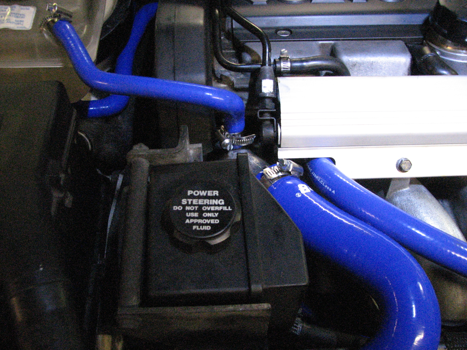

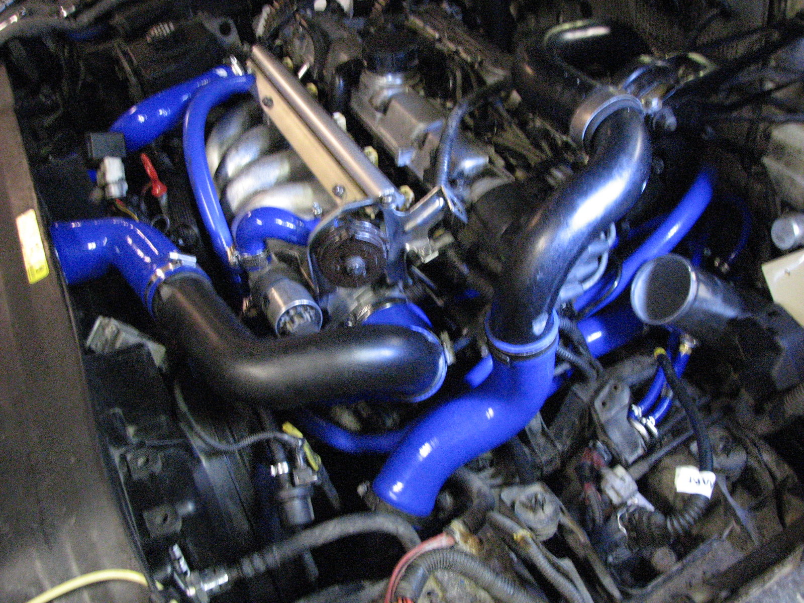

This seems to have come up a few times lately. I had recently replaced almost all cooling components in the engine compartment area of the '96 Turbo Wagon but thought little of the heater core.
I believe it has been Robert, "rspi" on the site here, that had made mention several times.
I have not yet done the heater core in either of my 850s, although I have been looking at cores for both cars.
The Wagon had a few drips of coolant toward the right front of the engine compartment at the end of the hot summer last year.
I was not given the complete history of this car, I was told the timing belt, water pump and pulleys had recently been done.
They were done with nice INA pulleys and a Conti belt.
I noticed the water pump was not branded and I would prefer Aisin. Also, the hydraulic tensioner had appeared to have a slight leak. Although it was an OEM Aisin tensioner, I knew it had not been replaced.
I had felt better to replace a few more things while doing some minor modifications.
The radiator was indeed tired. I had FCP send me one overnight because I had a short time to use the garage.
Bottom line for me is, when I am already in a difficult area, I will try to replace anything that is reasonably accessible and/or tired. (funds allowing.)
I will likely have to pull the radiator sandwich again to change the A/C dryer. Yay.
This is still fun for me personally. It is only not fun when I don't expect to have to do it. So preventive can be good when it is convenient.
There is still the one small coolant hose to the turbo that is in a tight space to access.
My thought would be to change the complete metal tubing behind the engine this summer while swapping out the exhaust manifold with the '04 R version I am sitting on.
New Radiator Manifold  and all silicone plumbing.
The blue stuff is for fun. I really don't care about being flashy, mostly clean.
I imagine from what I have heard, I may do the heater cores in both my Sedan and Wagon for the preventative maintenance factor.
It seems I may have been lucky so far as to not have had a breach to the heater core in either the '93 Sedan, or '96 Turbo Wagon.
Even the expansion tank to the rear distribution tube seems like a good idea for a good hose.
