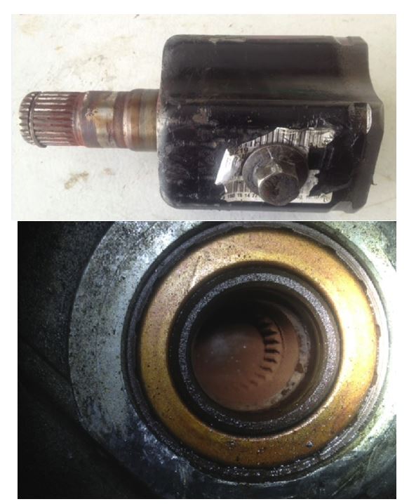

The corroded driver side inner CV joint is finally off my 2002 XC70. It was quite a struggle and big relief.
Very unorthodox, but I drilled into the inner CV joint housing and put a good size bolt in order to get a good grip with a vise grip before using a homemade slide hammer to pull it off the corroded trans axle spline. It took quite of bit of gentle to hard hammering but it finally let loose.
I was thinking of trying the axle puller adapter from Autozone as suggested earlier, but I honestly thought that it would not give me enough leverage to crack this axle off. I had struggled quite a bit with it using so many kinds of wedges, pry bars and hammers.
Included are the images of the corroded shaft and inner spline. Frankly, I had expected some amount of ATF to be visible on the inside (as was the case on my S70). All I see on this one (2002 XC70) is corrosion and no wetness at all. The oil in the bottom of the seal is from rust penetrating spray which did nothing at all.
Thank you for your inputs...

What are your next steps to put it back together. I used spline grease to help it.kseyoum wrote:The corroded driver side inner CV joint is finally off my 2002 XC70. It was quite a struggle and big relief.

Cleaned the rust out with rag and some spline grease, then applied some more to the axle and installed with ease.
One more thing: I read somewhere in a post about the possibility of the axle clip falling off as it is pulled. I have to say though that there is really no place for the clip to fall into. It is a solid wall on the other side.
