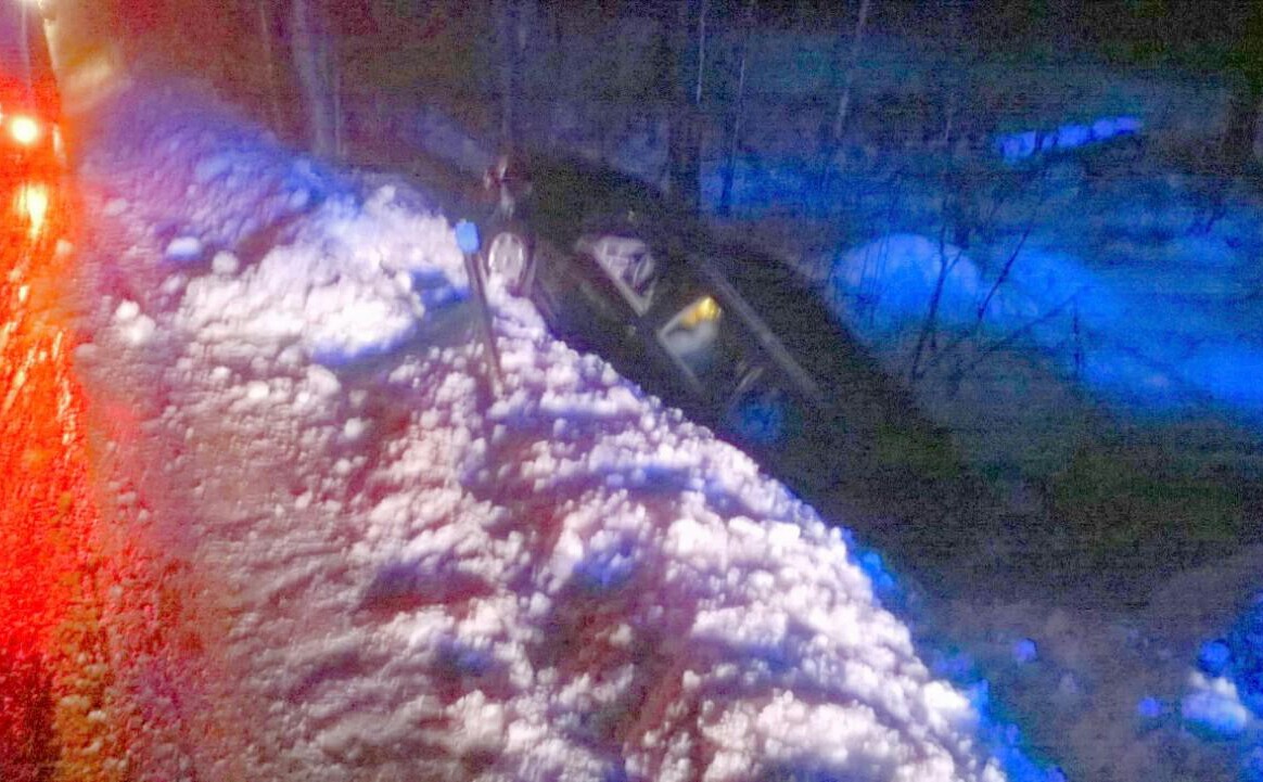

Look at the attached picture of my kids 1998 V70 as it sits with the tail in a river. This is why I bought a 1999 V70 for $1000 that needed a little work. The frame is bent and the front fenders, bumper and head lights need to be replaced. Not worth it with 180K on it.
