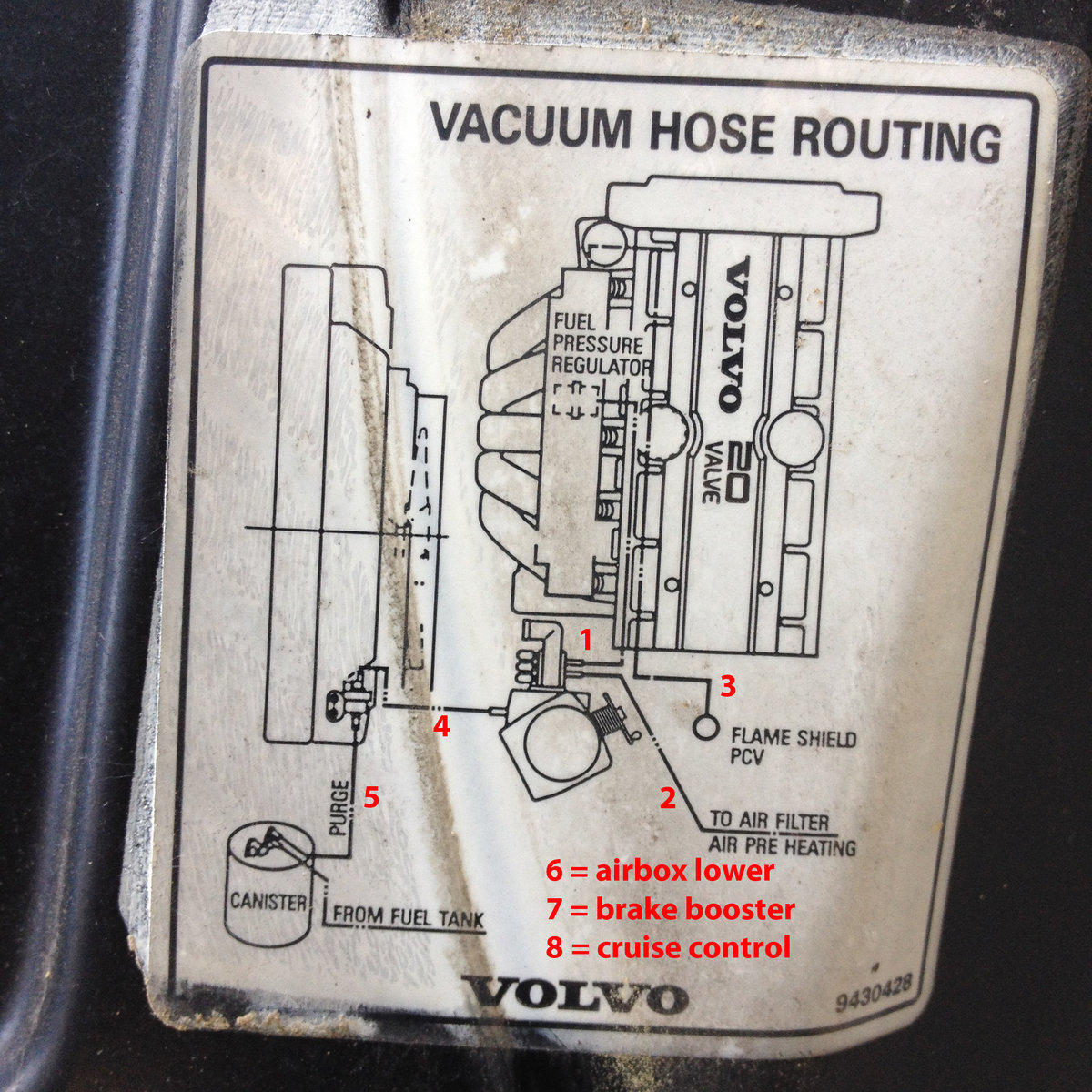

First the stickers, then the photographs.
For cars still equipped with SAS:
The simpler diagram for cars without SAS:

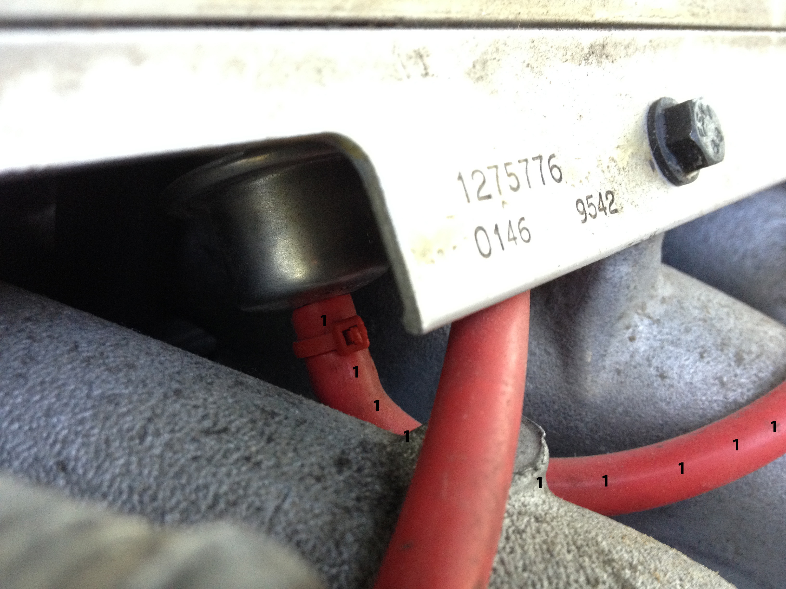

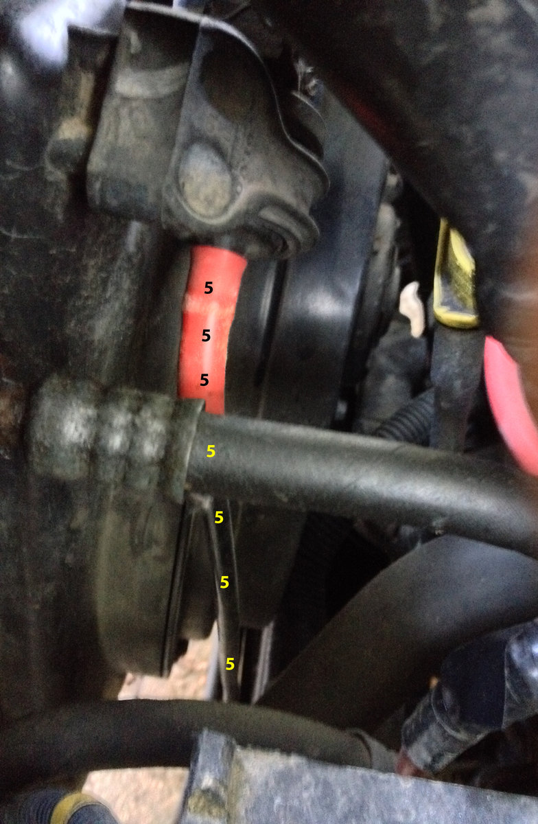

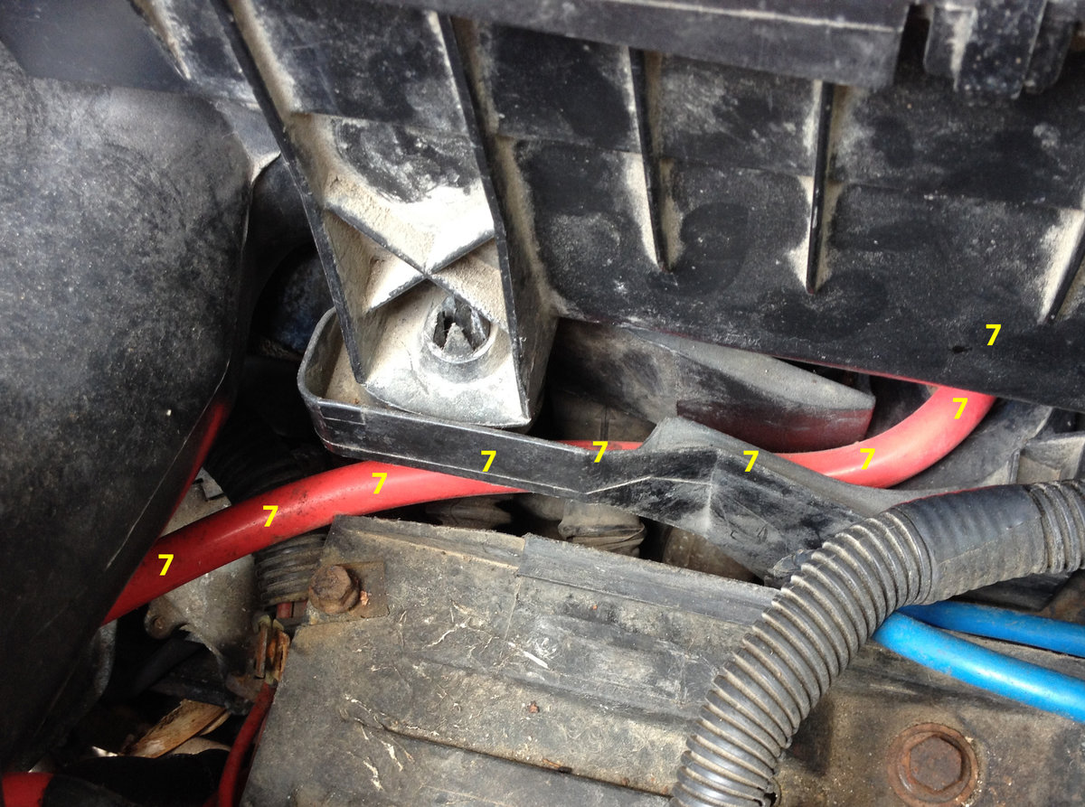

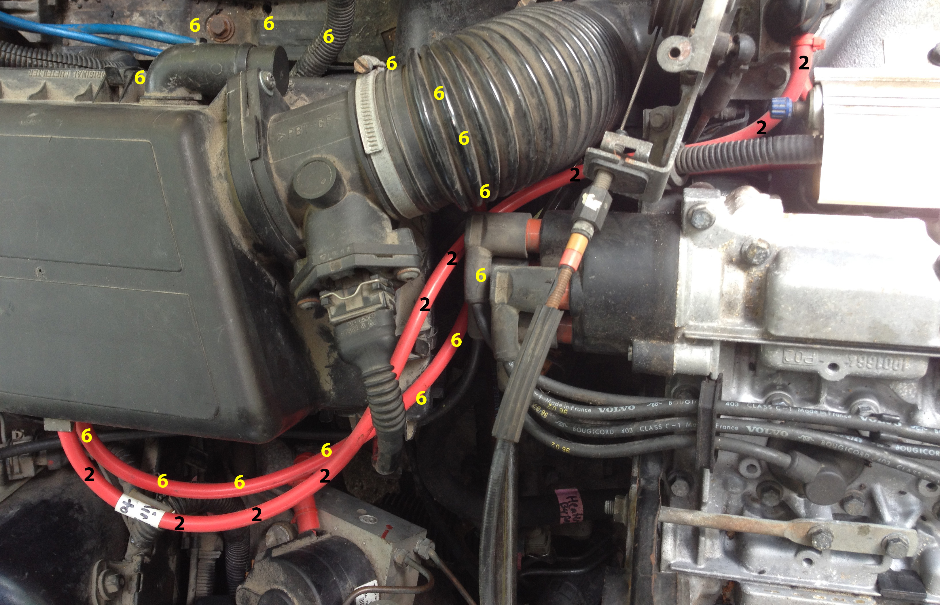

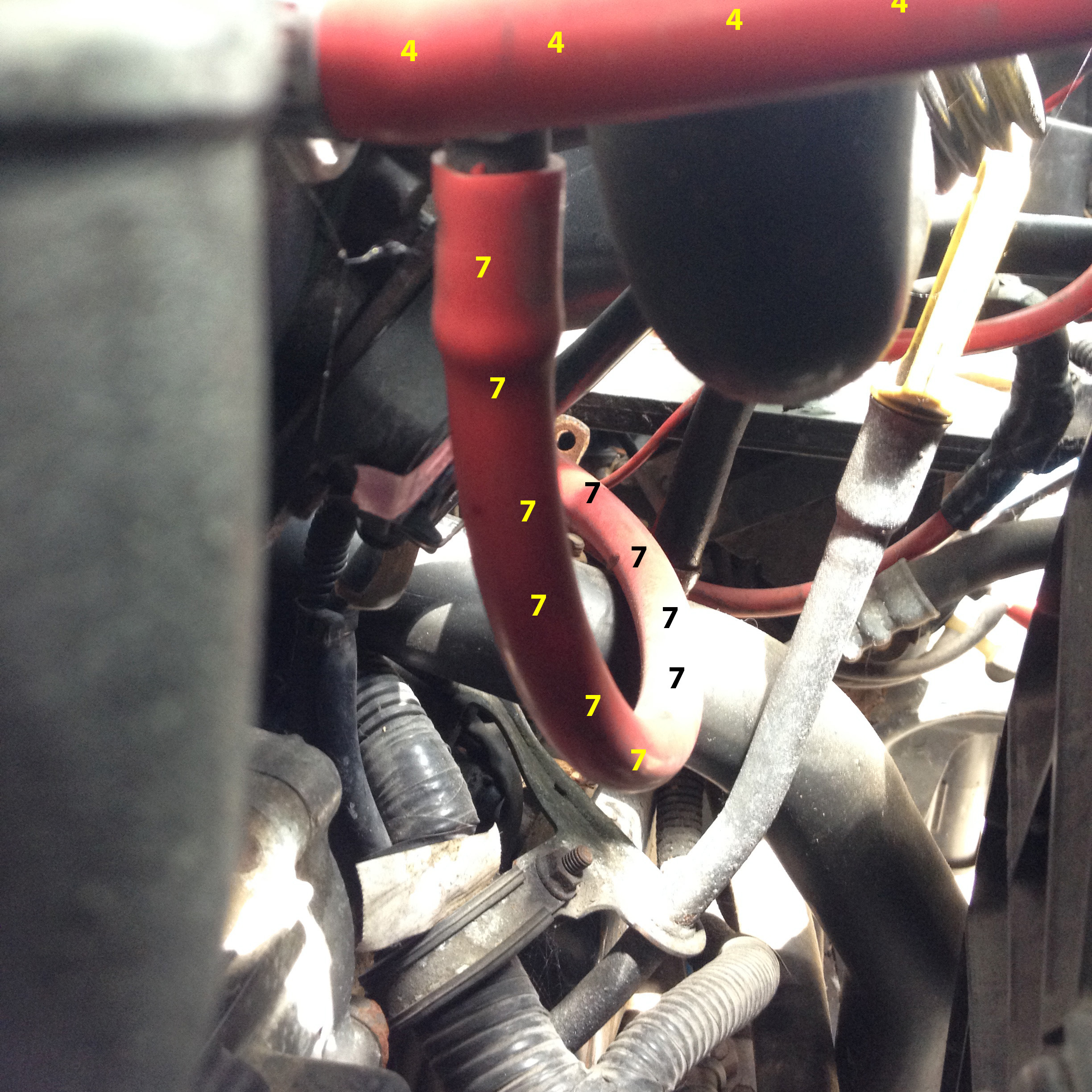

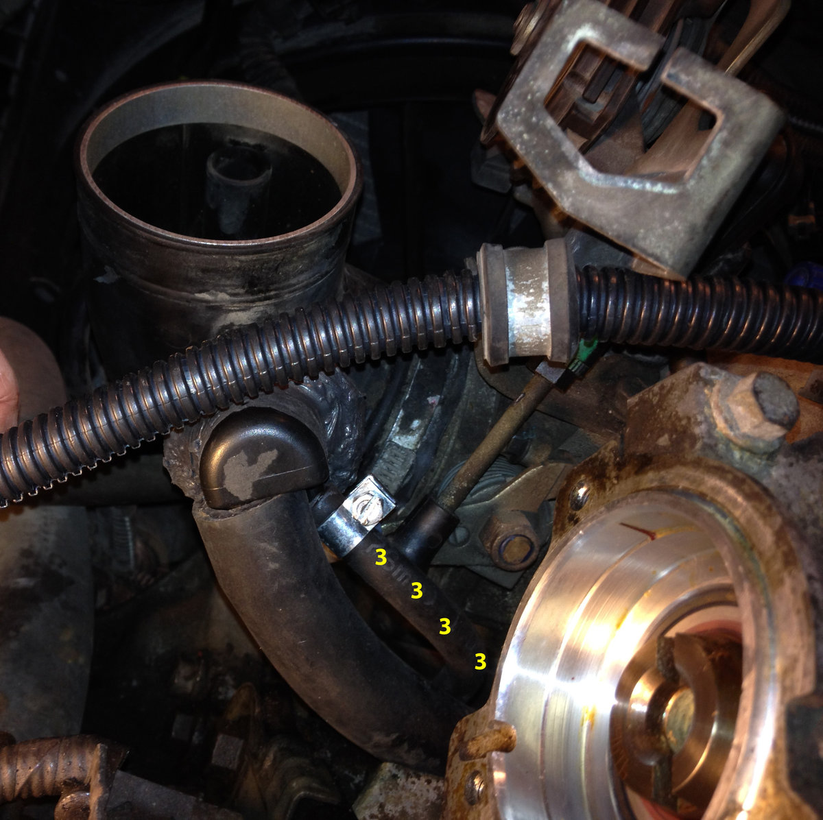

There are basically 8 vacuum lines in the engine bay to deal with:
1 - vacuum tree to the fuel pressure regulator (FPR)
2 - vacuum tree to the airbox cover, upper nipple
3 - intake manifold (IM) nipple to the flame trap nipple
4 - throttle body nipple to the purge valve
5 - purge valve to the charcoal canister
6 - airbox cover, lower nipple, to the bottom half of the airbox
7 - fitting on the throttle body to the brake booster
8 - cruise control pump back through the firewall
Here the eight lines are marked on the diagram:

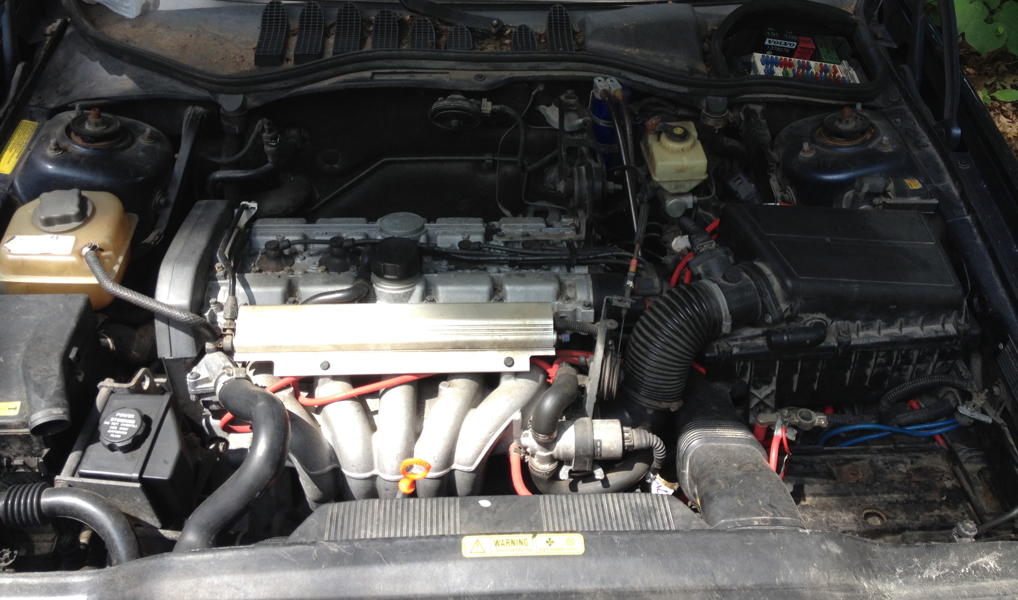

Now, some pics. Most of these images are from a non-running car out in my driveway, so the engine bay is dirty and the battery is missing etc. However I installed fresh, red, silicone vac lines just before the car stopped being used so they are easy to see.

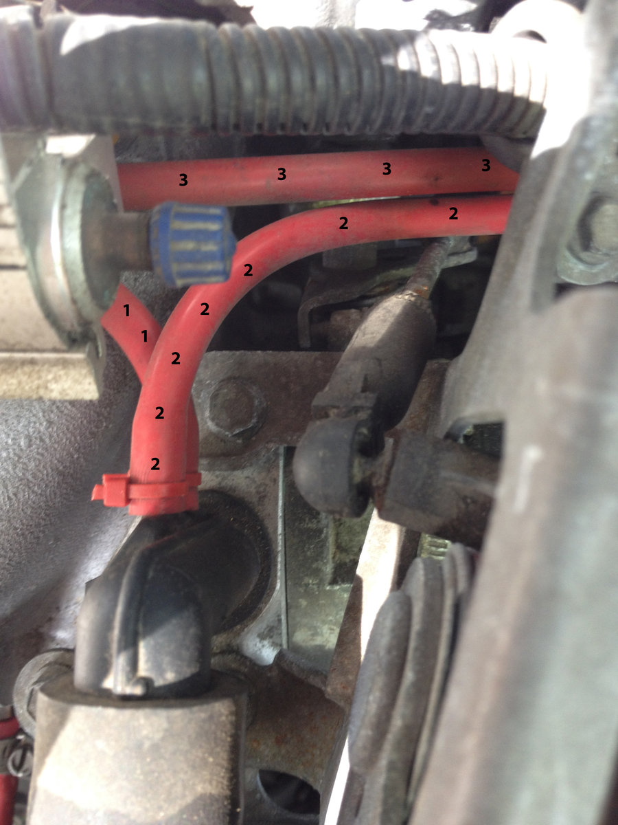

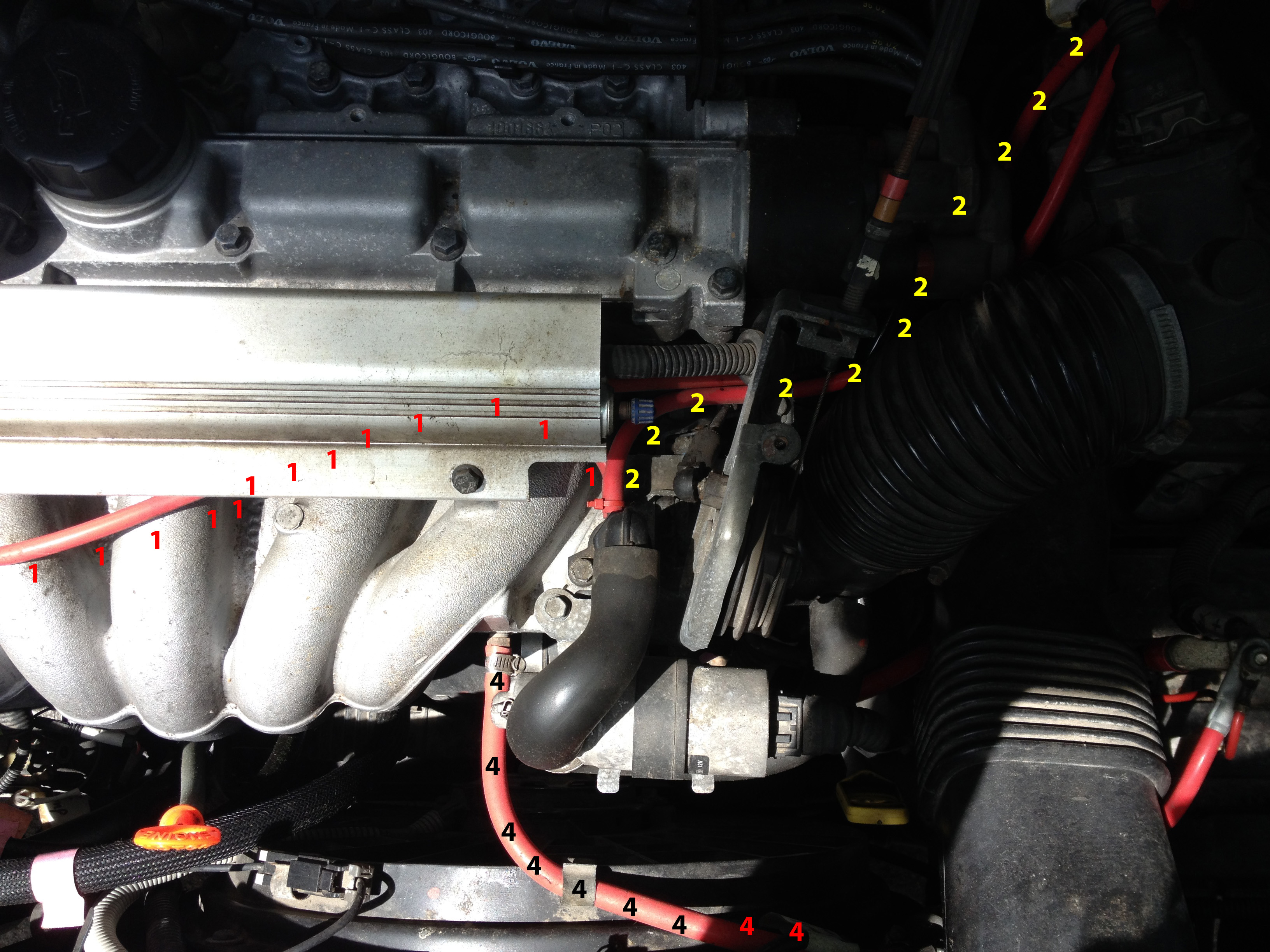

Start with the vacuum tree, note that three ports/nipples are capped and two have vac lines on them (lines 1 and 2):

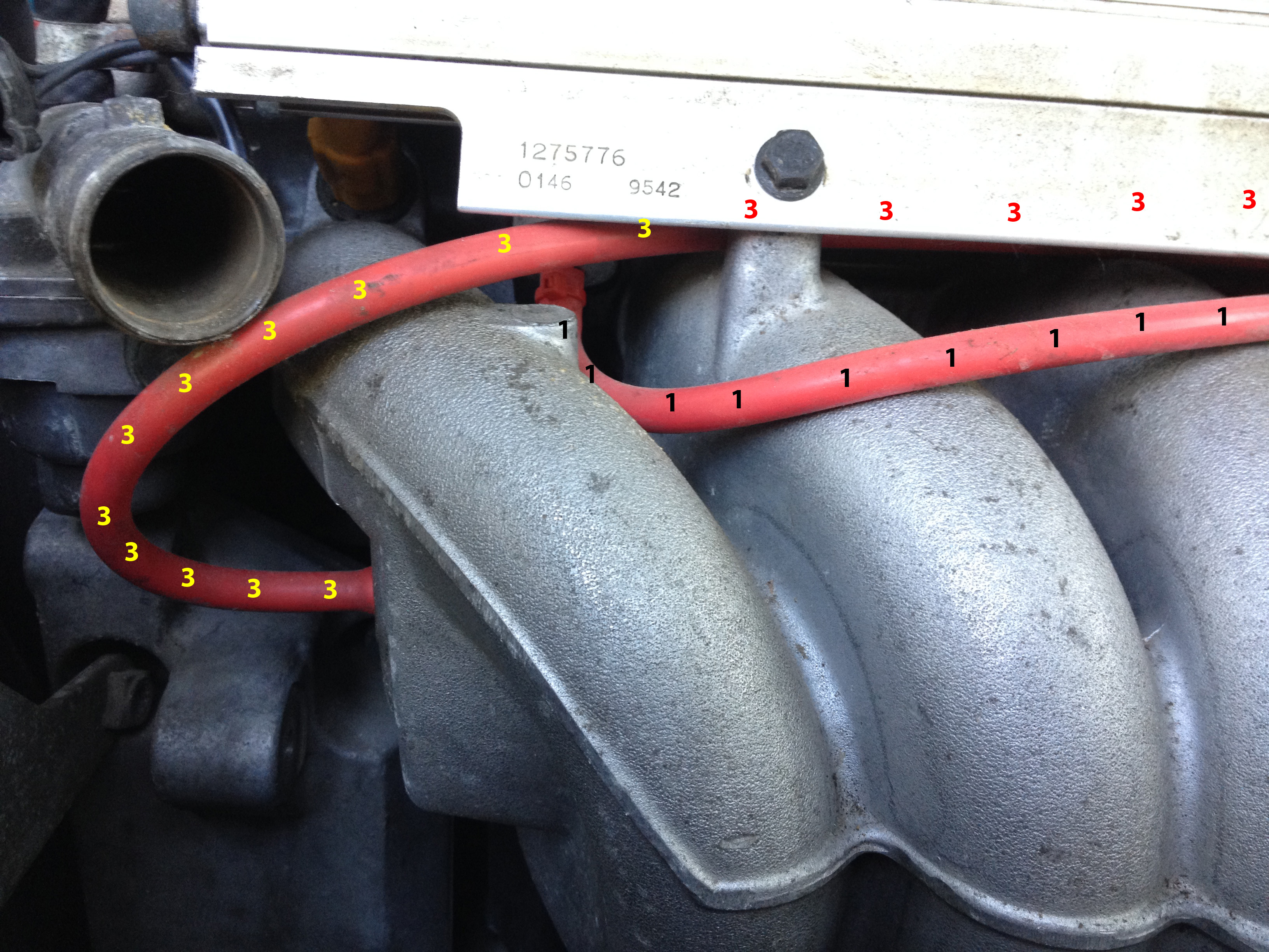

Where line 1 attaches to the FPR, is nearby to one end of line 3:

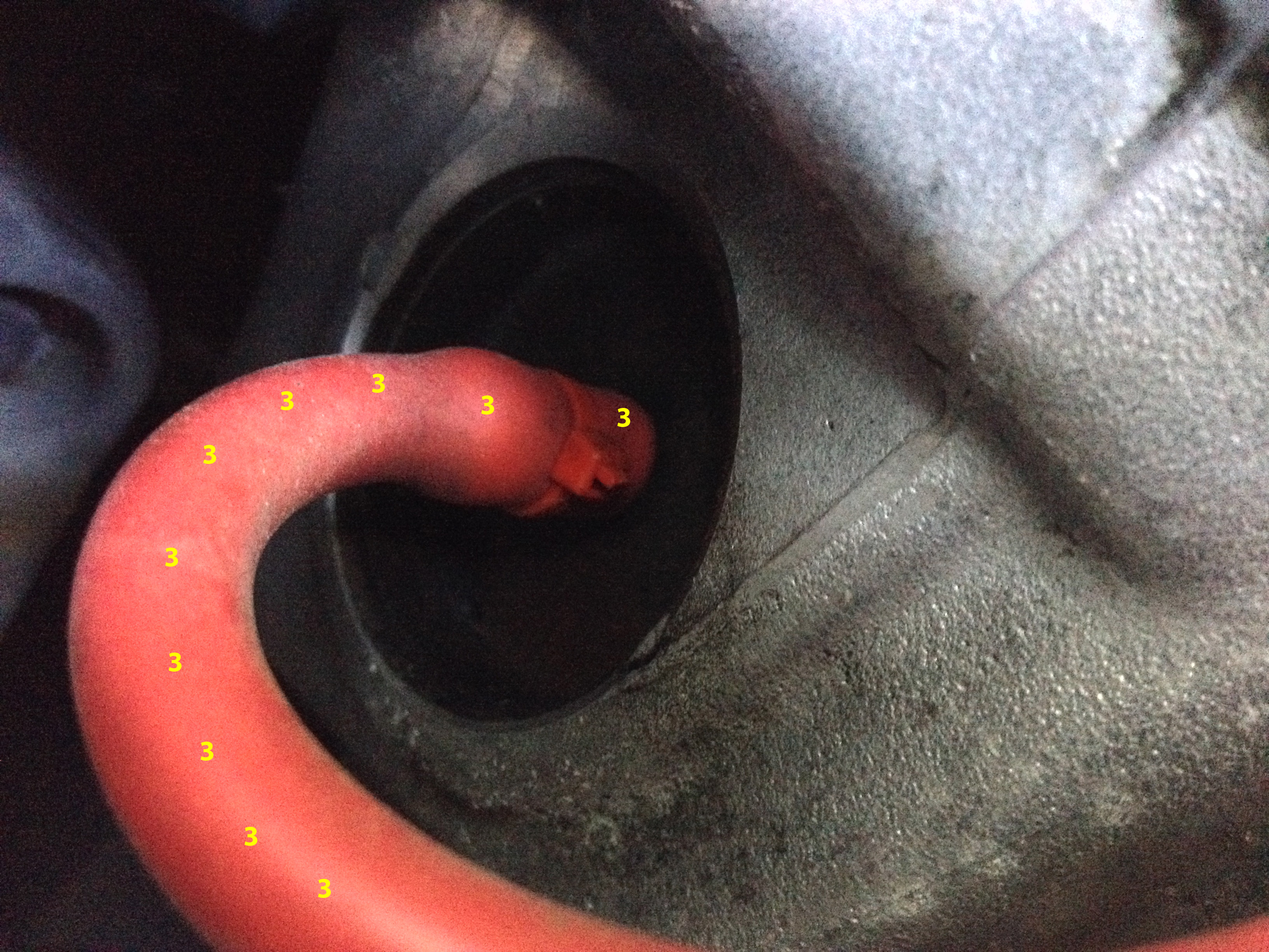

Line 3 "starts" at the nipple on the intake manifold. This one can be a PITA to work with, and note that silicone line is NOT recommended in this application as it will sweat oil and get all slimy. Use a generic 3/16 rubber vacuum line here.
Line 3 can be routed over, under, around the intake manifold, whatever works, so that the other end attaches to a plastic nipple on the flame trap. Here are some pictures of that from other vehicles. The first pic shows the flame trap housing out of the car and opened up. The piece with all the little holes is the flame trap insert. If the insert is still in your car, remove it and throw it away, all it does is get clogged up. Then just close up the housing. The white hose in the pic is what we are calling line 3 here, it is connected to the flame trap nipple.
Here is a shot of line 3 (in generic 3/16 vac line) attached to a flame trap housing that is in the car; note that the distributor cap is removed from this vehicle, so you can see the back end of the intake cam in the lower right corner:

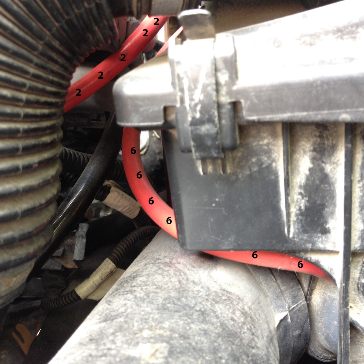

Line 2 runs from the tree over to the top of the air box, where we also get a look at line 6 that goes from the air box top around to the air box bottom:

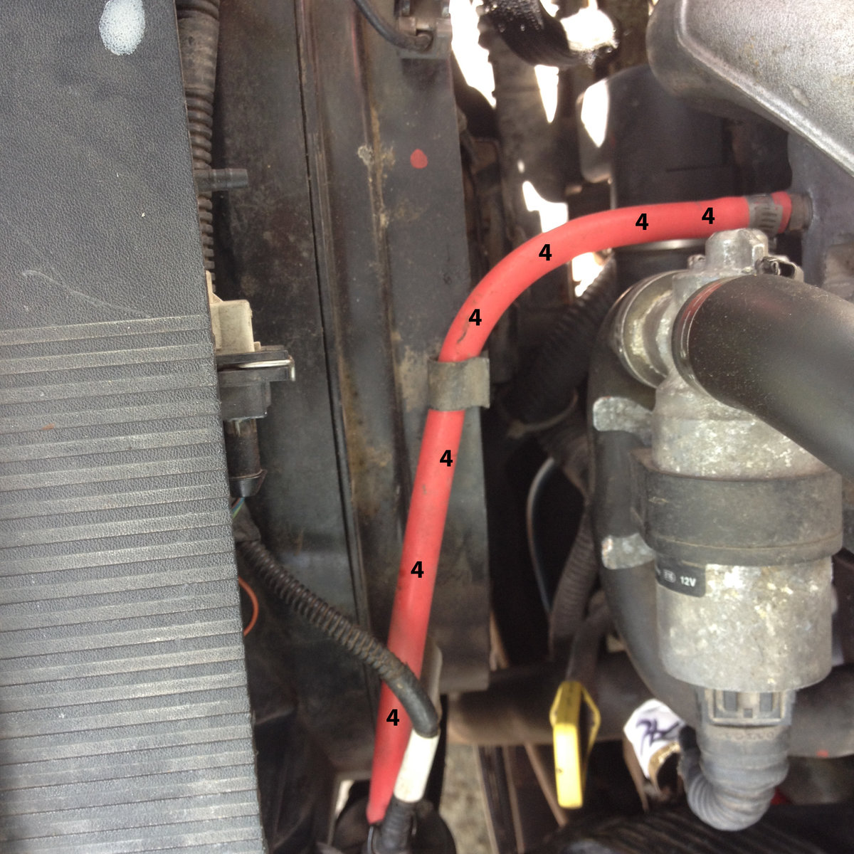

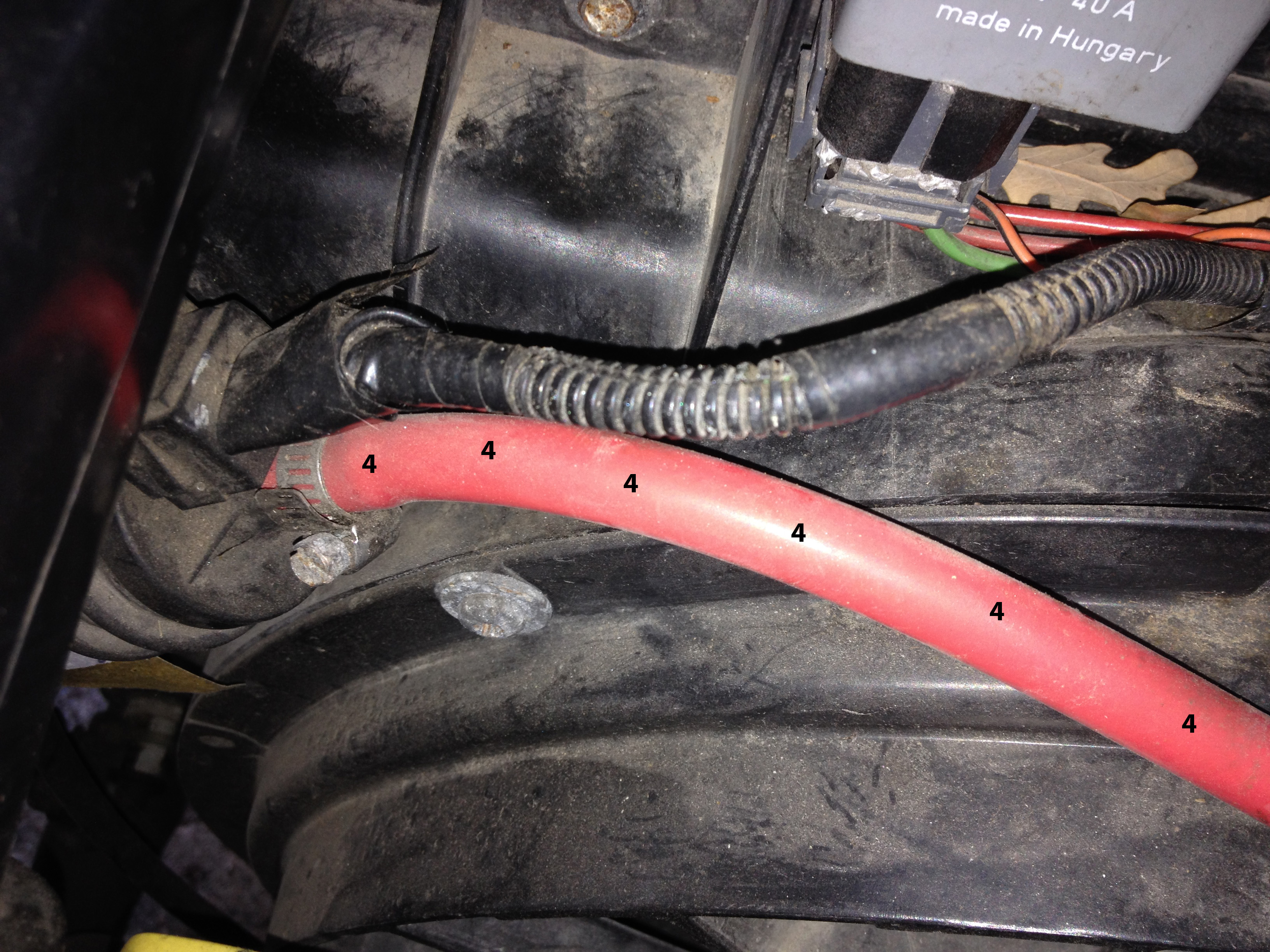

From directly overhead you can again see line 4, it starts at a nipple on the intake and heads to the radiator fan shroud where is connects to a purge valve:
Note that the purge valve can be round or square, this car has the round type. And then off the bottom of the purge valve we have line 5, I do not have documentation of the other end of line 5 at the charcoal canister:

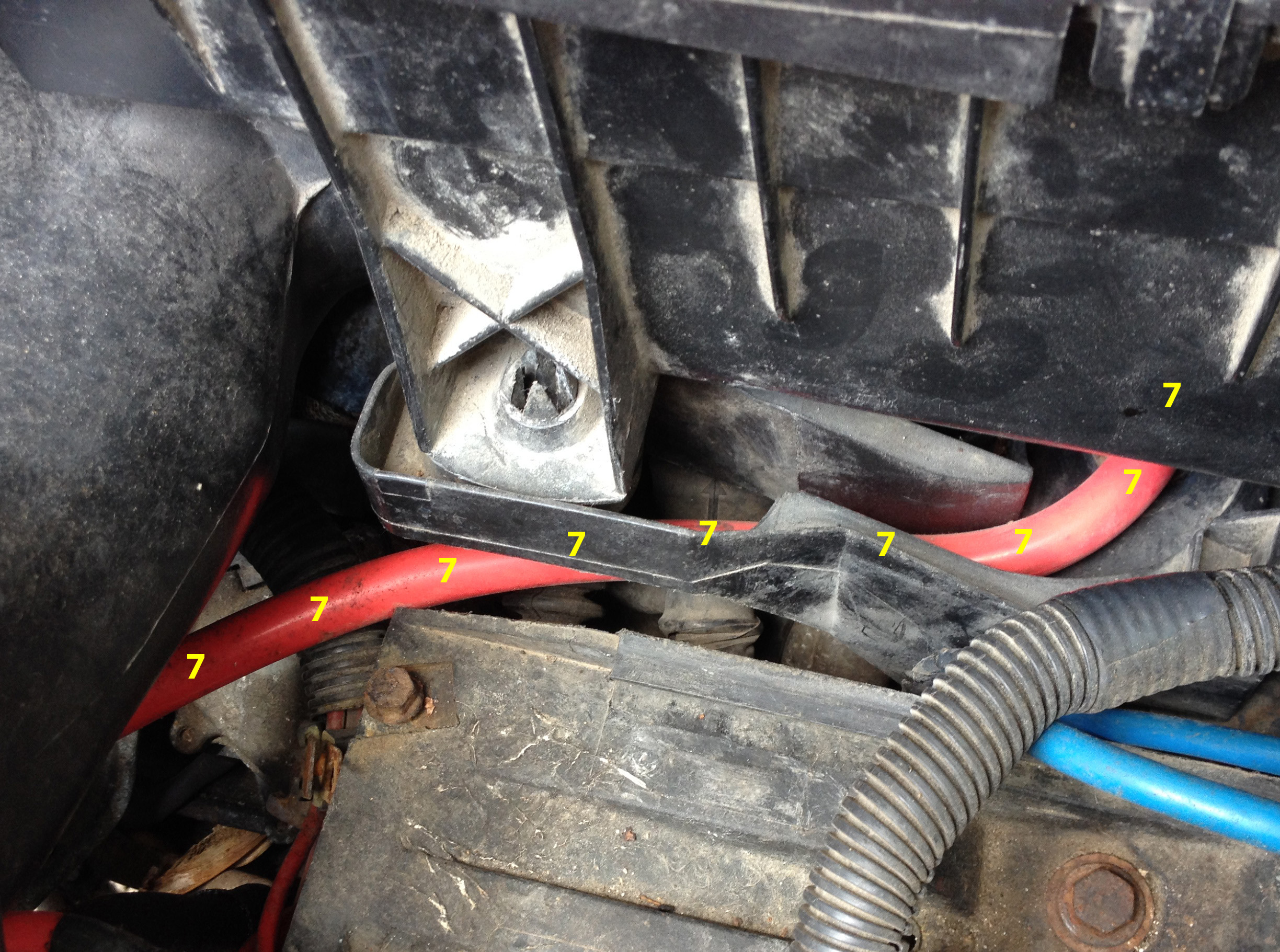

And finally line 7 is a thick-walled line from the intake/throttle body over to the brake booster. From the factory, this line was black and very thick. A thick silicone line works well here too, or you can go with rubber:
Line 7 meets a connector under the airbox, I did not remove the airbox to document that.

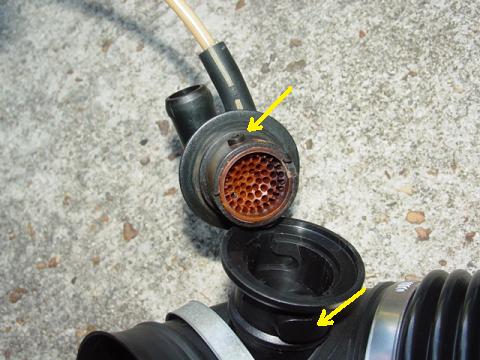

On the back side of the air cleaner housing, there should be two vacuum nipples in what looks like a clamp. Number two is the upper nipple. the lower will route down to the the bottom of the airbox, where the preheater duct comes from the exhaust. (#6 in the pictures) This connects to the preheat air thermostat for the airbox.
