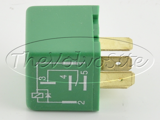

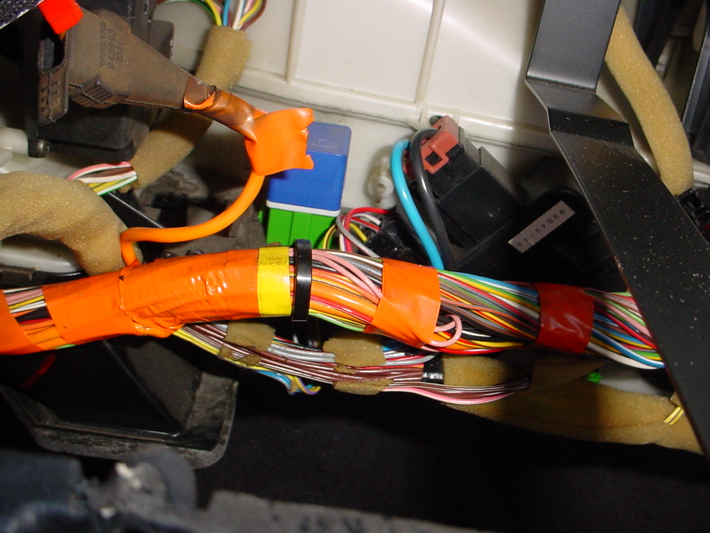

A bad max fan relay will kill all four speeds. On the MCC there are two relays on a metal shelf just above where the blower resistor is located. One is the AC relay and the other is the max fan relay. You can swap the two relays and see if things change.

Mister850: Here are some pics to help you out. I had the same problem on my 1994 850.
- Volvo_blower_motor_power_stage_ecc.jpg (207.96 KiB) Viewed 1213 times
- Volvo-Relay-9494787-AFT.jpg (148.42 KiB) Viewed 1213 times
