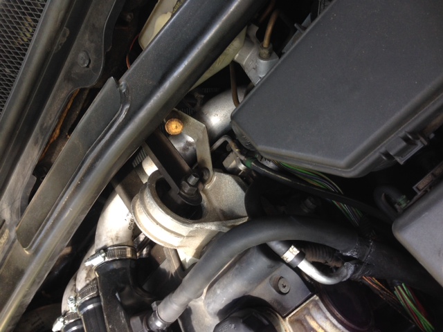

Here's my mount. The bushing has broken up and fallen out. So, I'm wondering if I should get the polyurethane bushing, or "an assembly" (which i think would be the metal mount, arms and bushing).
I can't tell from my local dealer's site if part 24 is the whole assembly (which would look like just the metal mount, plus bushing) or just the bushing: http://www.jimellisvolvoparts.com/showA ... ly=1054369
If the entire assembly is only $50 that seems like the way to go.
Any thoughts?

Post by kahl »
The aluminum mount comes with bushing. Remove the bolt that connects the arms, 4 bolts that hold mount to engine, then remove bolt that holds the grounding strap. 15 minute job. make sure the mount you get has threads for the grounding strap bolt.
