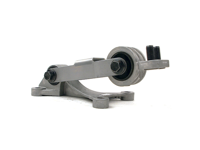

Thanks. After checking the mounts I found that all of the sub-frame mounts (or bushings) and the engine mount (right under the camshaft) were all okay and did not appear to be cracked or broken. I did however buy the IPD Sub-frame Bushing (http://www.ipdusa.com) Inserts into my bushings for added measure and I did replace the transmission torque mount as well as the upper engine mount. All seems to work very well for now. :D
Note: After a few months and about 3,000 miles plus later, I notice that the upper engine mount is tearing again due to the high heat and vibrations i guess. I might need to replace it again in a year or so.
Inserts I bought from IPD USA for $60
New transmission mount from IPD USA $50
New upper engine mount from RMEuropean $45
