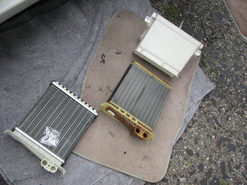

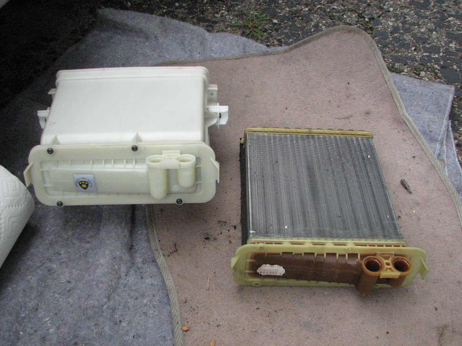

Would it be pointless to take this one out and run it through the dishwasher? Its been in the car for a few years...

Depends on how tired you are of the smell. You can also find a odor remover and run it in the car to make things smell better.

I doused it with some clorox cleaner before i put it back in. i guess i will try the dishwasher trick. hopefully my dishwasher won't smell like coolant afterwards!

You need lots of soapy water to get the oil off. Removing oil with water needs surfactant.. (Soap)

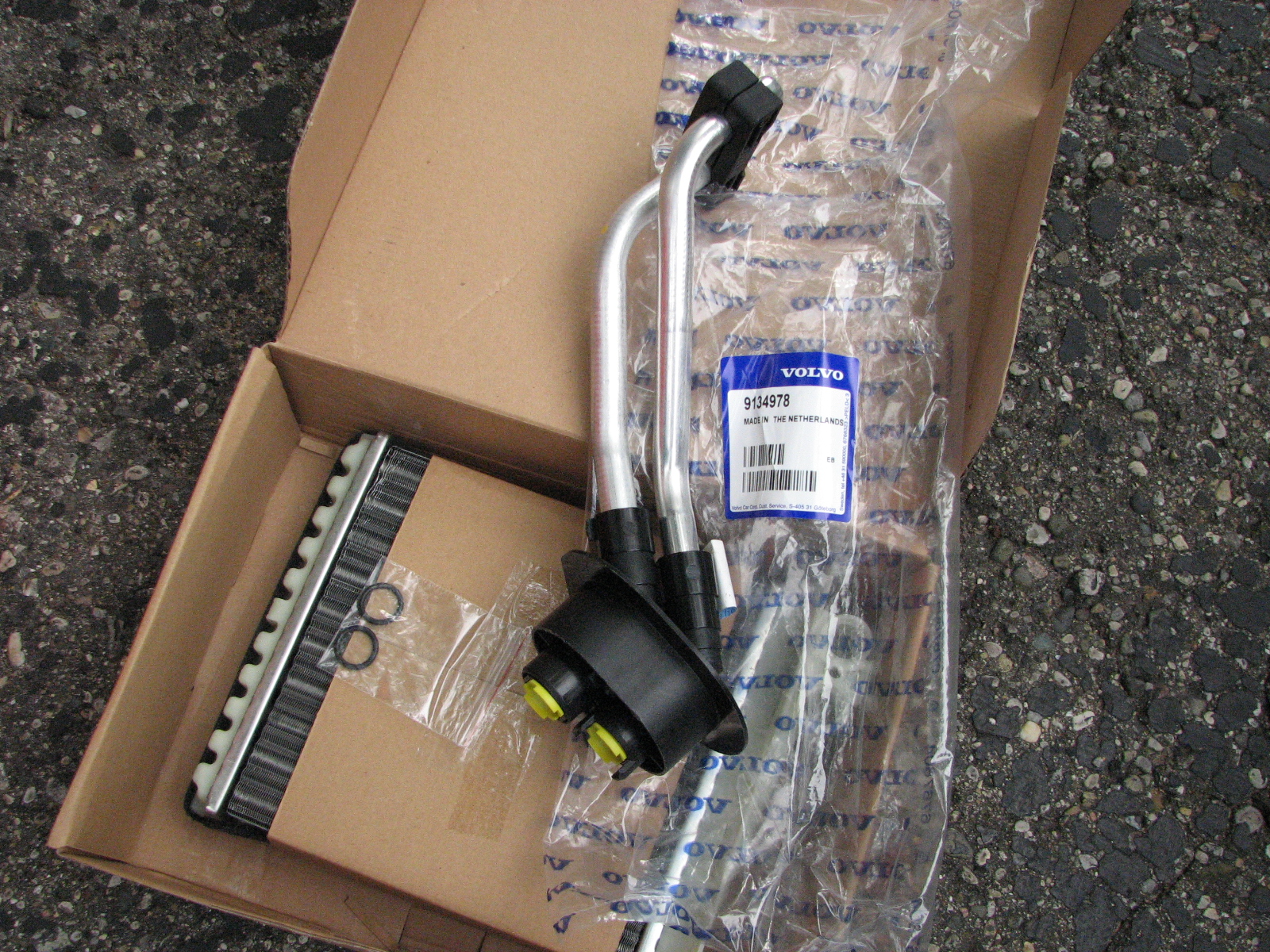

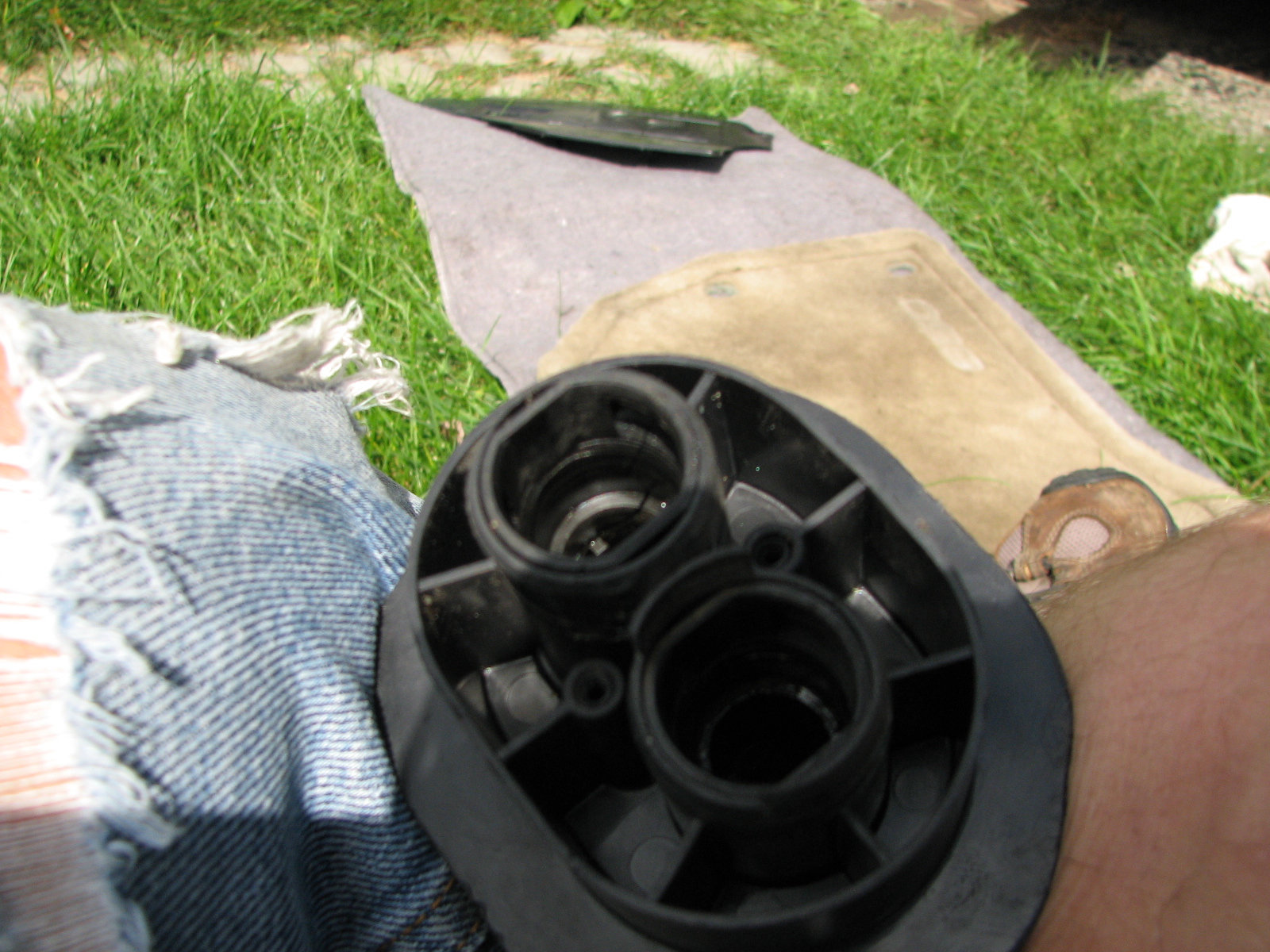

I also installed the Swedish Car Parts unit over the weekend, along with the tubes and the firewall junction which I broke removing the old hoses.
That plastic is extremely brittle, (firewall junction) You also need to have nimble fingers to maneuver the piece out, and back in around the gas pedal and cable (850) and behind the A/C evaporator.
It stinks a little, but not unbearable. I was under a time constraint and didn't wash it at all.

Ben,
I also ordered the junction w/ associated o-rings and clips but not the aluminum tubes. Did you find it advantageous or necessary to have the new tubes?
I take it this was on your '93 sedan. Was the original core leaking yet?
dos
dos

This was for the Turbo Wagon actually.dosbricks wrote:Ben,
dos
I ordered the tubes for an extra $30. to ensure there would be no 20 year old parts left in the plumbing equation, aside from the steel tube at the engine block. "Once Bitten".
The old tubes appear to be fine and I would not have hesitated in reusing them with new O-rings.
I have some parts for the '93 Sedan, I am fairly sure the thermostat is failed in the open position as I did not get a substantial amount of heat last winter.
Of course it was 20 below zero most of the time.

Thanks, Ben. I'm also doing all hoses as PM--I already put so many new parts on the S70 that now I don't want to lose it
