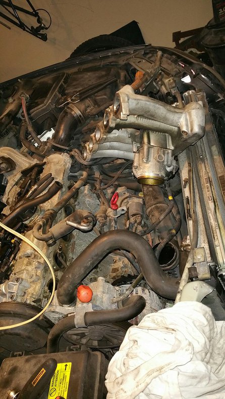

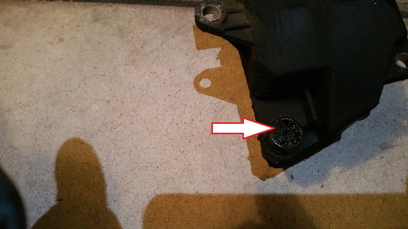

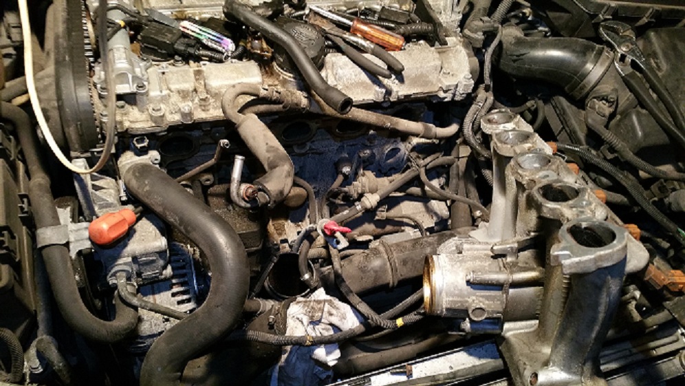

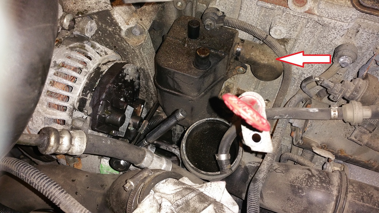

Finished the install of the oil trap last night. Assembly was almost the reverse of disassembly, except for the banjo bolt on the bottom of the manifold.
Assemble Tips
Getting the manifold banjo bolt out is much easier then installing it because you're concerned about dropping the top crush washer and you need to align the threads properly. There is very little room to work and the resistance of the PVC hose makes aligning the threads very difficult. I found it easier to remove the power steering pump and alternator from the accessory mount. You don't need to removing them from the car, just disconnect them from the accessory mount. With them out of the way the banjo bolt is simple.
When I started the car the first time, it was slow to start and stalled out after a few seconds. Restarted again without problems. Ran a little rough for a minute or so and then smoothed out. I noticed the TCV clicking like crazy for a minute before it stopped. I wasn't sure if it destroyed itself and stopped clicking or it just stopped clicking. I googled around and found a few posts on clicking TCV. One mentioned his clicking after replacing the oil trop too. I'm not sure it's related to the oil trap but a lot was done so I'm sure the ECM was a little confused when it first started up.
When I started this project it was burring about 1 quart even 1K miles. The old oil trapped wasn't to clogged nor where any of the hoses and orifices, so I'll be interested to see if the oil consumption changes. The oil cap rubber seal hasn't been replaced for a least 80K miles, I don't know they harden. So I replaced it and could tell the difference in the sealing of the oil cap. So maybe a lot of oil fumes and spillage escaped through there. Time will tell.

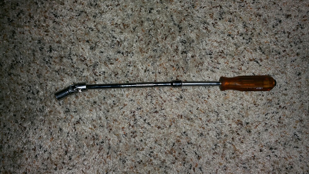

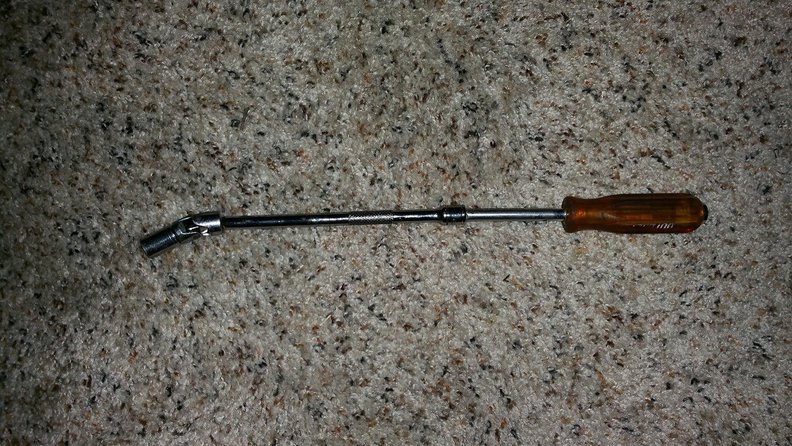

Since most owners will properly only do this once, it's a tedious job. Not overly difficult but does have its challenges. A lot of parts have to come off to complete the job and a lot to remember to reconnect. As the old saying good, the right tools make all the difference. A full set 1/4 and 3/8 extensions is a must. Along with a complete set of 1/4 inch wobble extensions. I like the Volvo crimp style clamps, so a tool to crimp them is needed.

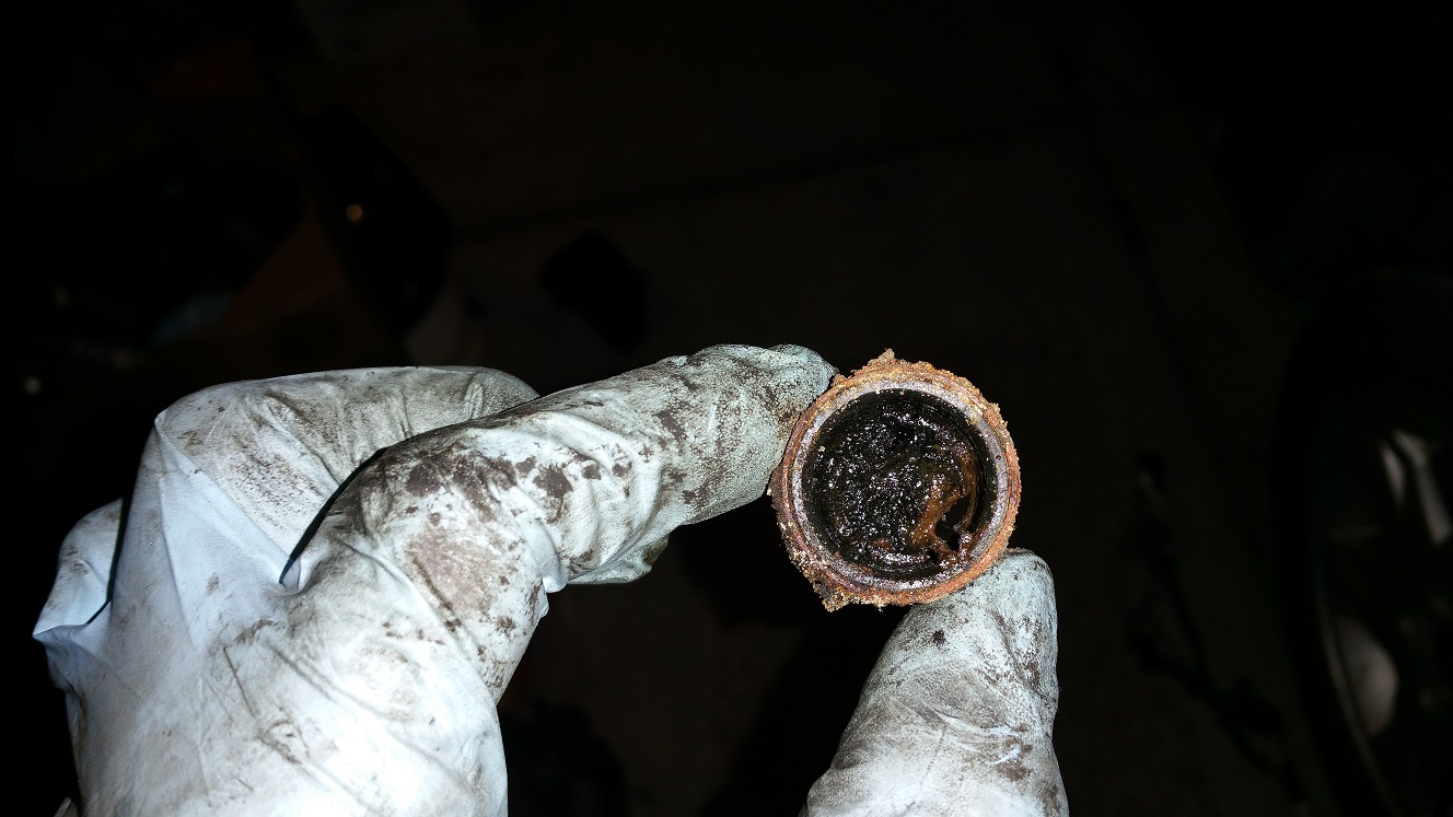

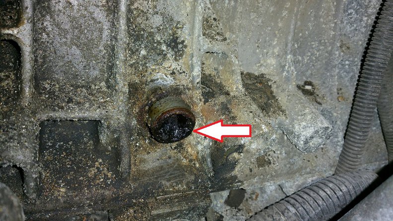

The main issue I had was the oil return port in the engine block which is where oil scavenged by the PCV tank returns to the sump, if this port is blocked you won't dissolve it and won't fix the PCV issue by pouring degreasers/ carb cleaner down in to the PCV tank.
One tip if you have the PCV tank off the car is to connect a length of 5/8" rubber hose to the lower PCV tank port engine block connection and try to blow through the other end of the pipe, if you can hear the oil in the sump pan bubbling it is free of obstructions, if you can't blow through it you need to clear it out. In my case this resulted in removing the sump to clear out a bad blockage.

That is nasty plugged for a P2. Don't forget to clean the oil drain passage in the block. Tough job but must be done if you have that much junk.

Volvo #2 is also a 2007 XC70 (130k) that I bought in November from the original owner. His story was similar to mine and the PCV system was totally blocked and oil was everywhere. I didn't mess with this, replacing the whole PCV system and dropping the pan at the same time. You can't clean the return passages without dropping the pan - period. The passage through the motor and pan is cast, a bit rough and takes a fair amount of scrubbing and solvents to remove the buildup. Once in the pan, the passage turns 90 degrees and then opens up, although there are baffles that block good access. Not easy to clean well. Volvo #2 runs great, now on synthetic and the PCV system should be good for another 100k +.
