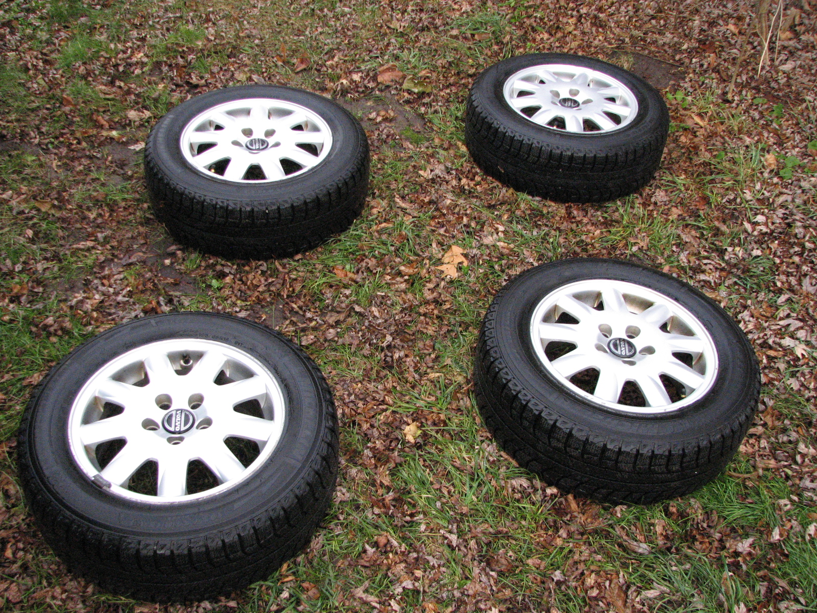

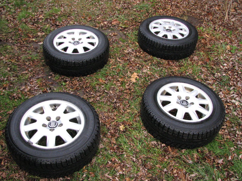

I am currently using '04 S60 Wheels with snow tires on my '96 Wagon with no issues.
The AWD are different rotors and rear hubs.
The S/V 40 and 50 models may have a different offset. The 5- lug pattern, I believe is the same.
Picked these up for a good deal. 15" forgot the name, will edit.
The 16" Columbas, were put away, for the winter.
They look alright and help with the pothole issues here in Michigan.
I have another set of original '95 T-5R 17" Titans for the Wagon this spring.
