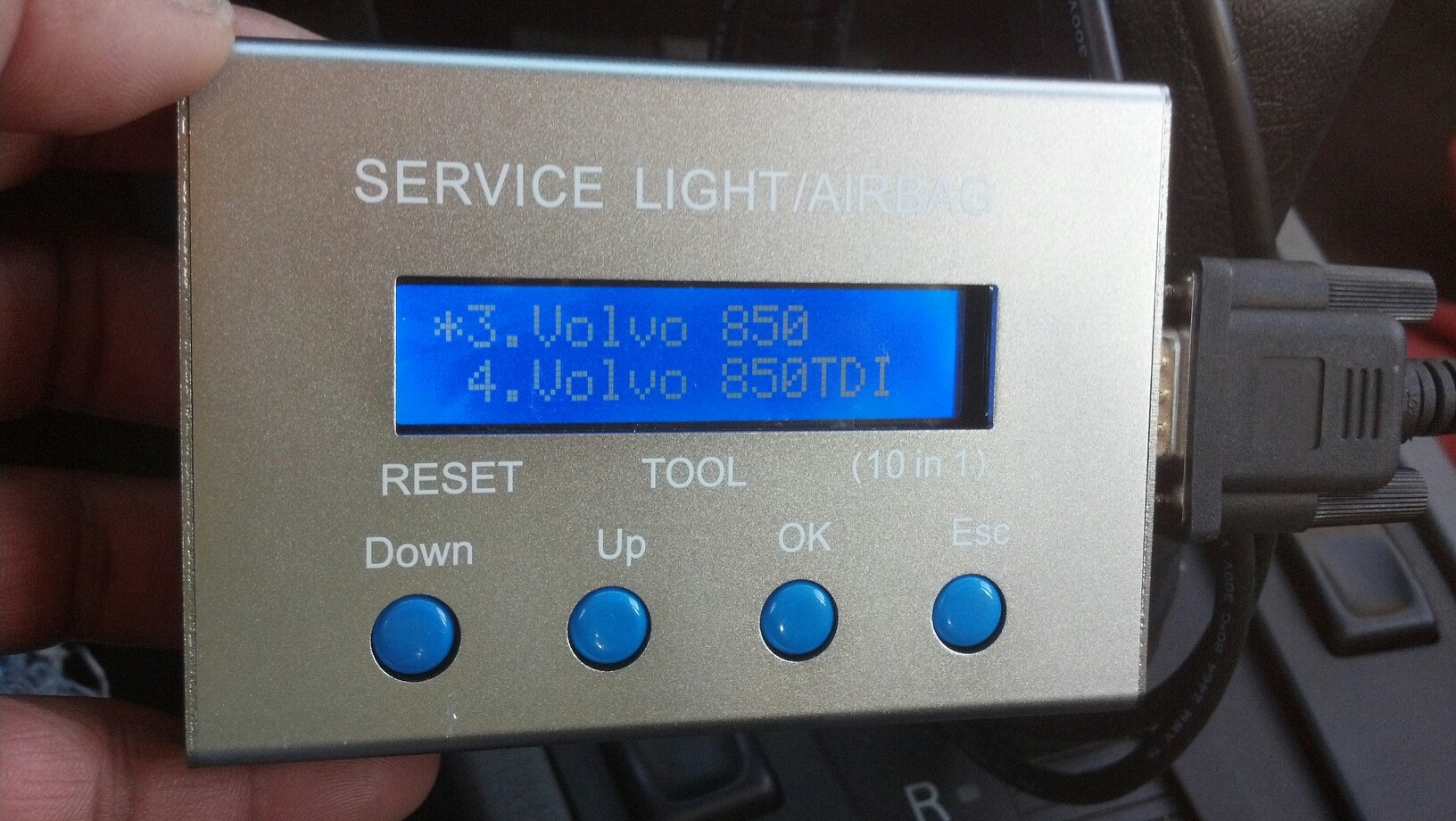

I purchased this tool from eBay, arrived from China in about 25 days. It did reset the "Service" light in my '96 855T.
Service / SRS light reset tool works on 1996 850

Why you didn't buy vol-fcr for the same price and you could have access to all modules in the car including service light reset?
If you have a Motronic 4.4 car...you could read & clear engine codes too.

It's software that runs on PC/laptop through a special diagnostic cable (usually a serial cable)
Very cheap and works well, except that the unlicensed version won't clear the service light. It found the hidden tranmission code on my 98 V70R recently.

Only demo version will not reset service light!precopster wrote:..Very cheap and works well, except that the unlicensed version won't clear the service light...
I have vol-fcr from e-bay and it works like a charm,including service light reset.

It cost around $44.precopster wrote:Very cheap and works well, except that the unlicensed version won't clear the service light.
What sort of cost for that tool Robert?
So I would need the Vol-FCR software, then purchase a cable, then install the software on my computer, then carry my computer out to my car and other vehicles to use it?
That is how I lost my last computer a few months ago, stopped to visit a friend and someone busted my window out in their driveway in an affluent neighborhood and walked away with it.
