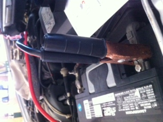

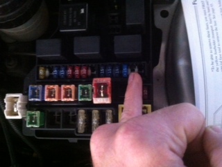

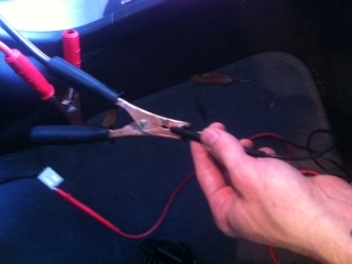

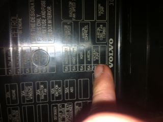

I re-administered the voltage test, using the negative jumper cable wire and connecting that to my voltammeter and negative post of my battery (pictured below). (with the ignition turned to position II) The results are as follows;
Pin 2 DCV 79.1
Pins 3 and 4 both .007 ACV with no change when adjusting climate CTRL knobs.
In checking my fuse boxes, the only blown fuse I found goes to the vacuum pump, and I'll be ble to replace that later this afternoon.
Do you think that using my jumper-cables is a sufficient ground for testing the voltage?
Pin 2 DCV 79.1

First, here is some good stuff on the vacuum pump in the forums:
https://www.matthewsvolvosite.com/forums ... =9&t=43817
(your fuse is blown most likely for a reason)
For the purposes of a voltage test, your reference (negative, ground) point looks excellent to me.
The readings: Pin 2 is supposed to read zero at all times (it is hard-wired to ground at 31/1 via JP 43/401) I would assume you are reading 79.1 millivolts (0.0791 VDC) which is quite close to zero.
If all is good and working, the potential on Pin 4, will have both DC and AC components and depending on the blower speed, will vary from battery voltage (approx. 12 VDC with the blower at zero speed) all the way down to zero VDC at maximum speed. At max speed, the relay 2/19 is picked up and its contact (4, 2) is closed, which connects JP 43/400 to JP 43/401, which we know is grounded at 31/1. This would be the case with all good and working. Now, if CCM is bad or just not getting power, it would not command 2/19 to close. You want to confirm that the connectors to CCM are snug before condemning the module. Since you have no lights and no control pulses on speed regulator ‘resistor’ Pin 3, the CCM is a suspect. But check to see if it’s getting power first. Before removing any connectors and/or fuses, make sure you have the Battery Disconnect/Reconnect Procedure and follow it
