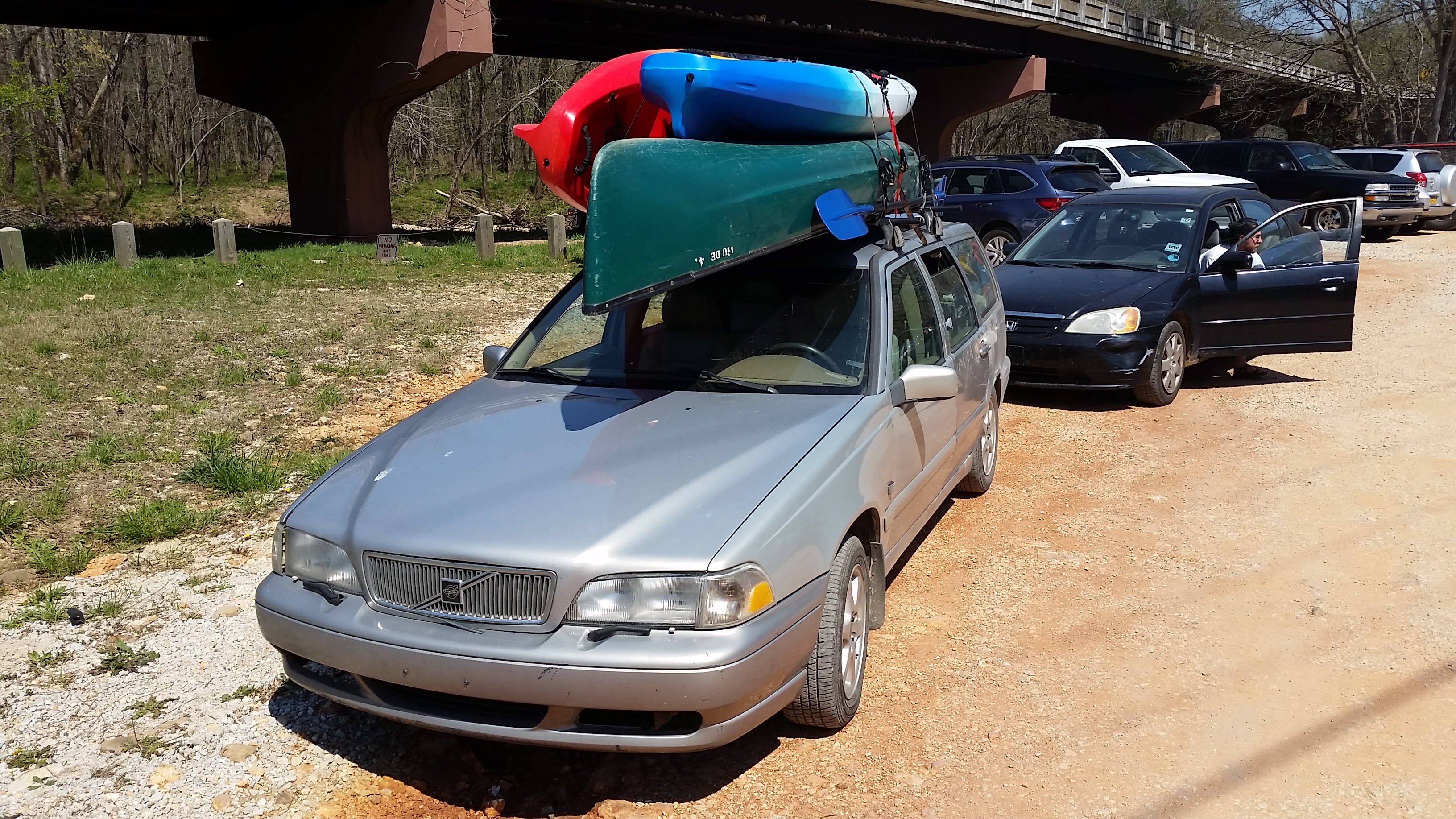

Here's a glory pic from weekend before last. 4 people, 3 boats, 2 dogs, 1 (soon to be dead-transmission) volvo driving in some steep a$$ hills in arkansas
it was this weekend that the cruise control stopped working oddly..
the next weekend was cruising down I-40 at about 73 when it dropped out of gear it seemed...hmmm. loped it down the road a few miles on the shoulder and had it towed home. Sad day for the silver bullet. Let me know what you guys think!
