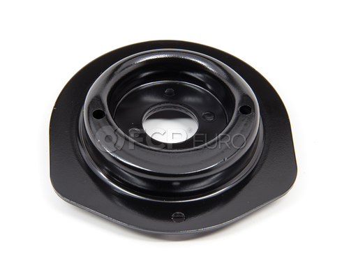

I'm thinking they replaced the spring seat but not the mount or possible your strut plat is bad (it's the one with gears in it at the top of your strut tower). Do you recall what it looked like? Btw, the spring seats are a known issue with these cars (well all Volvo's) and if you don't get a decent one they last no time.
This is your spring seat:

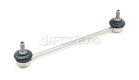

The movement makes me think it's the spring seat. The rattles could be a bad end link on that side.
