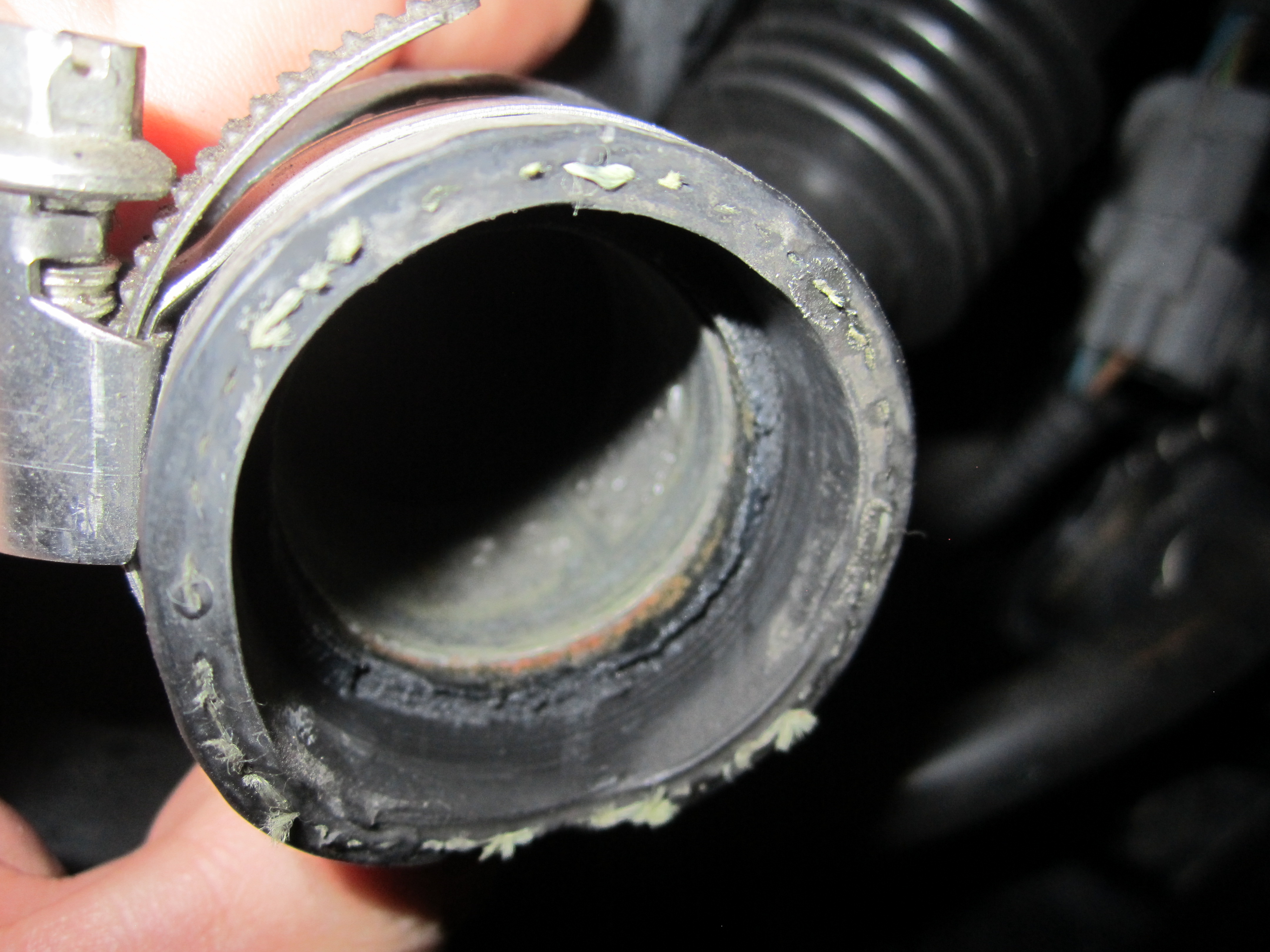

Price is good, but they don't ship to Canada. Only dealer that I have found that ships to Canada is Tasca and then there is FCP. That price included shipping and tax/handling/duties in US$ at $350 from FCP. Also discovered that Tasca has a core charge on the radiator. Core charge on a radiator?! Then when I checked it was $0.01?? Their price is $273 US, but their shipping rate makes it only $12 more to ship with FCP and they at least give a lifetime warranty. Thanks for the tip though! Whilst I don't like using non-OE parts, I think I will be using the Nissens, then I'll also buy the new clips, 'O' rings and top radiator hose and still be about half the price of the OE. I took the old hose off and it is fine and supple, but I don't know how old it is and it has memory marks from the Volvo pipe on the inside face.
Pictures below of the OE radiator. So much for my belief the metal upper hose outlet sleeve reduced the likely snapping of the upper outlet. The best part is that the metal sleeve had slid out and it snapped where it should have been!
Makes me now think the OE part may not be worth it after all!
Thanks for the help again!

Thanks for the photos Neil. I now understand what happened. Geesh....bugger that...what a mess.
