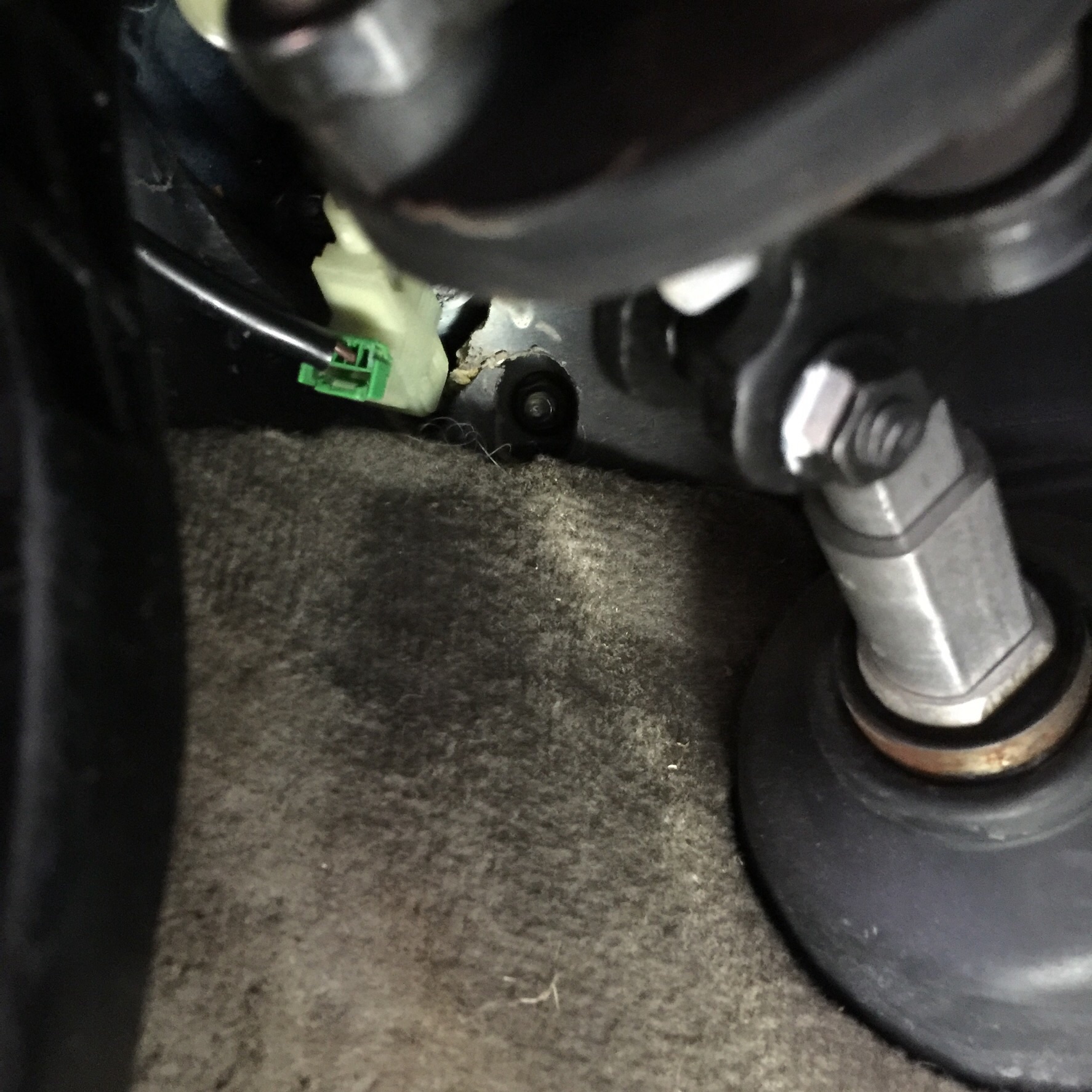

Went back to basics and check fitment.
Bingo!
I put the switch back onto the nub on the firewall that was visible - but I noticed the switch plunger action was at an angle and not as straight as a good engineer would have it. The correct nub is buried under the floor insulation and you need a flashlight to see it. Put switch back in right, cleared code, BINGO - solved.
I bet the old switch might still be good. $50 lesson in being more careful before disassembly.
The nub on the right won't work
