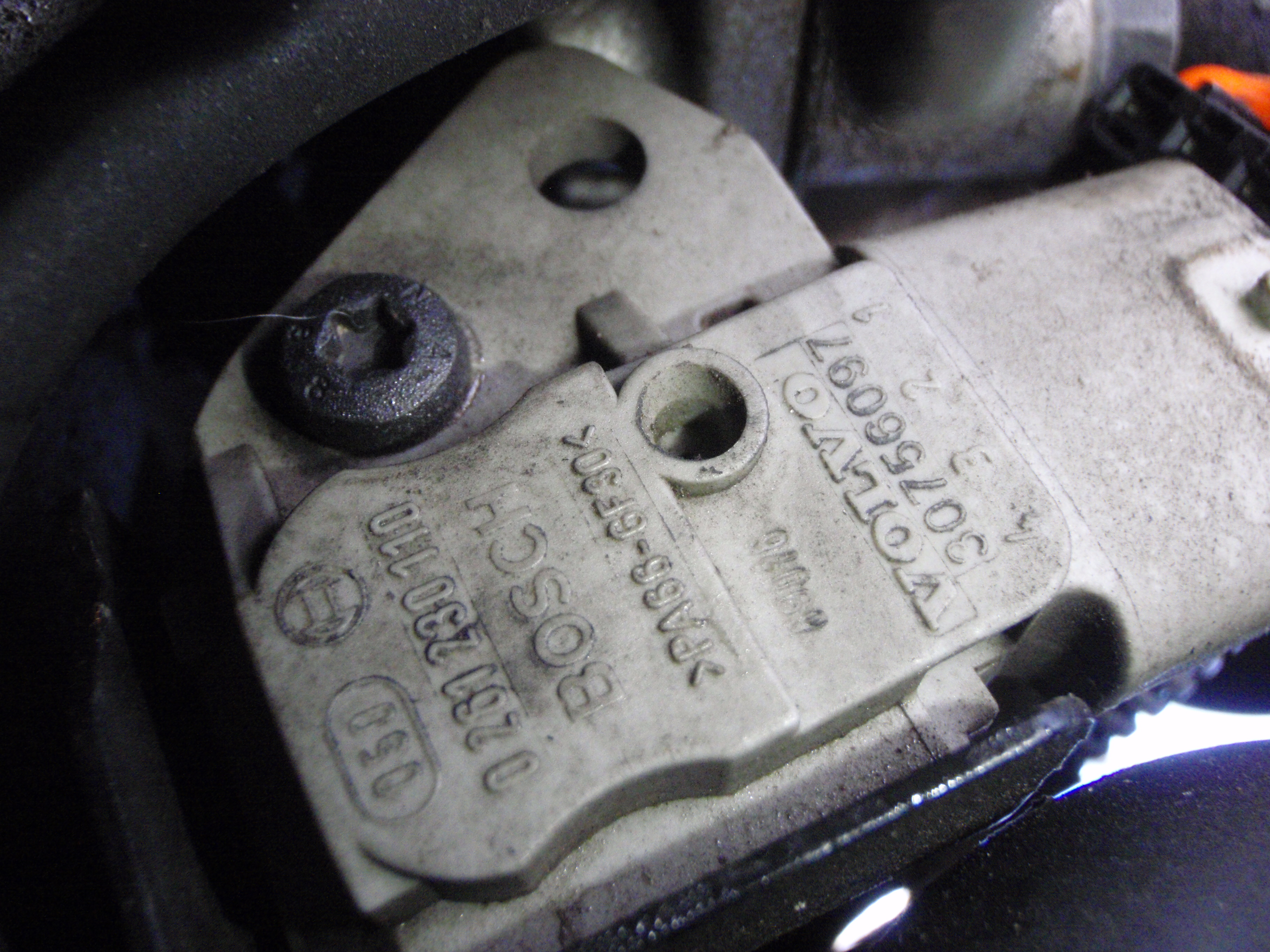

Right - so I had a look at my engine and the one in there is actually part number 0 261 230 110:
So I guess this will be a suitable part: http://www.buycarparts.co.uk/bosch/7003 ... 0woddMYFlA
Thanks again!
