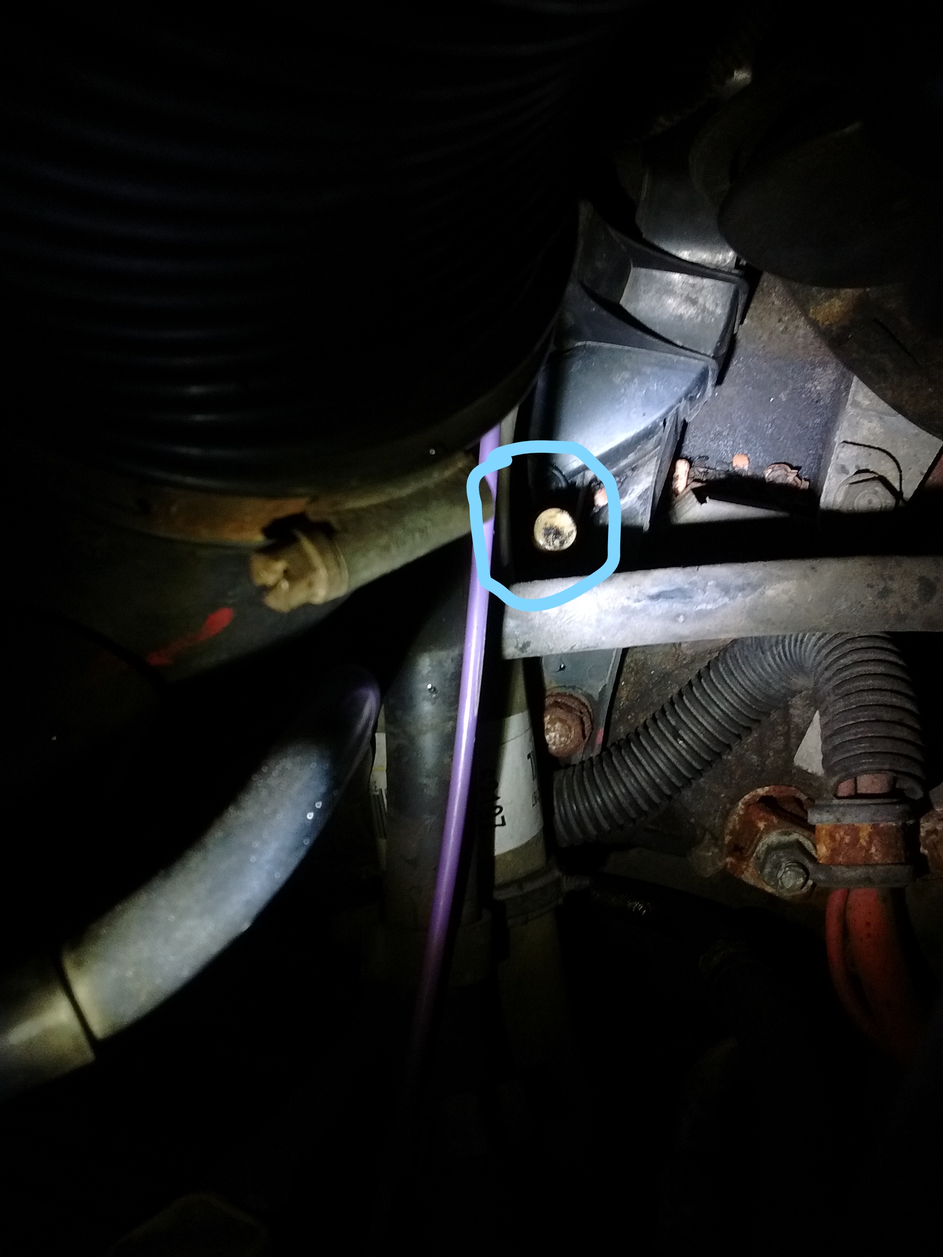

I went out to take a look at the car this evening, and sure enough, it started right up with no problems and ran fine. I let it heat up to temp, drove around the block, and had no misfire or hesitation/buckling issues. Furthermore, I was able to restart the car when hot with no issues either. MAF readings were about .55lb/s, coolant temp was 190.4F. But...

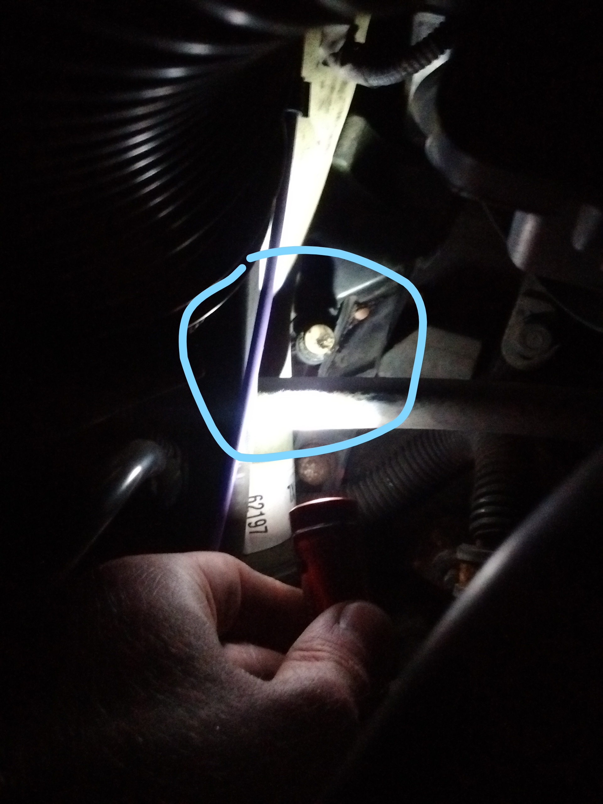

What I did notice is that after running the car for a few minutes, there was a loud, distinct ticking that could be heard with the hood open. I searched all over to try to find it, and the noise appears to be coming from the injector relay, right above the radiator fan on the right side (by right side, I mean from the viewpoint of looking at the car head-on). Presumably this ticking shouldn't be heard, correct?

PM me if pick-n-pull isn't easy for you - I could send you an injector relay from my 97 850 parts car if you pay postage.
I would peek under the distributor cap and make sure you are'n dealing with a blown rear cam seal, which would spray oil and/or moisture in there and cause misfires.

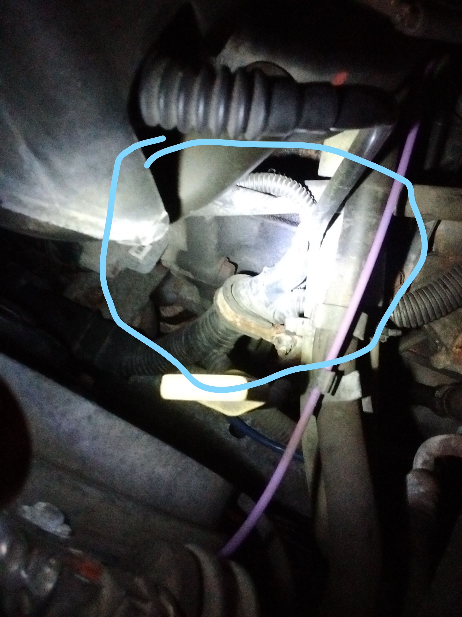

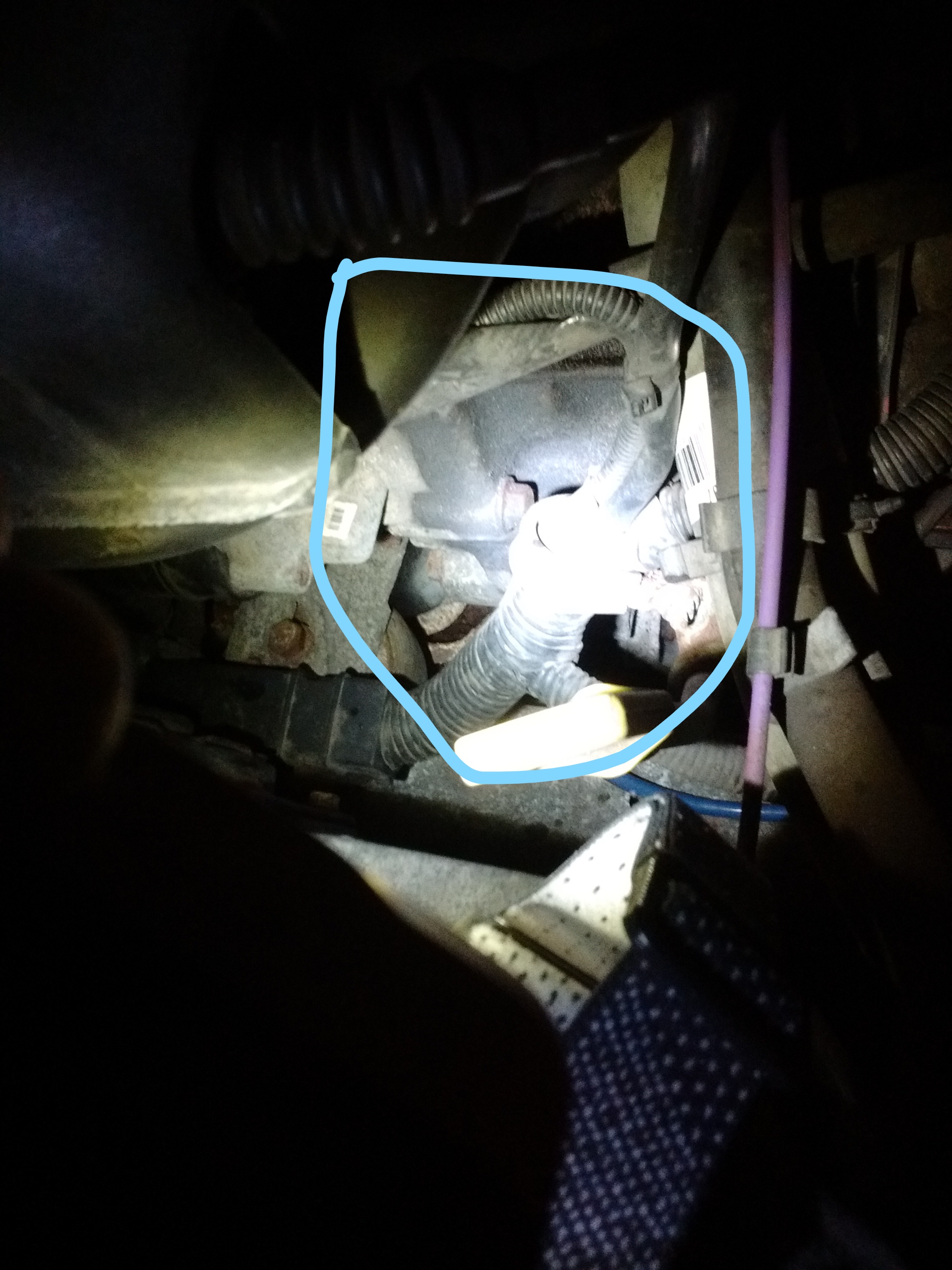

- After pulling the snorkel leading into the air box, I noticed that directly to the back and left of the box there's a white-topped hose that appears to be disconnected. Do anyone have an idea? The picture is attached. The white piece feels to be rubbery.
- I noticed that around the PCV flame trap area and below, there's clear markings of some kind of leak. Once the weather clears up, I'll remove the throttle cover, airbox, and distributor cap to take a look.

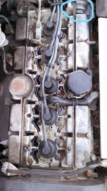

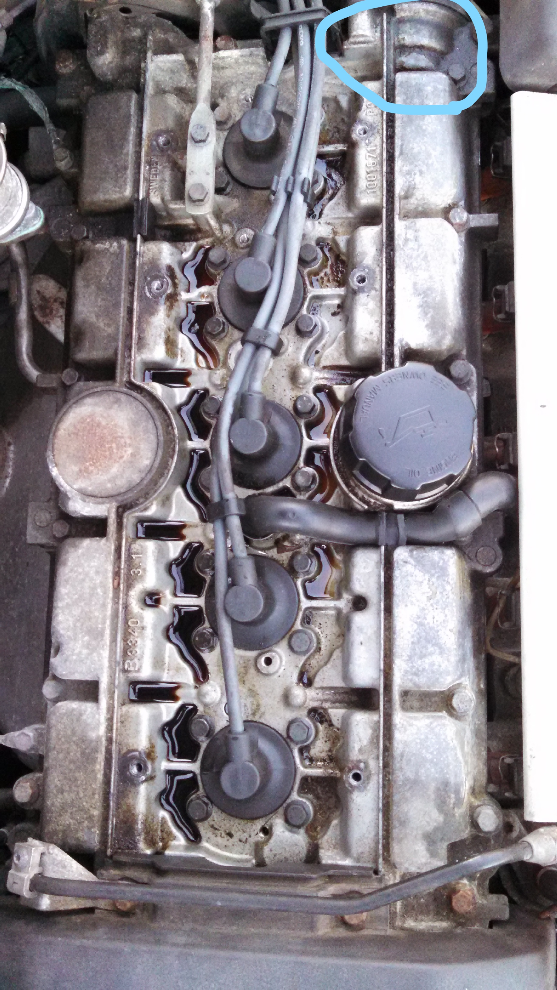

- Lastly, on the top of the engine, on the driver's side, the crevice that's circled (that's on old picture) always appears to be slightly wet. Any ideas?

All of that oil on top of the motor in your last photo isn't good. Start by replacing the oil cap gasket as it's probably hard-as-a-rock. Next pull the plug wires and look into the wells for signs of oil, which can cause the problems you describe. If you do find oil down there, you need to clean it up very well, and clean your spark plugs free of all signs of it. Else the film can bleed charge straight to ground (engine block).
If the rear camshaft seal behind the distributer is leaking, oil can foul the dist. cap leading to misfiring. It'll also make a mess downstream. Fortunately rear cam seals are easy to replace. Doing so will also give you the opportunity to inspect both the camshaft & crankshaft position sensor wiring for missing insulation. Any shorts can also lead to misfiring, poor running.

That photo is probably a year or two old - the oil has been since cleaned up (PCV and new cap seal). Its purpose was to note that corner that is mysteriously wet quite frequently.
I checked the plug cavities a couple weeks ago, and noticed that one of the plug wires, within the cavity, was clearly stained in dried up oil. Fortunately, the well itself was clear. I had noticed that several years ago but didn't think much of it. The cords are made by Bougicord, and I believe are dated 11/04 or 04/11.
Once the precipitation dies down I'll check the distributor-cap area and see what I can find. That oil stain on the lower side of the block is mysterious; my oil levels are fine. The randomness of the issue is the strange part. One day/minute the car is fine, and out of nowhere it starts to become problematic.
