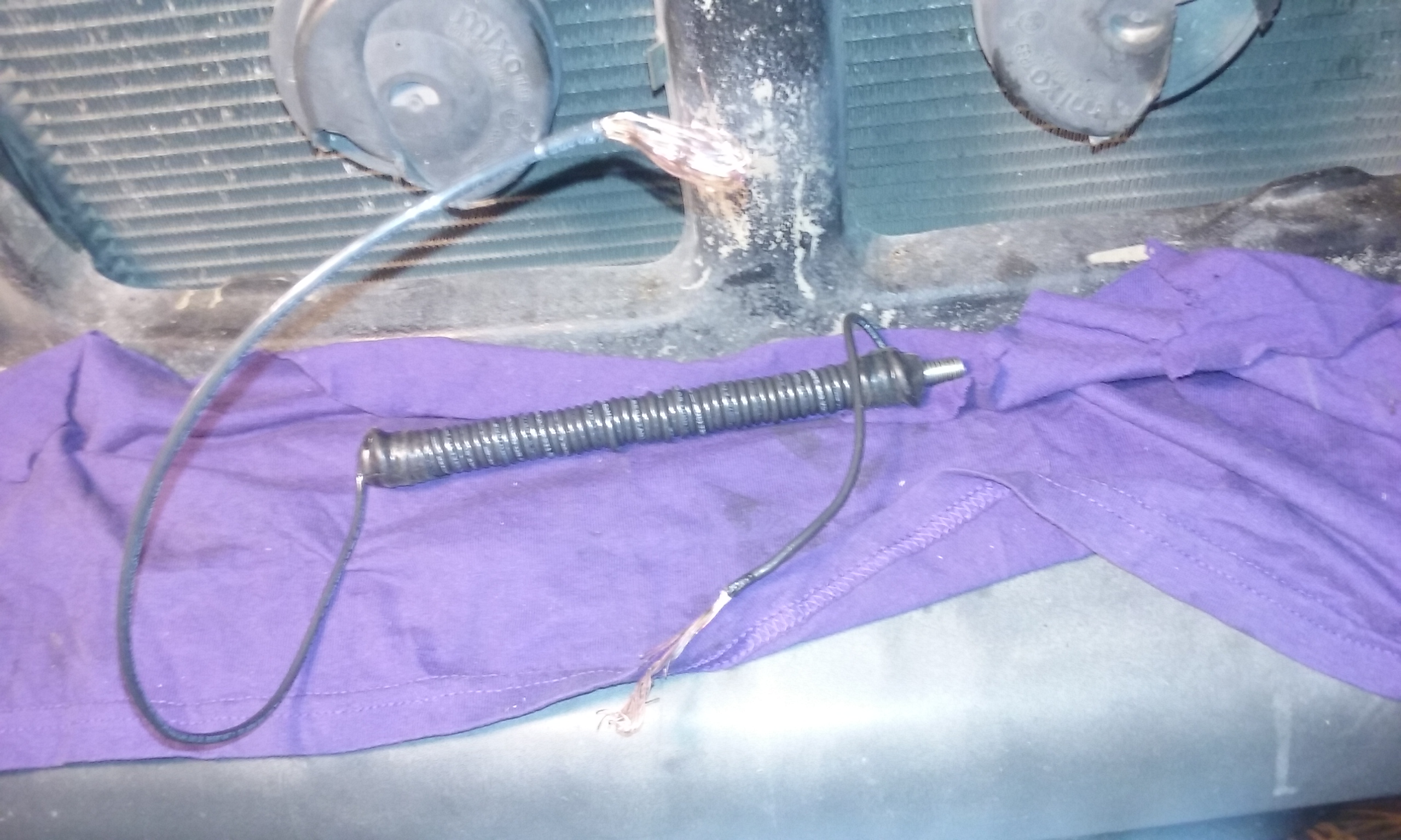

Hey hey, so after the magnet on a stick didn't work, I built a electro magnet and hooked it up to a car battery, strong enough to lift a 25lb dumbbell but no luck! I tried the magnet on a stick on last time, really pushing it in their until it got stuck. Right as I had given up (and completely given up on my car) I pulled as hard as I could to get the magnet out and out came the bolt with it! So now I'm going to work on the TB after I put the cams back in, this time with some engine assemble grease.

Nice work on the electromagnet, that is clever!
With the cams out, are you able to turn the crank around by hand, no problem?
