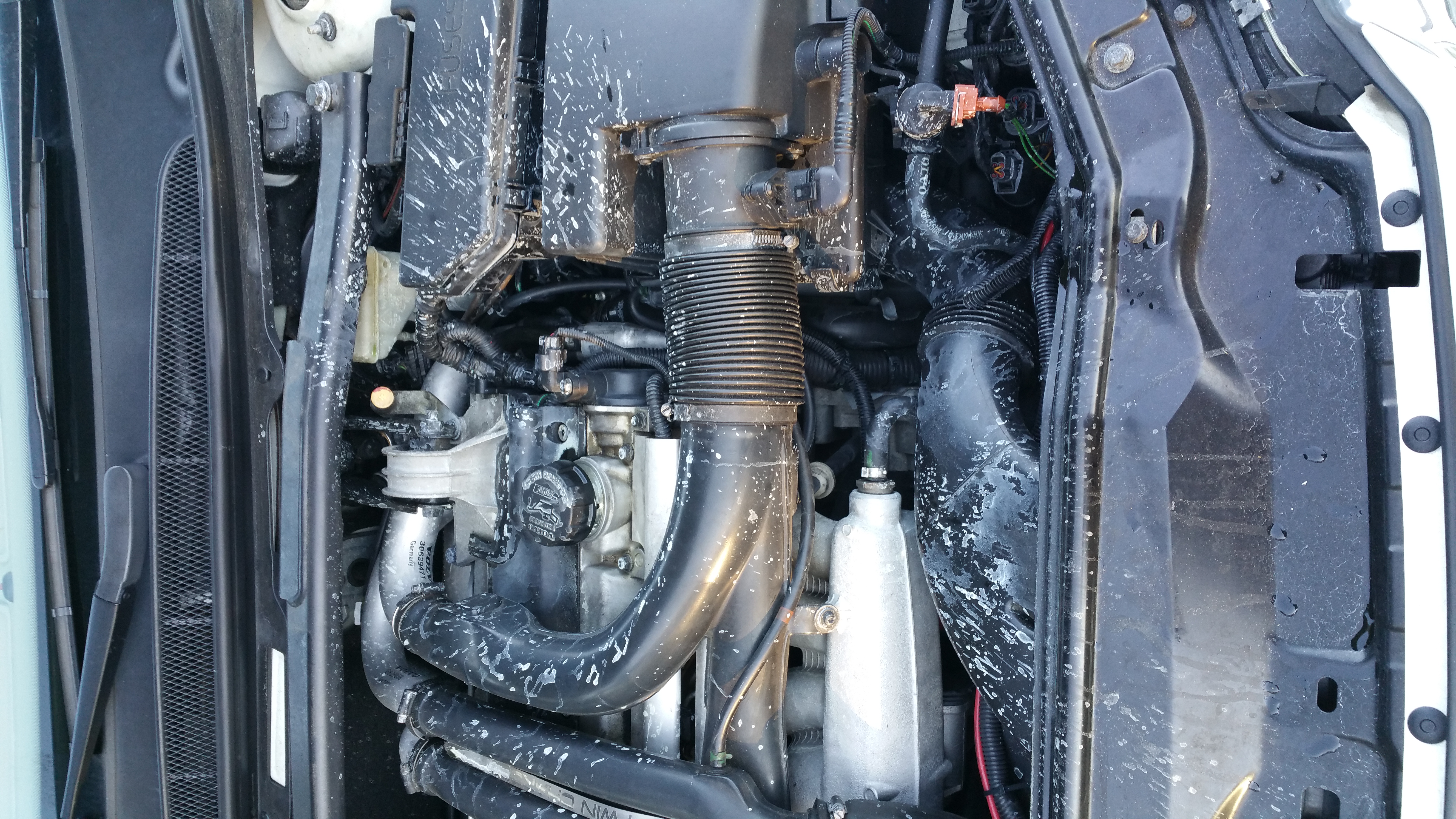

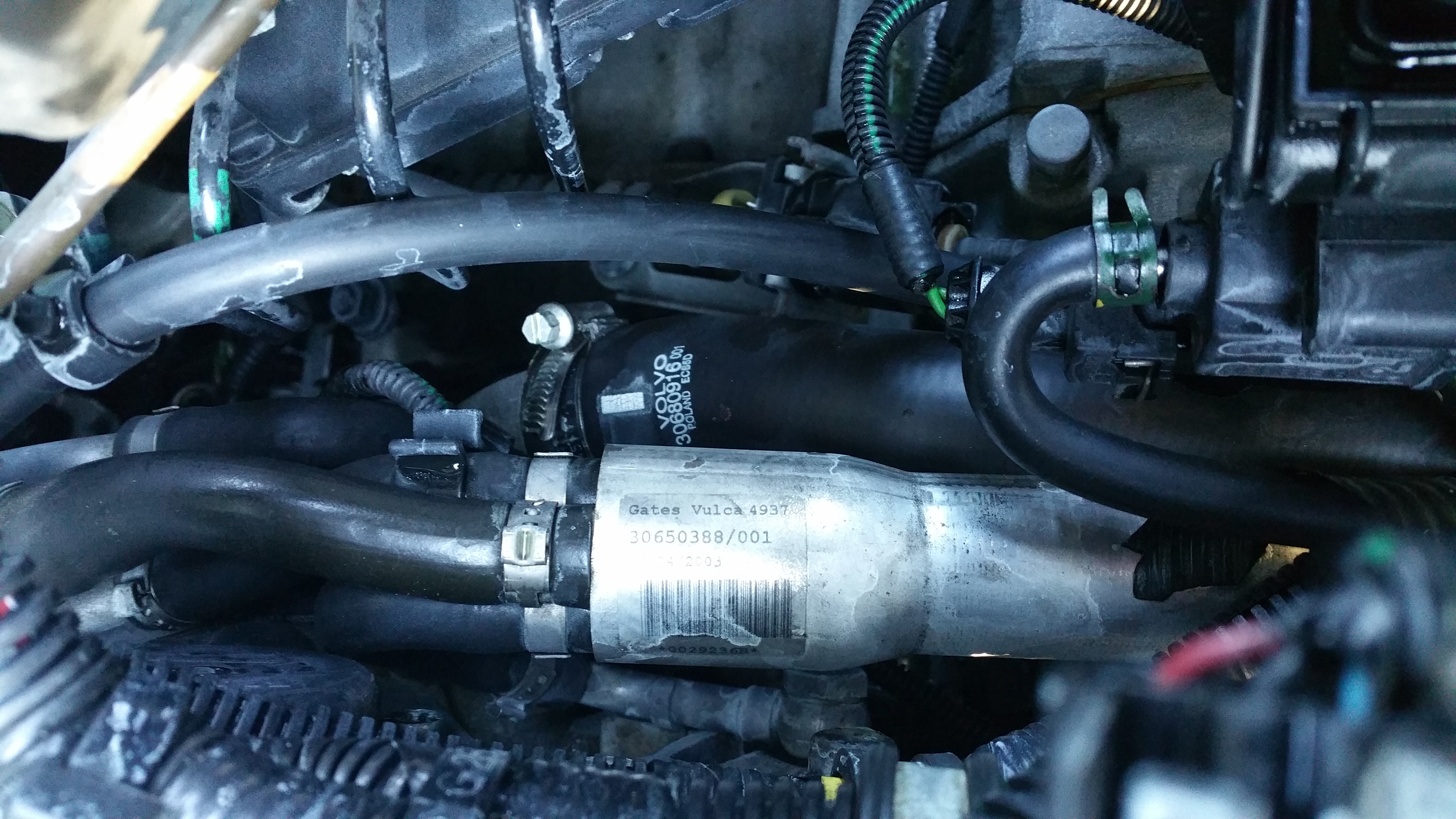

At 13.5 years and 134K my T6 finely left me on the side of the interstate for it's first breakdown. No not the transmission, but a heater hose size metal line directly below where the lower radiator hose connects at the back of the engine. Under the new hose in second picture marked Volvo with the big shiny hose clamp. Anybody had this happen? The dashboard readout said low coolant pull the car over SAFELY. Lol So it never had the chance to overheat thank God! Volvo had to put the word safely in there... June

It turned out the rubber heater hose which I think is the return hose split. Two new Volvo heater hoses, Volvo coolant, distilled water, and my car is just fine. It was hard to see where the rupture was as it was buried under the connection of the lower radiator hose until the lower radiator hose came off. Anyway I'm back enjoying my Volvo. June
