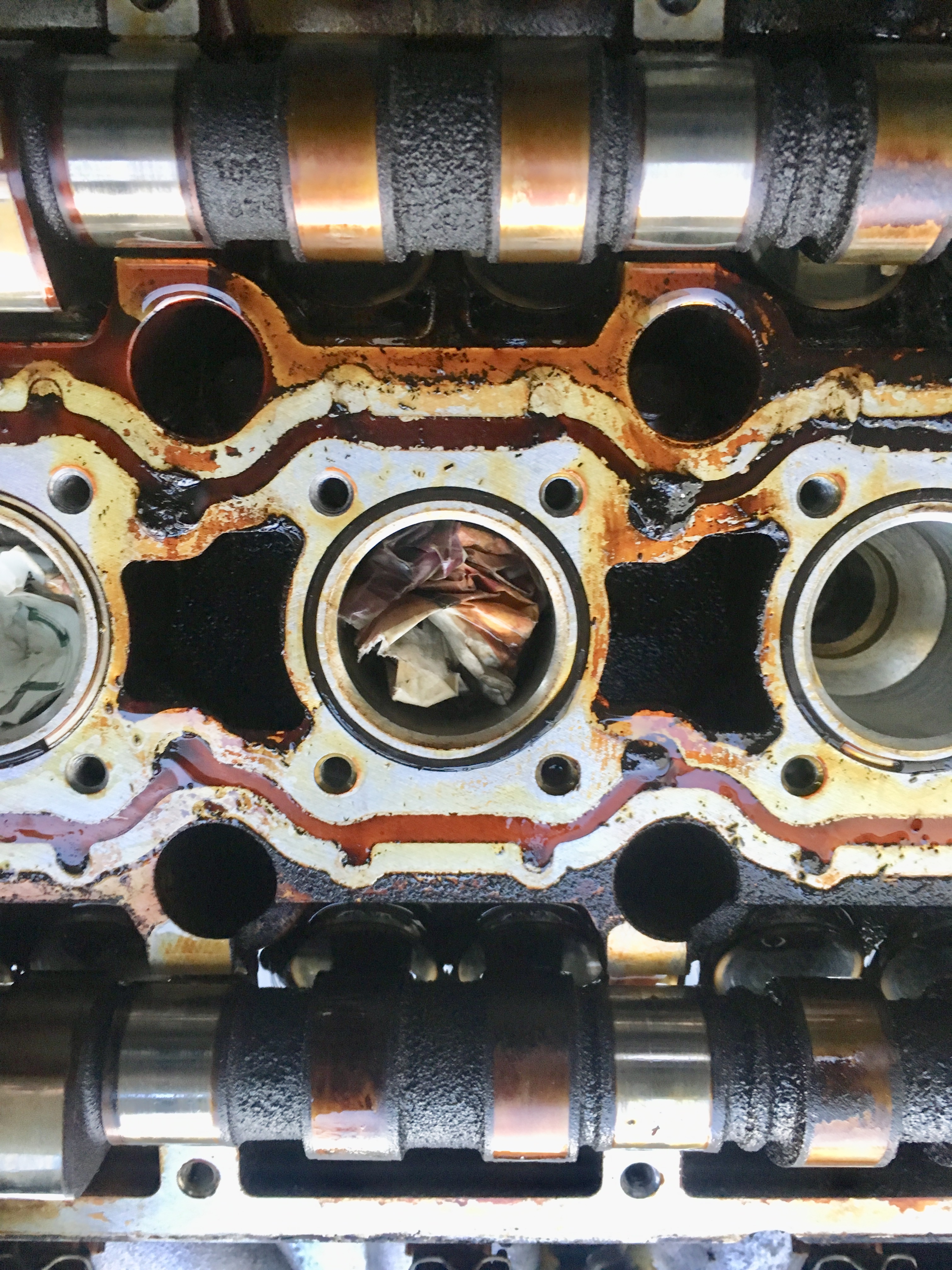

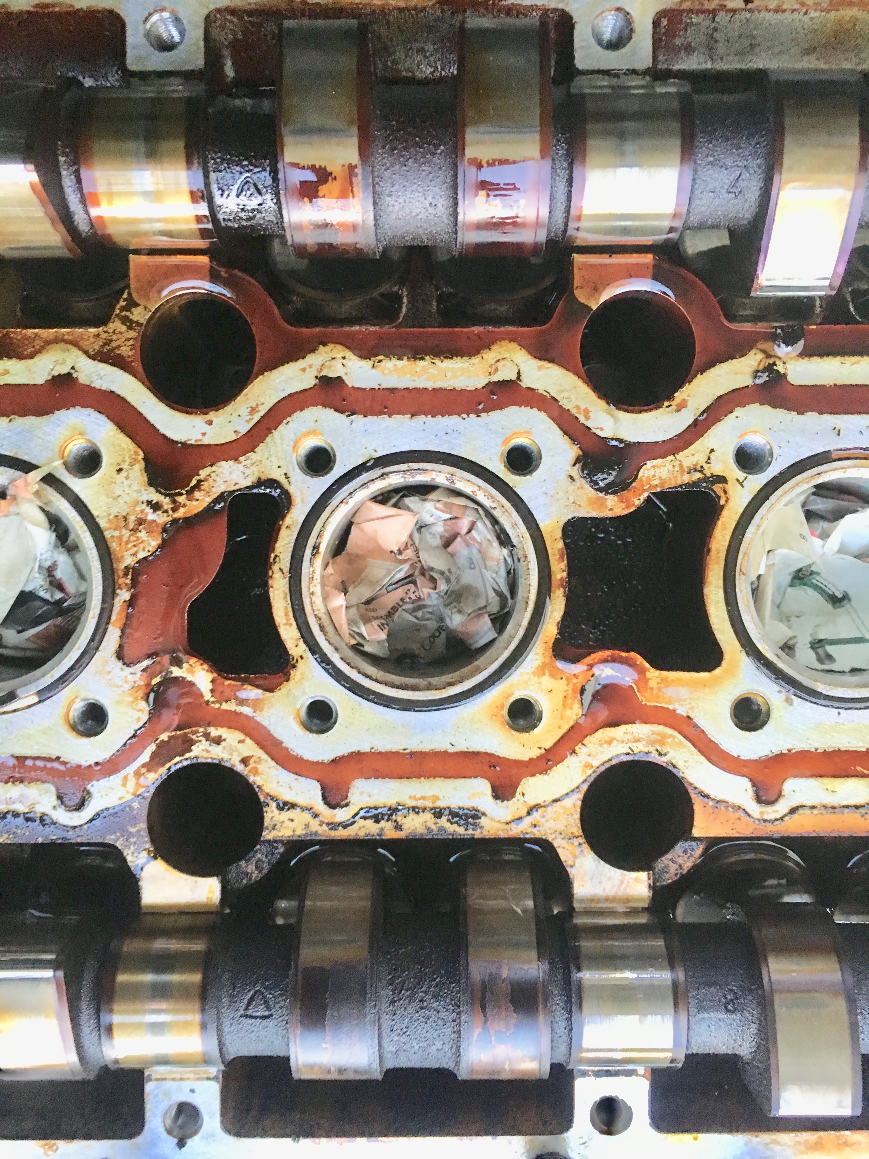

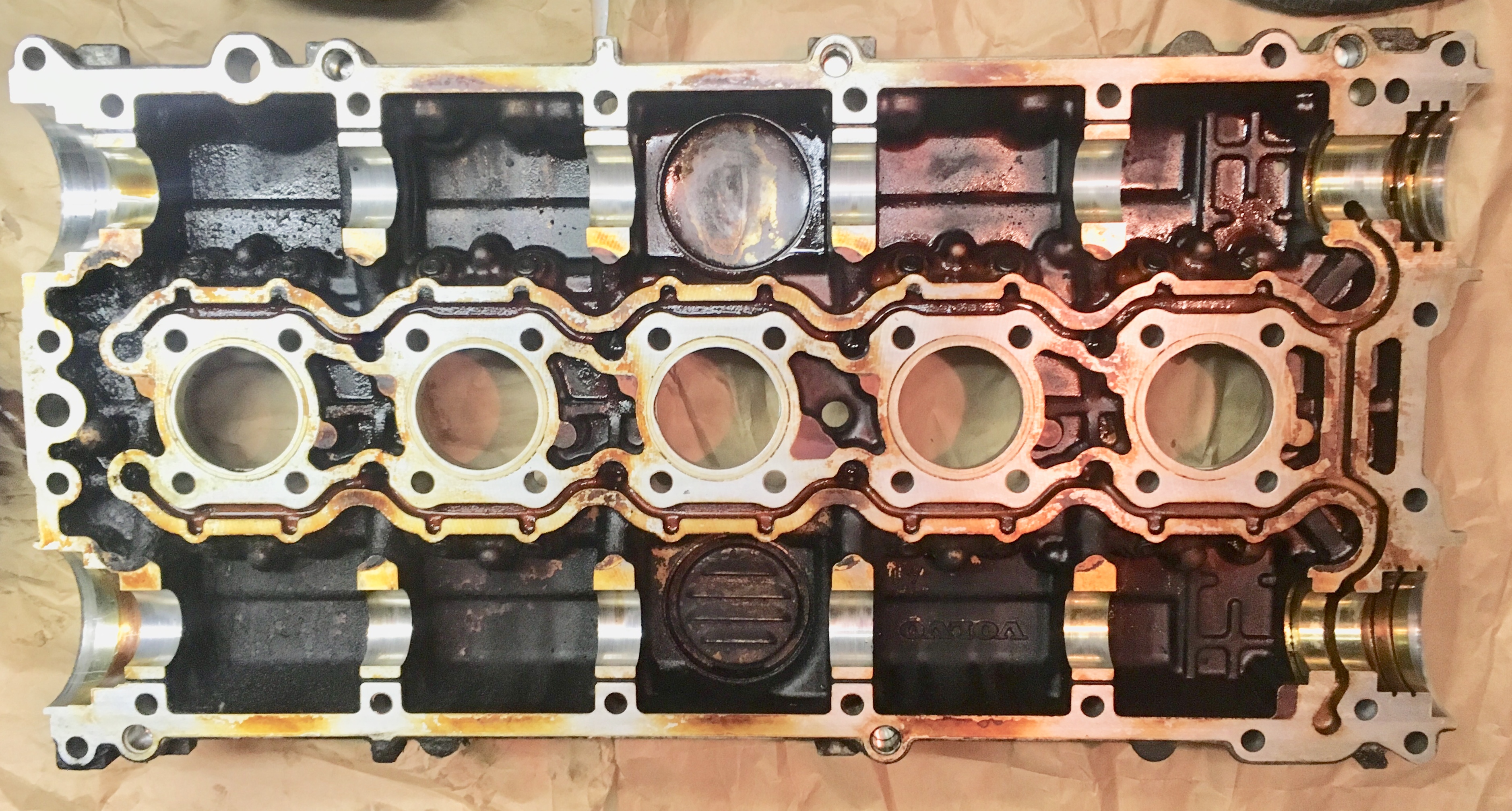

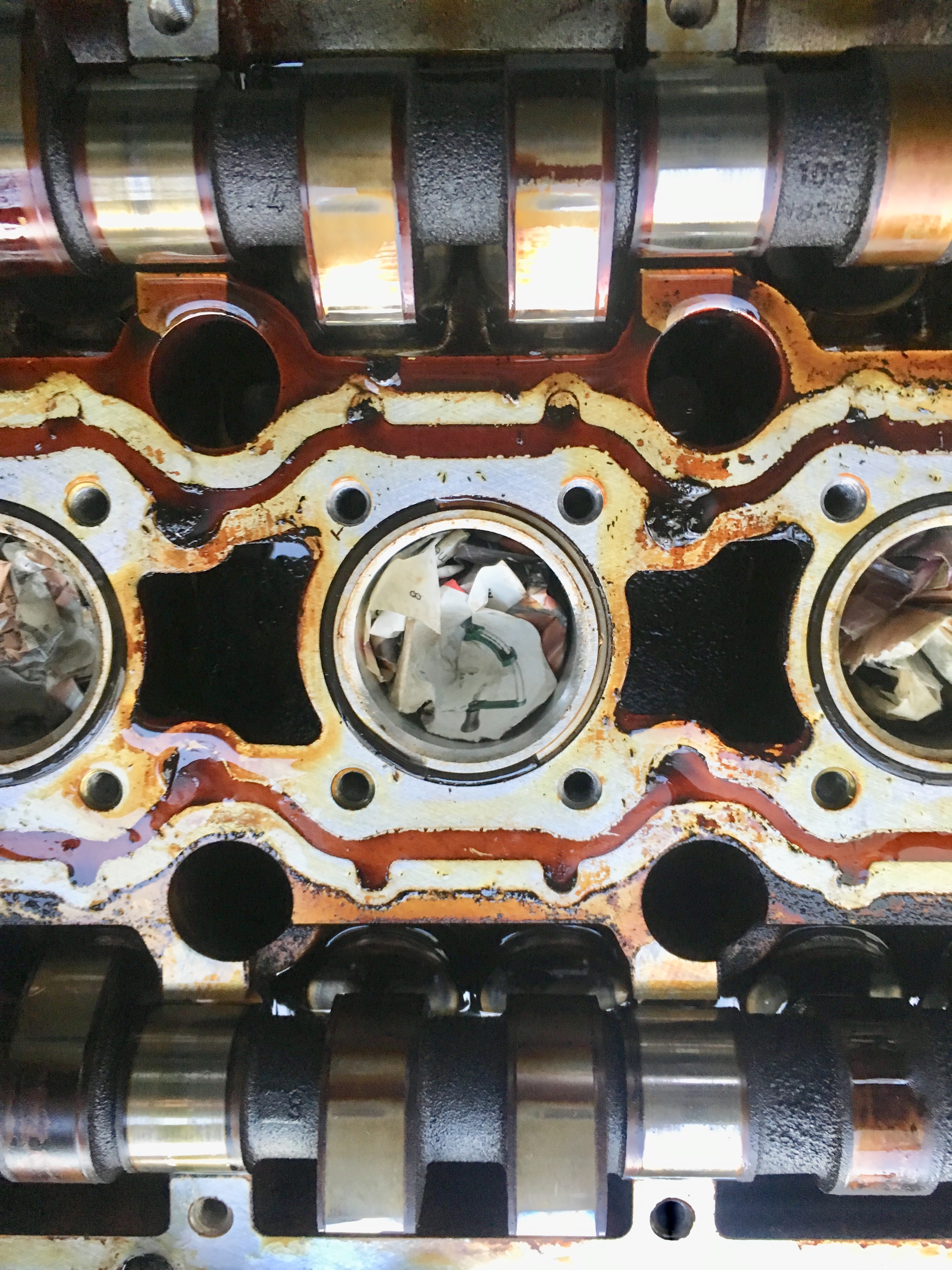

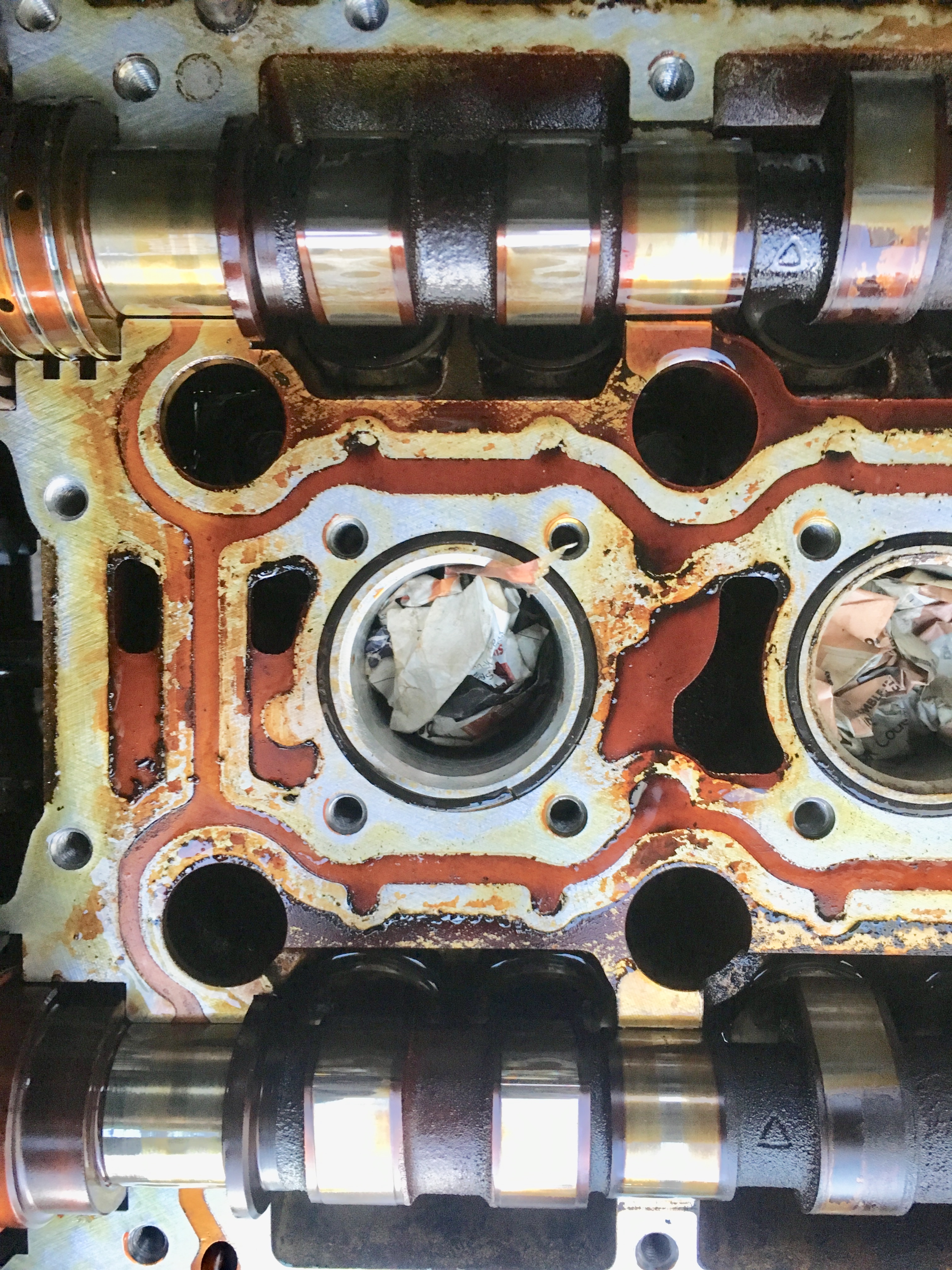

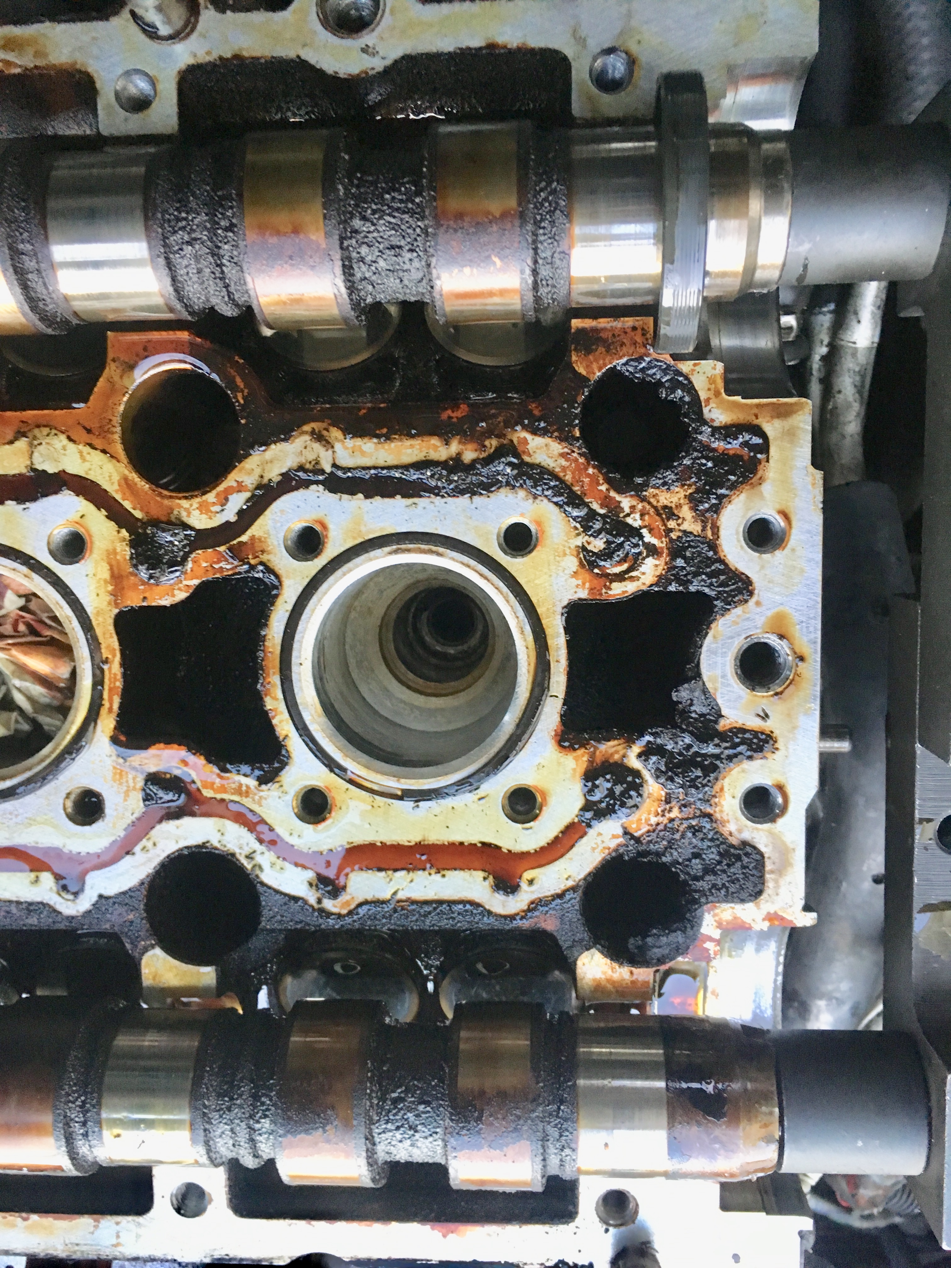

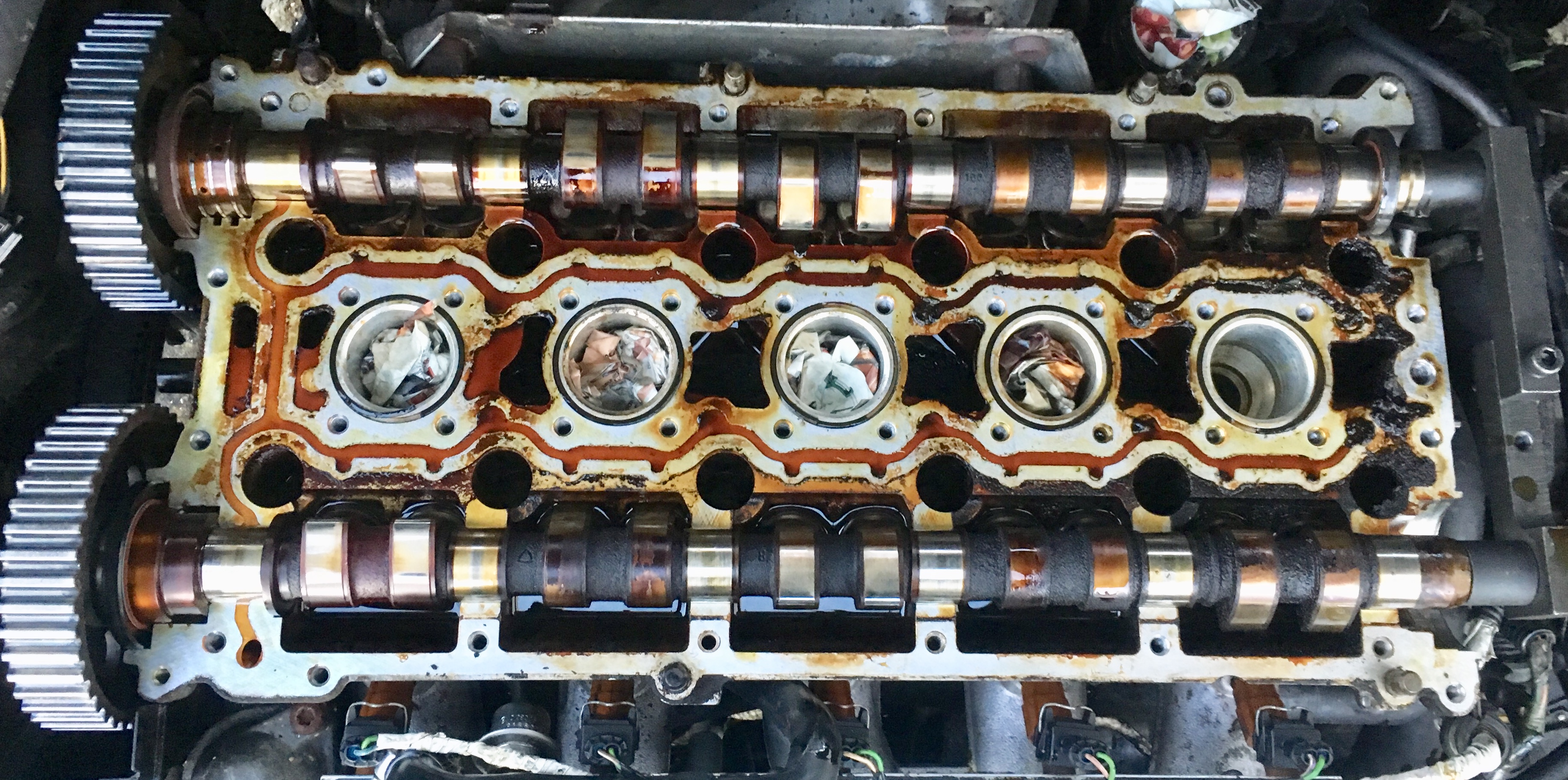

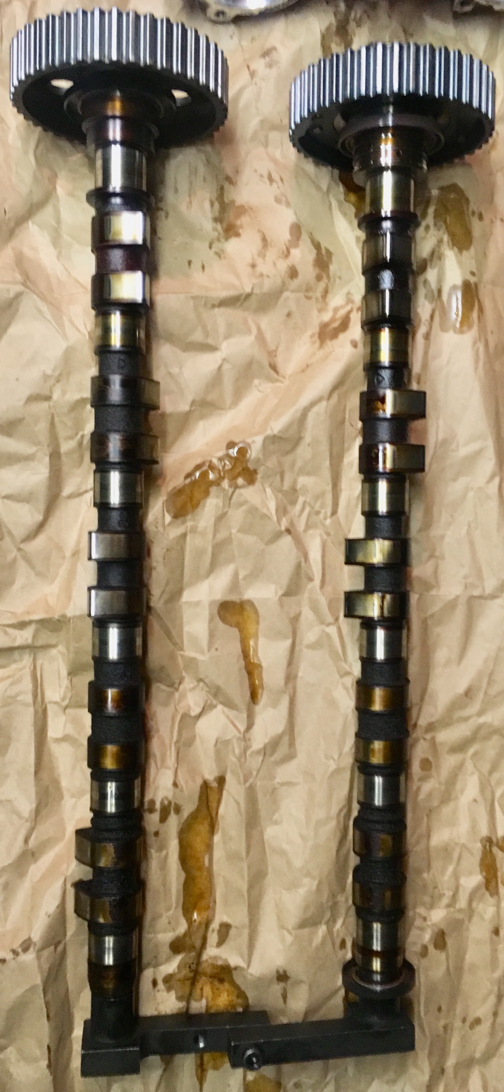

Alright, I pulled the cam cover off yesterday without too much trouble, and removed the camshafts. Since this is my first time looking inside this part of the engine, I took some photos of the parts involved and I was hoping that folks here could comment on their condition and if there are any visible issues.
The only other thing I have done is a quick surface wipe with shop towels - next up would be a complete cleaning to prepare for installation of a new liquid gasket, installation of new spark plug tube seals, and reassembly.
Aside from wanting to hear any comments on the photos, I did have a few observations/questions of my own:
1. I was under the impression that there would be visible residue from the chemical gasket after separating the cam cover from the cylinder head. Is that correct? If so, am I just not seeing it in these photos?
2. I thought that oil was supposed to drain back down to the oil pan when the engine has stopped, so I was surprised to see oil pooled up around the camshafts. Is this normal?
3. The sections of the camshafts between the lobes looks almost charred. Is this normal?
4. The area around cylinder number 5 is extremely black and cruddy. I am assuming this has something to do with the oil leak originating from around there?
Thanks for any comments or advice you have!

precopster
- Posts: 7543
- Joined: 21 Aug 2010, 00:20
- Year and Model: Lots
- Been thanked: 128 times
Great pics!! I see you got some cam holding tools. Do you also have the wing nut pressure tools?
The residue from the old chemical gasket are the dark orange lines you see; the anaerobic sealer dries to a very thin film.
Other than the obvious crud and carbon (quite a lot of it there indicating multiple missed oil changes and/or use of mineral engine oil throughout its life) which must be cleaned off with a chemical stripper and use of scrapers nothing is really out of the ordinary there. Most people prefer to use a plastic scraper to avoid damaging the surfaces. I'm not so patient and will use a steel blade very carefully on a very obtuse angle.
If you use a chemical gasket stripper you can use water pressure to clean off the upper half of the valve cover. Of course you'll need to dry it off quickly to avoid corrosion. Compressed air comes in handy here or a hair dryer.
With the lower half you'll need to be more careful of course. Whatever you knock down into the oil ports will mix with your clean oil so I would flush a couple of litres of cheap oil into the oil filler then drain that out. Some pipe cleaners would help knock that carbon down the oil ports. Don't worry about that crud blocking the oil filter as these oil ports lead straight down into the crankcase below the pistons.
I might even be tempted to pour some petrol down the oil filler and also into the head near the valve springs so it will help get all that crud out of the drain plug. Then use cheap oil to push the crud down to the crankcase. Just wait about 30 minutes for the petrol (or other solvent) to evaporate before refilling with good synthetic oil.
Of course you'll want to make certain that the 42 bolt holes are perfectly clean. Also Trial hand screwing in a M7 bolt into each of the 42 holes is essential to ensure they're not blocked or contain liquid. Also thoroughly clean and lightly oil each of the bolts with WD40 or similar before torquing them down.
The anaerobic sealer goes on as a really thin film. A small paint roller works well. Don't be too liberal with it as it may block the intricate oil ports in the head and starve the cams of oil.
