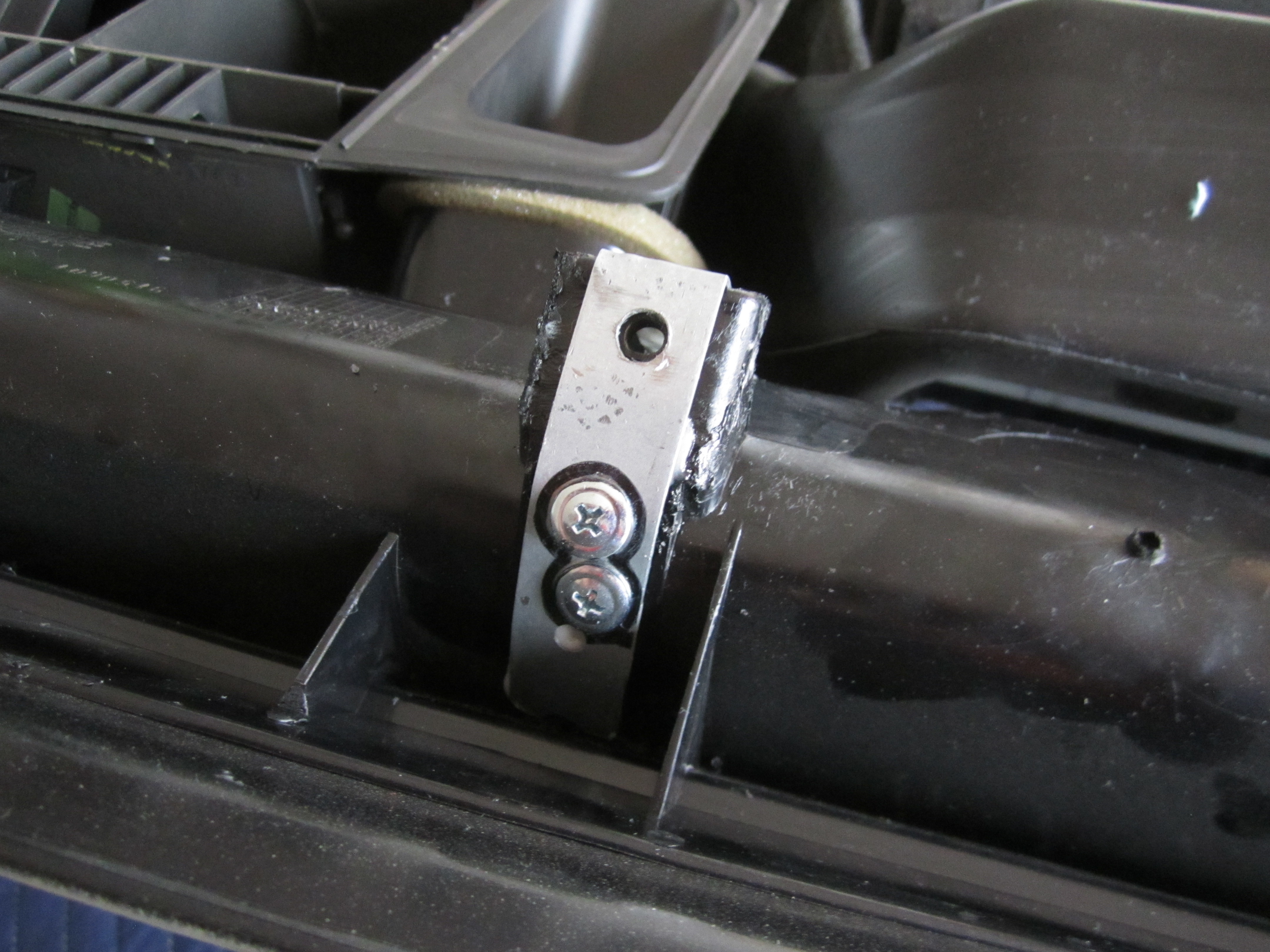

Some additional pictures from the repairs:
It took a while to make the brackets and to make sure they did not foul the mounting bolt holes. The plastic welder (bought from a company here called Princess Auto but maybe Harbor Freight or Eastwood may carry them?). was a really helpful tool. My repairs were not pretty but they were strong.

Pretty doesn't matter if you never see or hear it!

You are welcome. No in this case I didn't find anything problematic with the system for once. Much of the lost air to the windshield was going through the holes in the breaks in the air pipes caused by the broken mounts. Also previous to this I found the common fault of a broken plastic arm for the intake air flap behind the fan motor.
