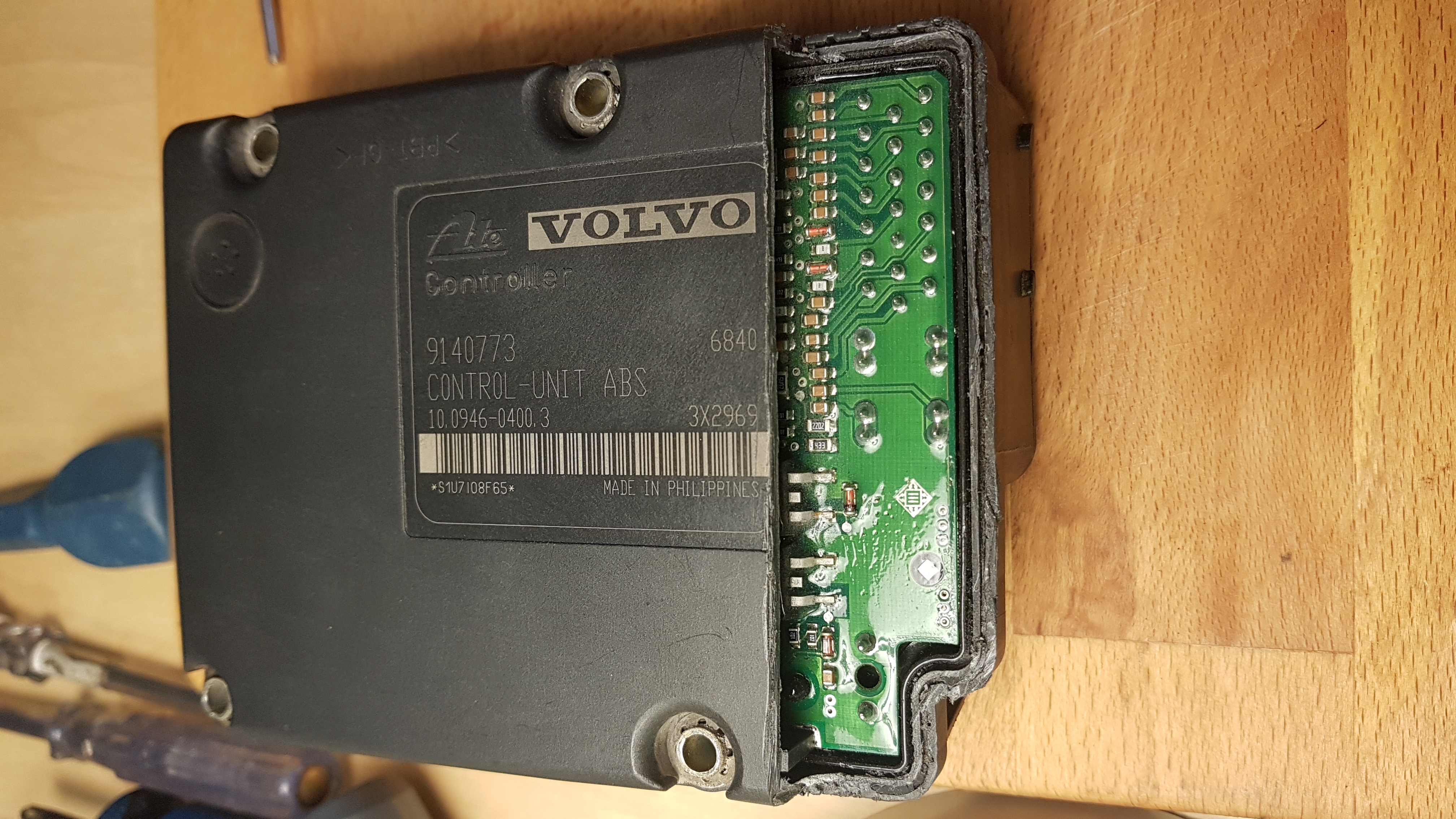

Hi.
I am a newly registered member, but already reading this website since april ,when I bought my p80 v70 2.5T from 1997.
Already finished the pcv projects few weeks ago, followed by Justin Blackburn instructions .
Now the abs module problem fixed and I would like to say a huge thank you for every member,who's sharing the informations all across this on this page!

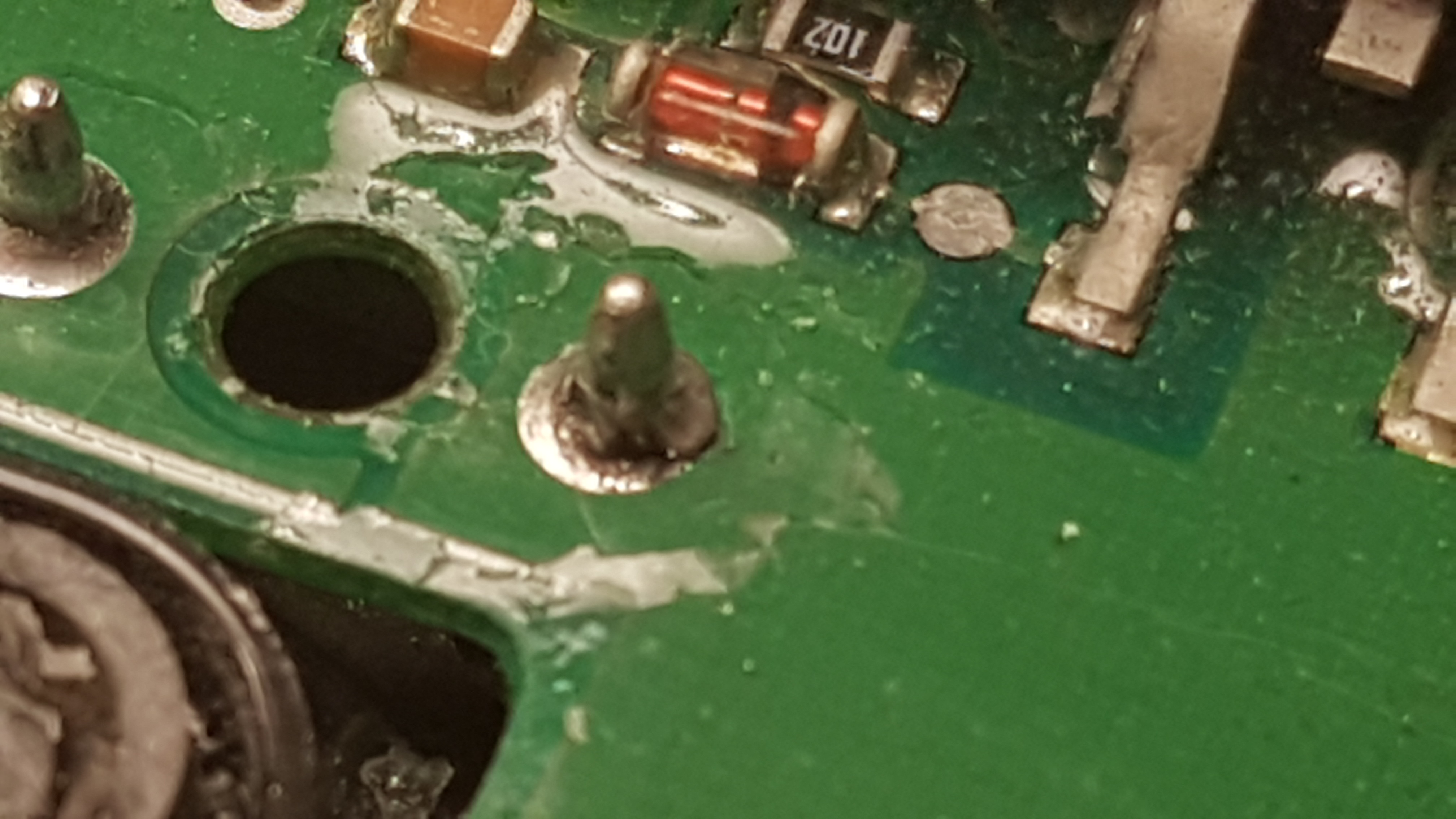

Great pictures of the solder cracks.

I soldered 4 pcs this side and the 2 main connectors other side. Not sealed properly of the case (only used gorilla tape all around) at the moment, because just waiting the next few days whats going on..coming back the fault or not .
