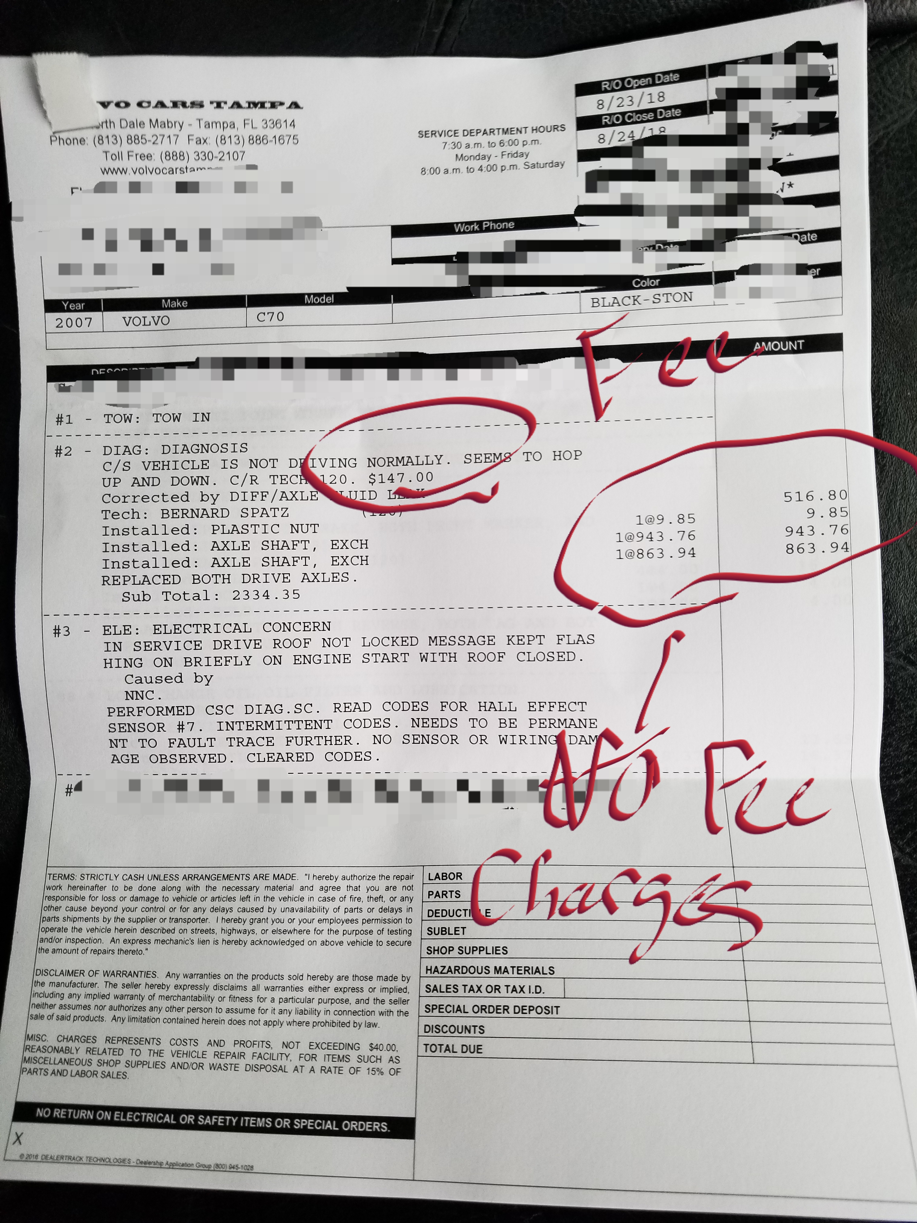

$1,300 plus diagnostic fee of $150? At a legitimate Volvo Dealer? Report the dealer to Volvo North America. The $150 fee should be dropped if the car is repaired, not added to the bill. No diagnostic fee is one of the Volvo guarantees to the customer. Note the recent repair ticket on my daughter's car. My dealer here in Jacksonville charges no fee I might add anytime I bring my S80 in.wizbang wrote: 29 Aug 2018, 23:00 I used a generic code reader. The only code (and check engine light) was PO113 pointing to a failed IAT in the MAF sensor. I haven't been able to find any information about diagnostics or any other viable information to repair this vehicle. The dealer told me the ETM and MAF were bad. They didn't provide any additional info and kept all diagnostic data when I told them I'd not have it repaired at a cost of $1300 plus the diagnostic fee of $150. This ETM only has 10k miles on it. That ETM was purchased by a retired service tech and installed for my mother only to find that the dealer had to program it. She has passed and I can't find any paperwork on the repair. If I hadn't invested so much money in this car it would be at the junkyard. Since my mother purchased it new I'm aware of the following on a 80k miles vehicle. Two sets of front struts, front calipers, front brake hoses, tie rods, alternator, radiator and hoses, sunroof (exploded for no reason while parked in garage), timing belt kit (tensioner grenaded taking out everything associated), water pump (while I was replacing the timing belt kit) and two ETMs. That what I know of but there are probably other things my mother never mentioned. This POS is a really nice ride when it's running. It makes all of my Land Rovers look like a Honda in reliability comparison. I'm sending the ETM to Xemodex for a rebuild since they'll warranty it for life which is something the dealer snickered about. I also ordered a MAF from IPD.
Also you listed repair your mother did over the car's life, but what have you spent all this money on repairs replacing? Ie what has recently been breaking, it might be pertinent to what's going on currently. Truly nothing your mother replaced is abnormal for any brand car during a 17 year period. Struts, breaking components definitely are wear items, the ETM on early models is a known issue and resolved by replacing with a updated design that superseded the original design. June
Added a photo of a service mailing from a Volvo dealer I had in a pile of mail laying around. Notice what I have circled. June

I will be contacting Volvo about the diagnostic charge too, thanks.
