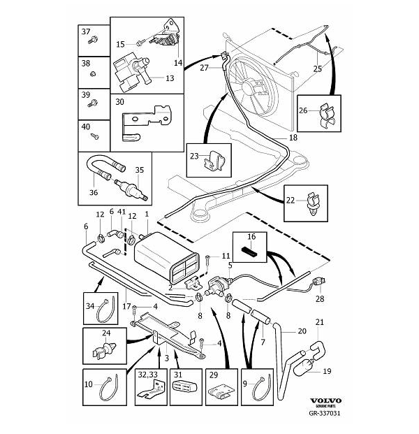

Pump is number 5
Shutoff valve number 35 - it looks like it lives left and forward of the carbon canister on your 2002 XC
You won't be out of the Swedish forest until your EVAP cycle shows READY and no CEL but a 2002 is much better than the P80 in robustness in the EVAP cycle.

I have seen this diagram,,its close but not the same. In the location just behind the canister (item #5) I have the Vapor leak detection pump. It is larger than the vent valve or the purge valve. If you follow the diagram it shows #5 connected to #19. I believe 19 is the vent filter mounted on the fill tube. My set up the test pump is in that location and as best I can tell the hoses are set up as shown.
You might also note that this diagram dose not show a test pump.
Were I am going with this is I think the test pump also serves as the vent valve. If you look up the parts for this system it will list all three components but I have yet to see a system diagram that utilizes all three.
It would explain why I can't find the vent valve,,,its not there.
