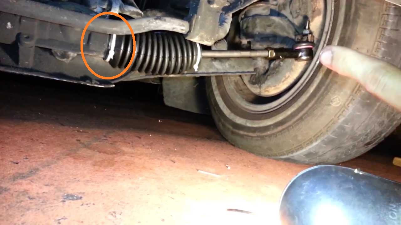

If all these check fine, then turn the wheels furn turn and look from the side of the car at the boots that go inside the rack, look near the area in the picture, may also squeeze a little if you can reach by hand, if the rack is leaking on either side these boots will fill with fluid - however it may not always show because they are 'sealed' by the clamps.
