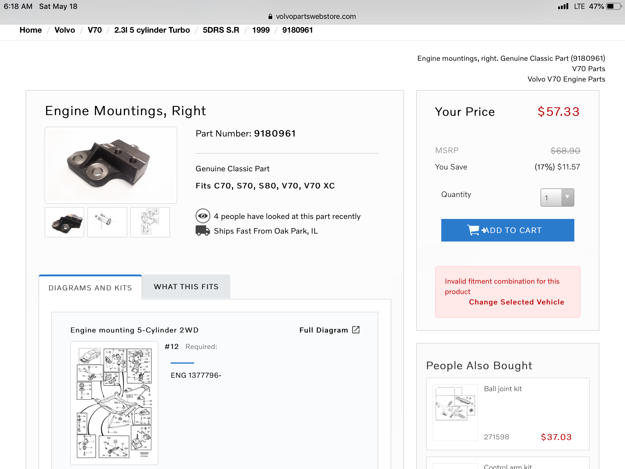

Best to use part numbers to describe these, an “ MVS BEST PRACTICE” (tm)
Volvo uses car reference to locate engine mounts rather than engine reference, so the mount near the passenger side under the crank pulley is the “ right mount”
See 9180961
