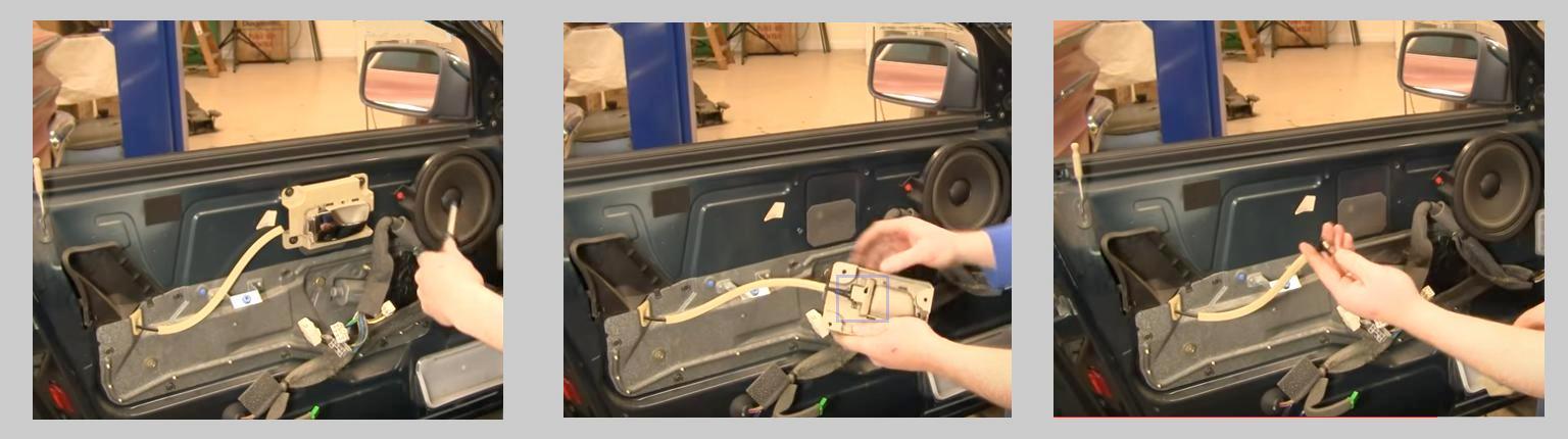

Hello again,
Here are three photos.
The one on the far left shows the mechanism before it is removed from the door. You cant see the part in question until that whole piece is removed as shown in the center photo.
The center one has a light blue rectangle drawn around the area in question.
The one on the far right shows the little thing that pops out because something is missing from what holds it in place. The little end is right between his two fingers.
