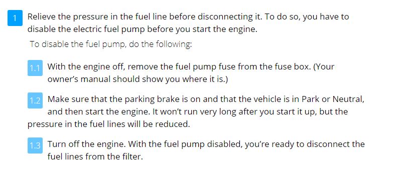

is this a necessary step on a volvo 2004 xc70 (image attached) ?
i want to replace it myself but wondering how much fuel am i expecting to see coming out the hose once i unplug the old filter...
should i do it outside of my garage?

Relieving the pressure is advisable. You will probably still spill fuel but it will be less. Working in a well-ventilated area is a good idea too, as the benzene in the fuel is carcinogenic. You want to inhale it or have it on your skin as little as possible. For that same reason, wear gloves.

This procedure is recommended in VIDA when replacing the fuel filter. Here's Volvo's specific wording which is very slightly different from the above, in that they say to start the engine before removing the fuse:
Start the engine.
Remove the fuel pump fuse. Placement may vary between engine types and model year. See the Owner's manual or wiring diagram.
The engine will stop after approx. 20 seconds.
Turn over the engine 3-5 seconds.
Switch off the ignition.
Replace the fuse.
