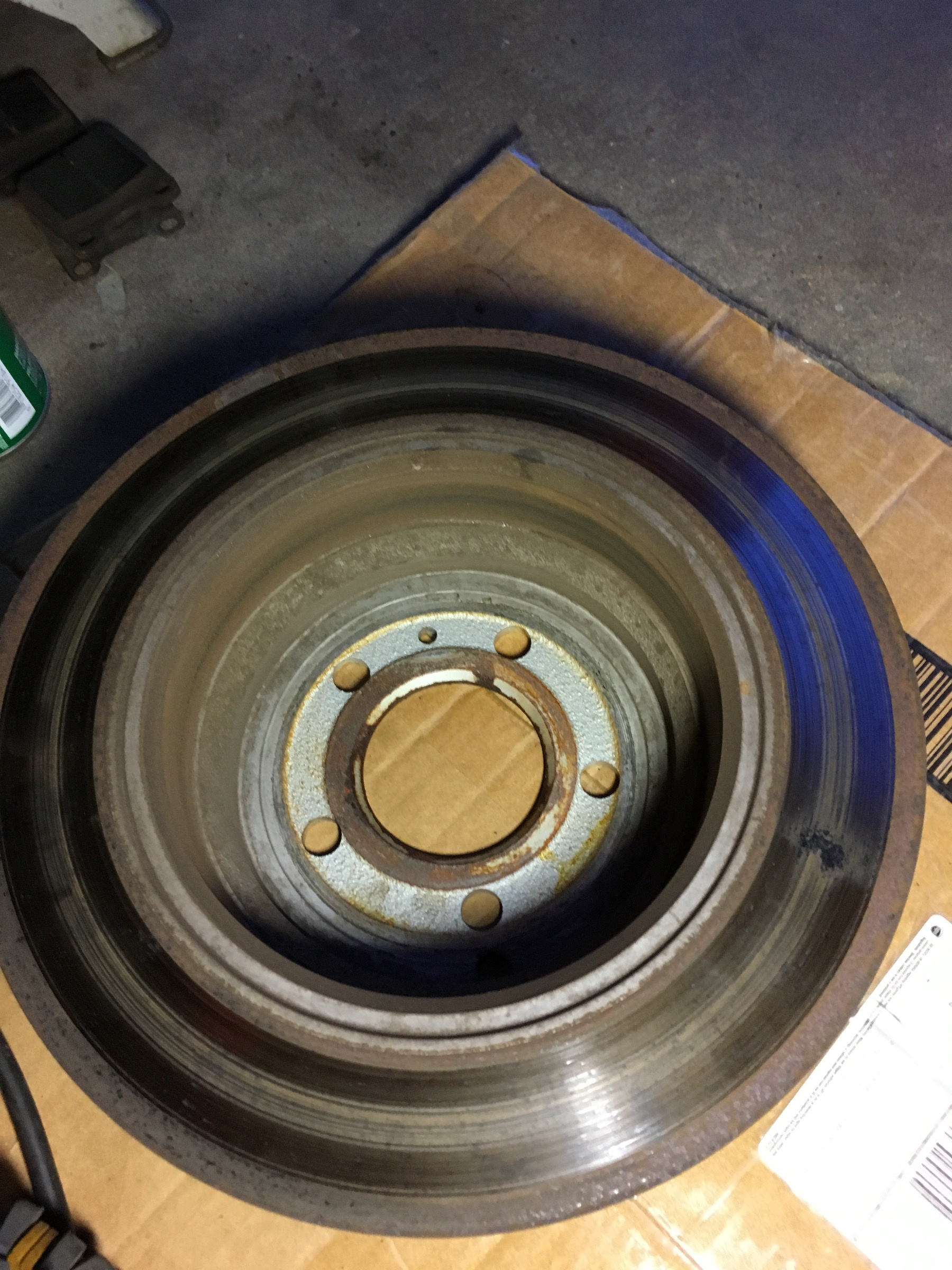

Some pics from last night....
Pad contact on outside
Then there's a funny spot of the inside face. Could it be where the pad sat while parked outside over the winter? And now maybe it's trying to scrape off this rough spot? That doesn't explain why the outer pad isn't pressing again the rotor.

OK, the scraping is there without the pads and caliper. There's also a single wear area inside the drum part of the rotor.

I loosened the parking brake adjuster all the way, the handle has no tension at all on it, pulls straight up. Put the rotor back on and it's still scraping on rotation. One spot per rotation. There's at least a 1/4" of parking brake pad left, they don't seem worn out. Are the springs not pulling the shoes away from the drum surface?

That spot on the rotor looks very much to me like what I got on a car with very cheap Chinese rotors some years ago. The problem was with the steel that the rotor were made of not being "pure" and uniform all the way through. The results were hard spots that did not wear down uniformly with the rest of the rotor. Aside fro making a noise, they were also making a groove in the pads.
I am guessing that this is not what's causing your noise, but you could try swapping rotors side to side...

The insides of your drums for the parking brakes look really rusty. If I have a car with drums like that I uses a rotary wire brush on a drill and clean all the rust off first and then rub the faces of the drums with a fine emery paper to roughen the surface a little for better grip.
