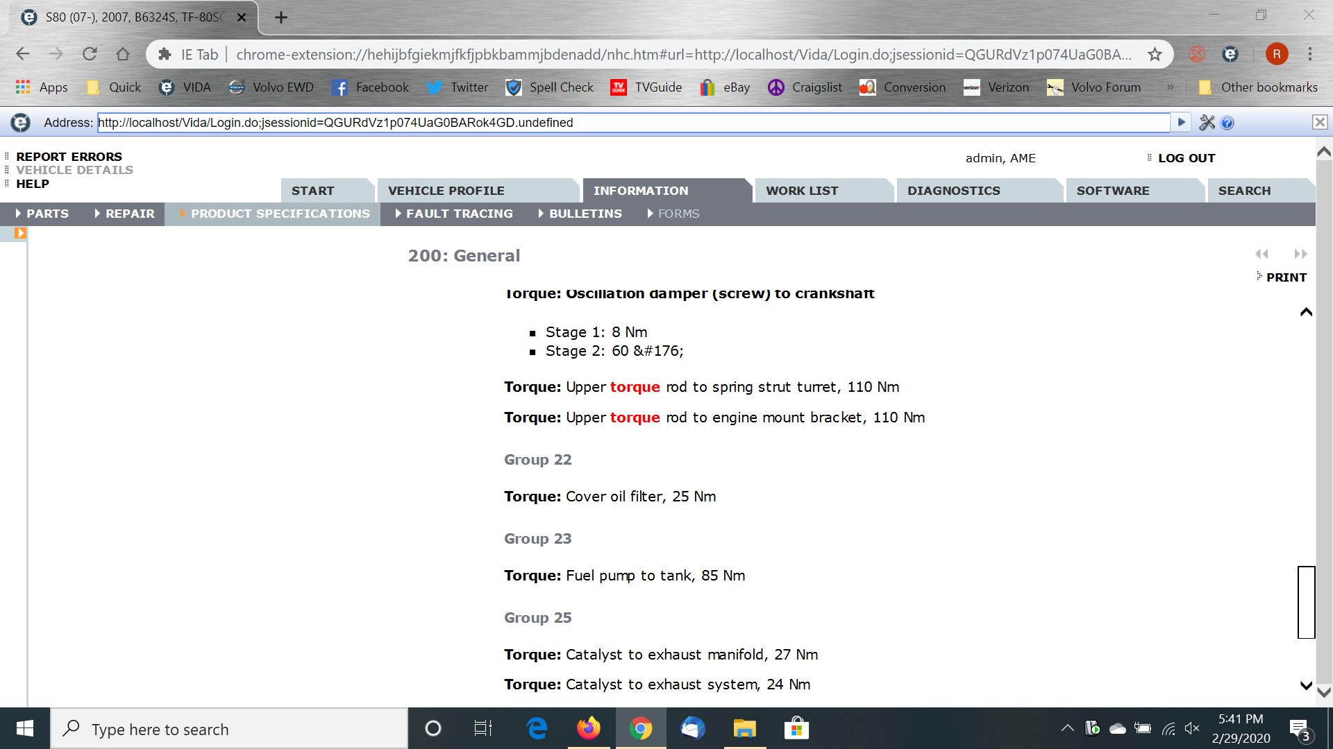

Moving the coolant overflow tank to get to the Upper Torque Rod is by the book. Bolt torque is 110 Nm (81 ft-lb).
