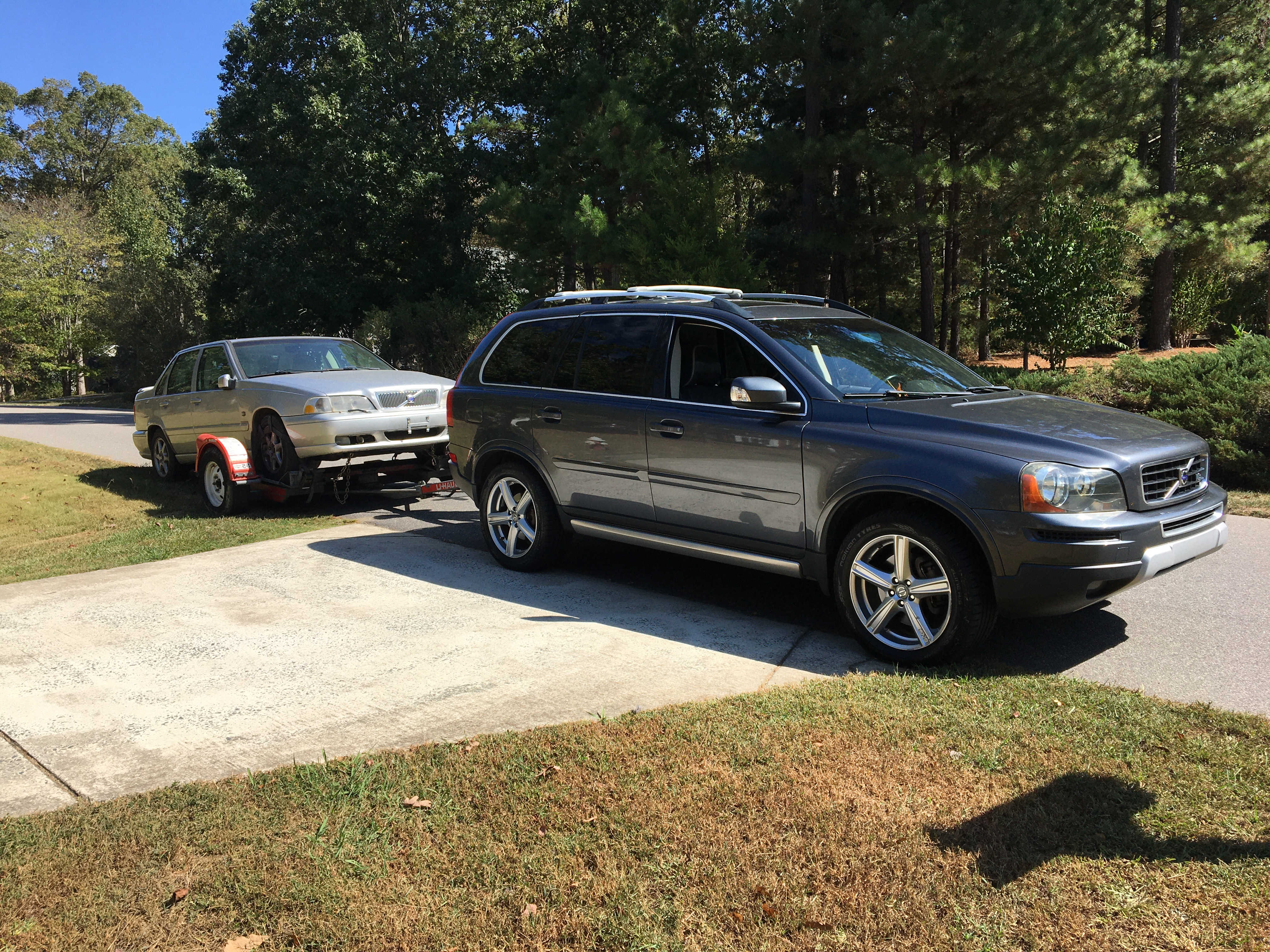

I found a Hidden Hitch at the junkyard yesterday for the XC90, bolted right on easily! An absolute steal for $28!
So naturally, I went and bought a hitch this morning and rented a dolly to go pick up my newest project.
The V8 did really well! Pulled the S70 with little effort, it felt like my cousin’s old F-150 when we pulled the 850 home. The brakes got a little hot as I got close to home (only a 30 minute tow) but I need to check those out again anyway. I just changed all four rotors and pads a couple weeks ago but I haven’t been happy with the pedal feel. Probably needs a bleed, I doubt the original fluid has been flushed out more than maybe once at 160k miles.
