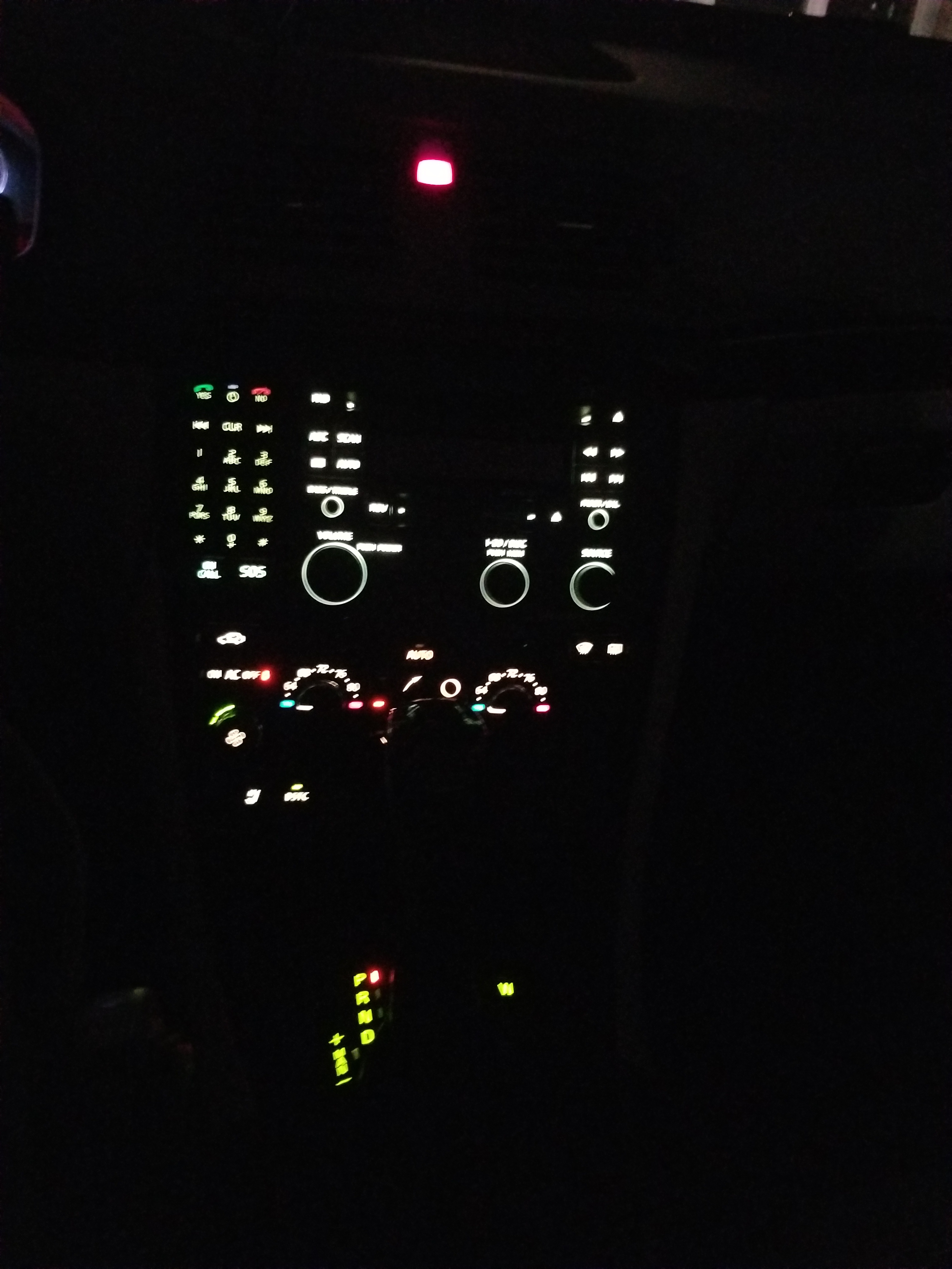

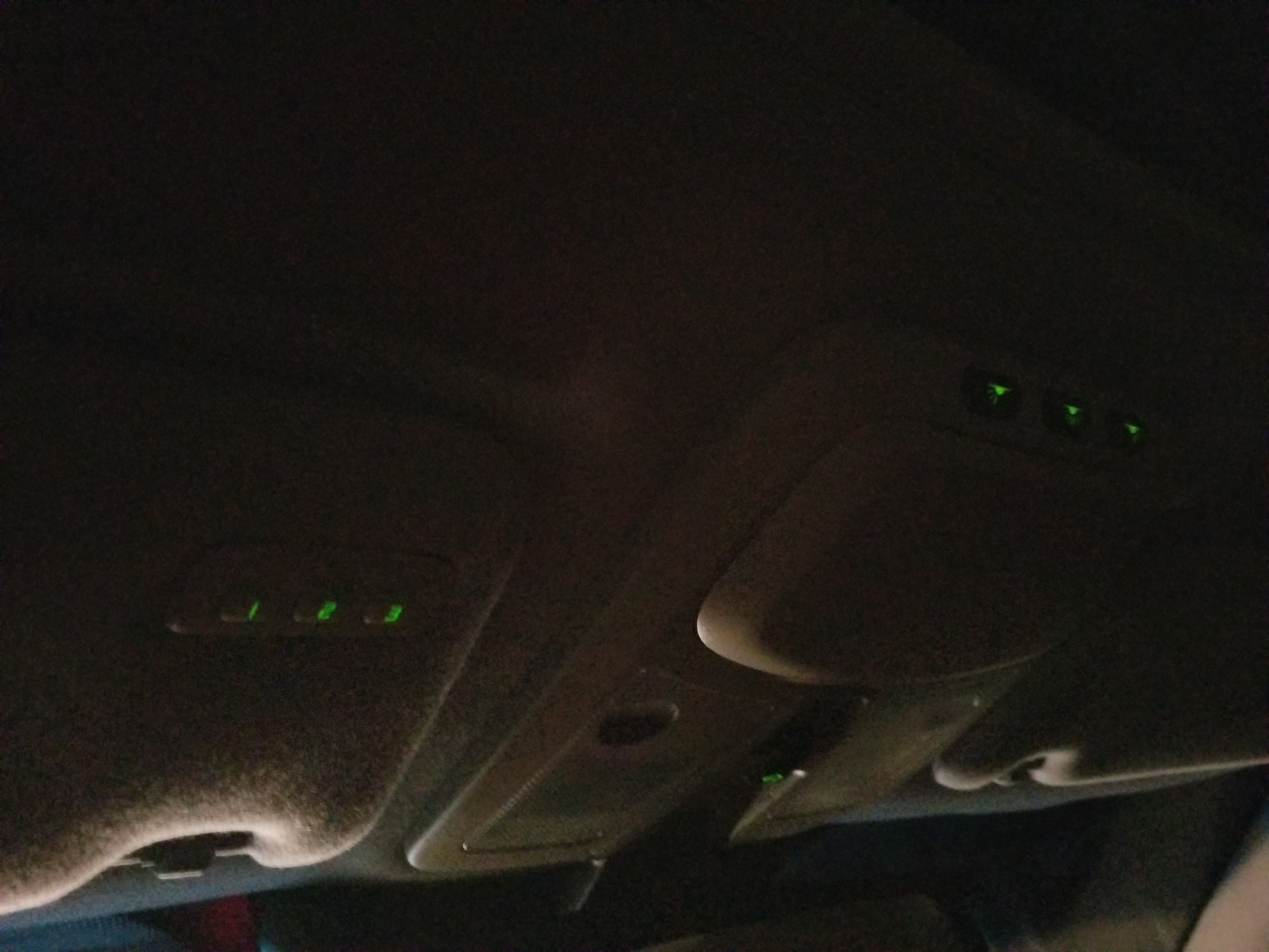

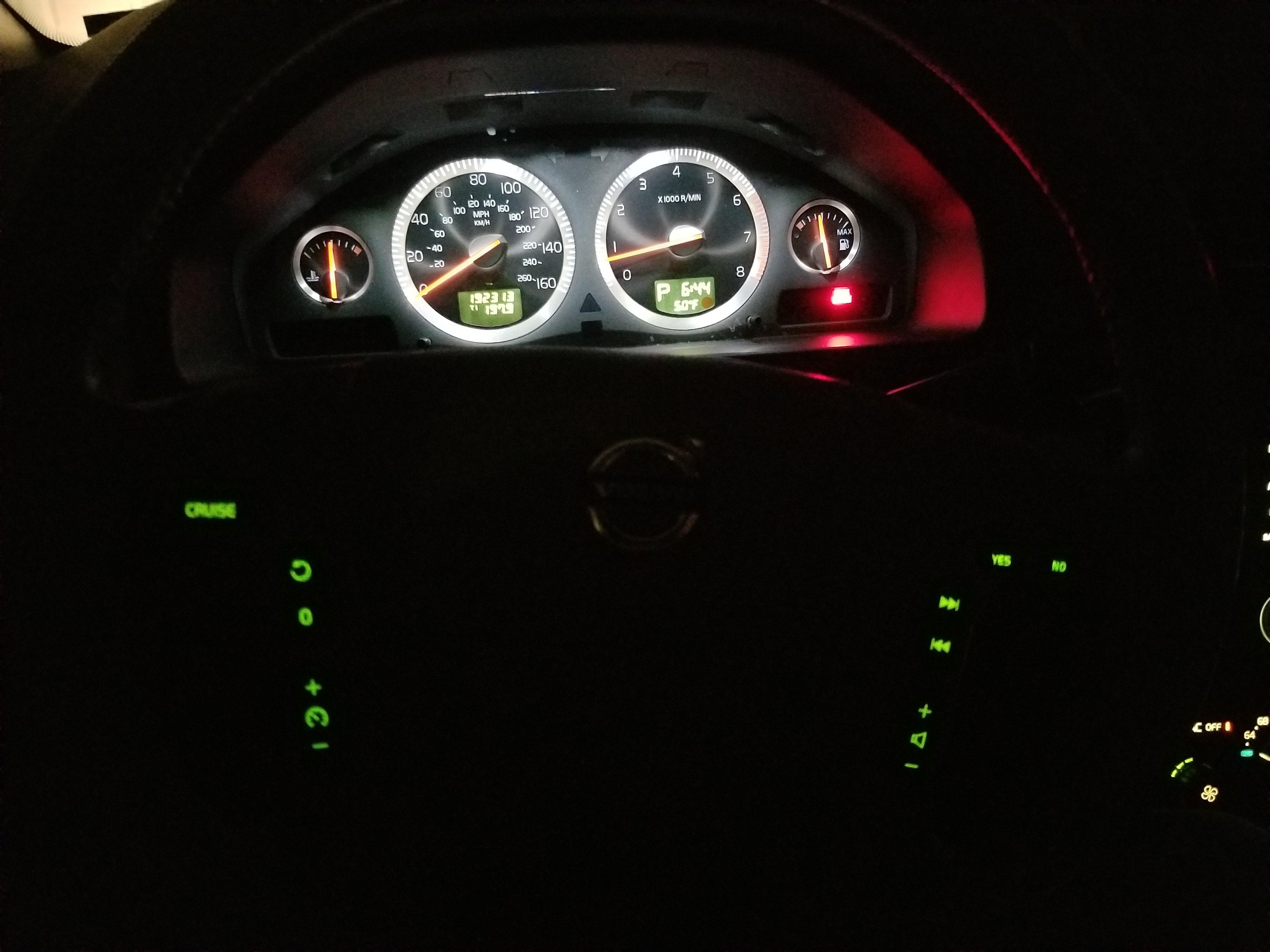

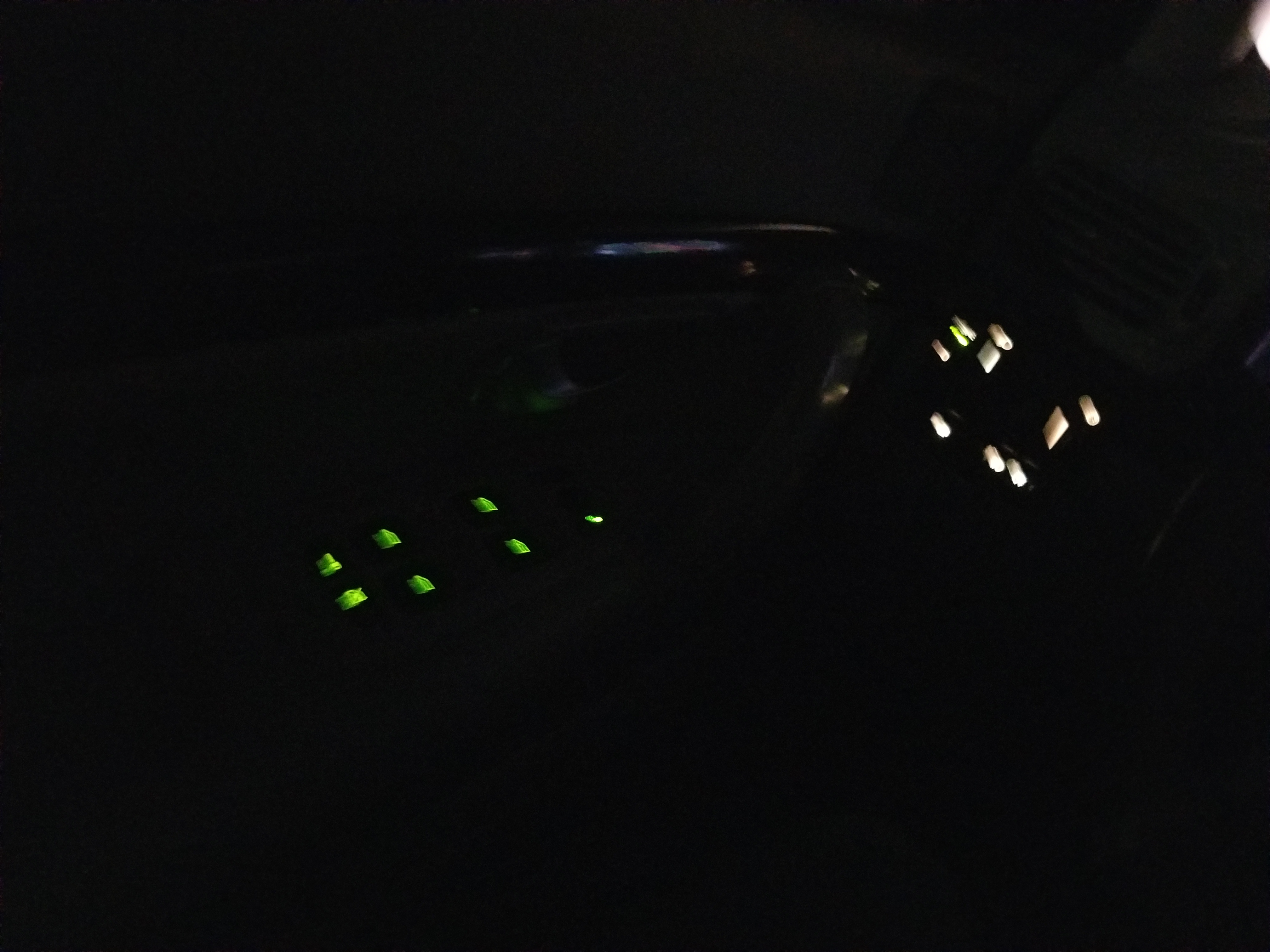

Here are the things that light up on my 2004 S80 I didn't bother photographing the rear doors and passenger door switches but they light too. June

The no backlights on the steering wheel drove me nuts so I bought an 04 wheel and had the same issue with the wiring harness not being compatible so I pulled the lit buttons out of the 04 wheel and installed them in the 00 wheel, grabbed power from another source inside the wheel. I think maybe the radio control and lit the leds that way. It was a bit messy but easy and it's been functioning now for 9 years no issues.
