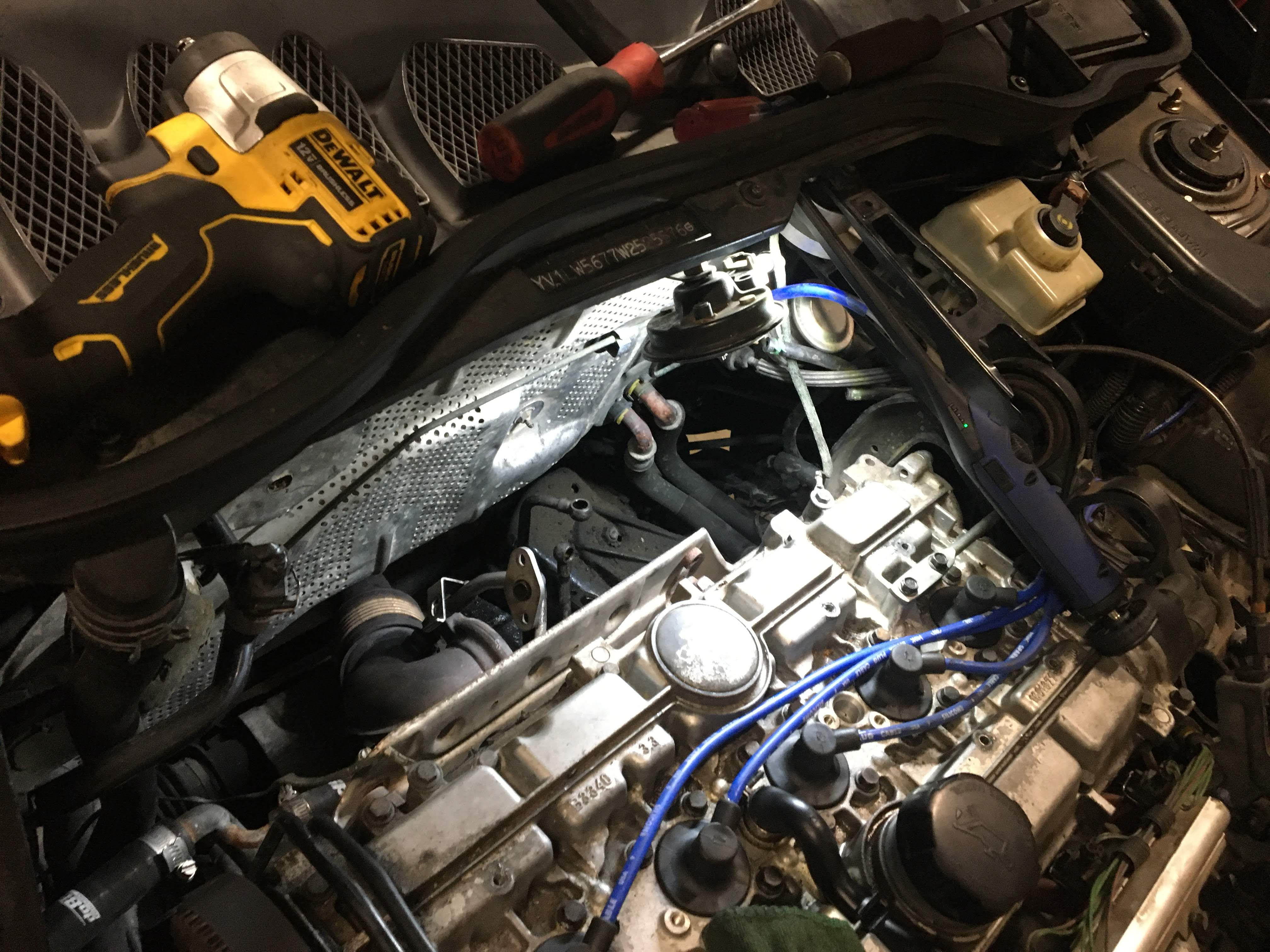

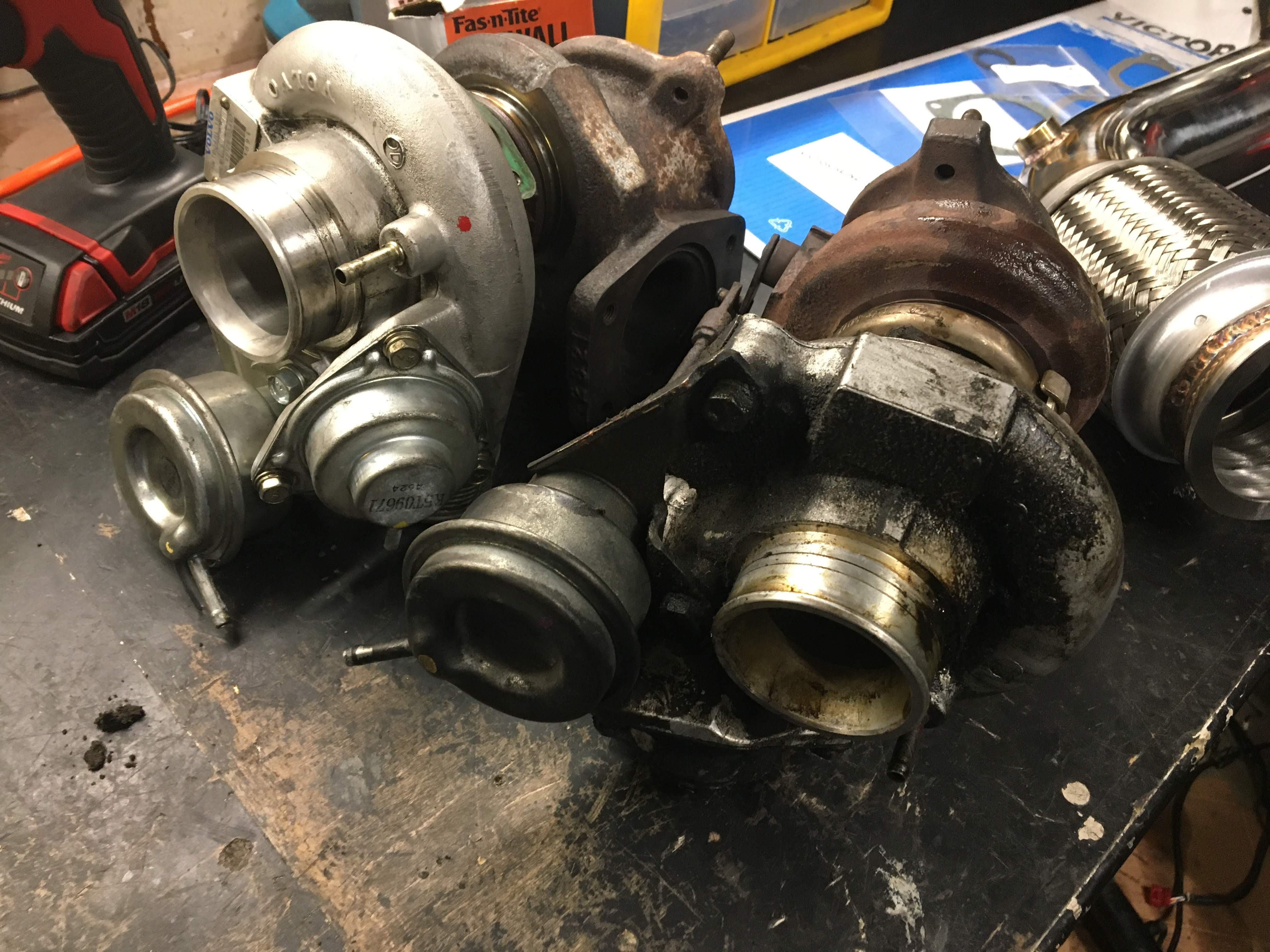

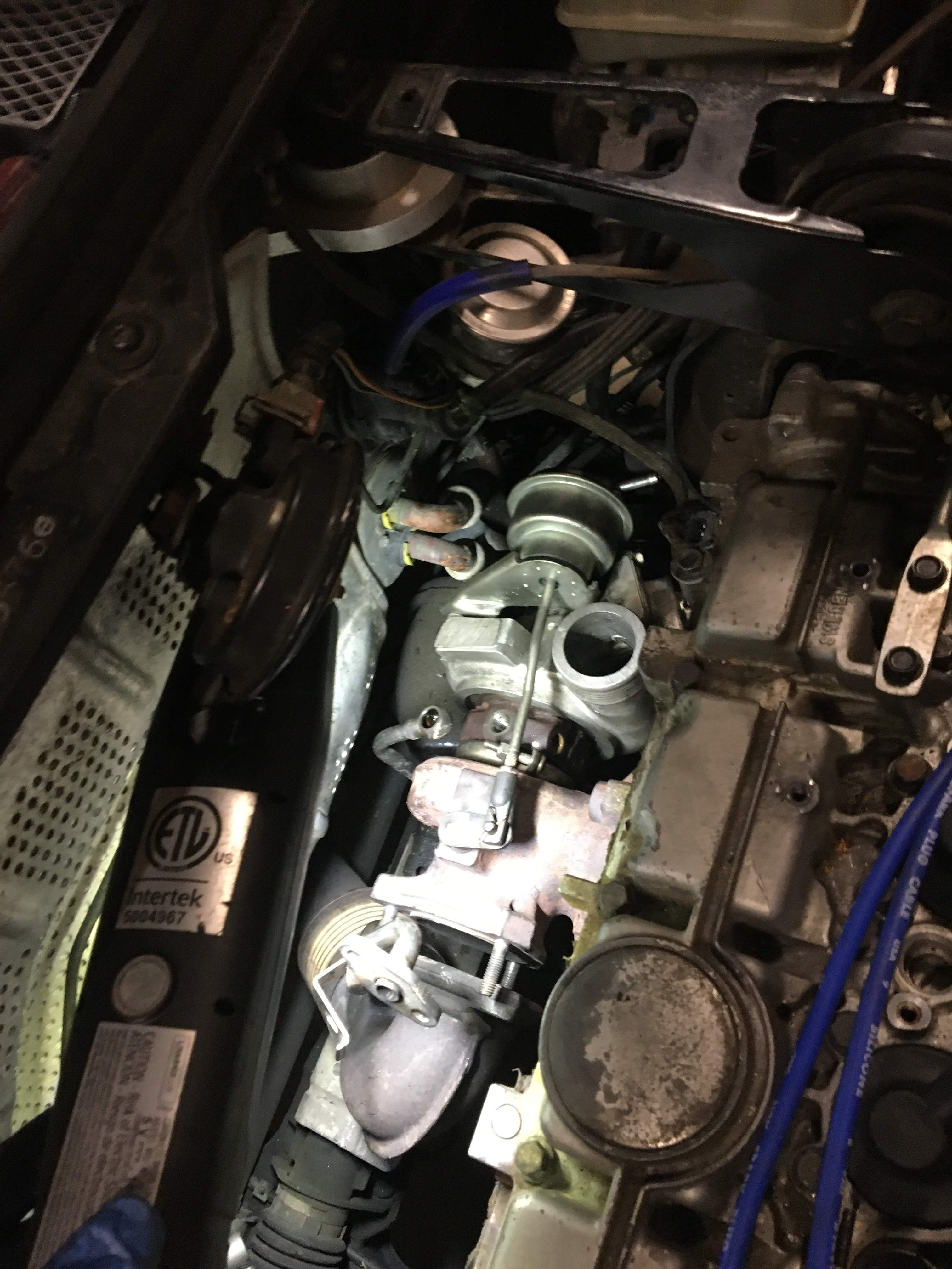

Well, the simple timing belt job turned into everything else that the owner wanted to do do this car! Last night, I got a 19t mounted (thanks to my cousin, who had a nice one on the shelf.... he didn't let it go easily!) and today I will take care of the NA intake manifold and throttle body, then the NA cams. This car is also getting an S90 MAF housing as well as DW200 fuel pump.
I'll make a short build thread after this just to document it. It's nice to be able to do these things to this car that I never got around to in my ownership! It will be a lot of fun once it's running!

Pop an IPD Blue spring into the CBV while you have that open. Use a new oil return oring on the block , too. Chased that puppy for 2 years

I haven’t been happy with the blue iPd spring. I left the stock one for now since it was in good shape.
As for the oil return o ring, I left it alone, but I’ll tell him to keep an eye out for leaks. It should be fine, I replaced it not too long ago.
