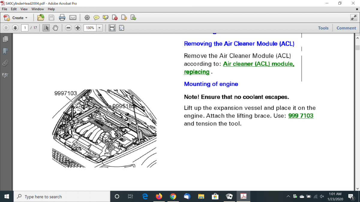

I'm new to Volvo and need to do a valve job on my '13 S60. Looking through VIDA I see the tool: 999 7107. "Support". I gather I need to support the block underneath somehow. It's very vague. (I guess only showing a picture is really not enough!)

9997107 is a 3 point engine support bar.
