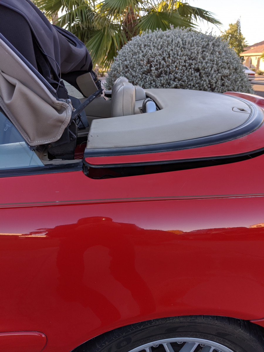

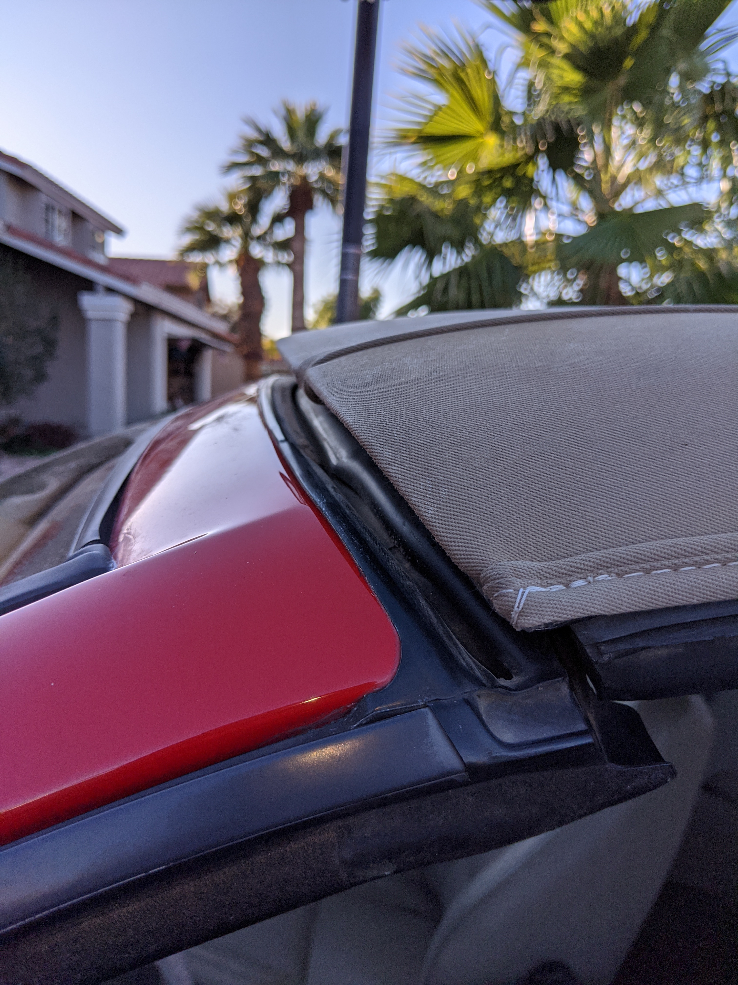

The top got stuck with the rear window vertical. The rear tonneau is at a slight angle, and the frint of the top is disengaged from the windshield portion.

Will a picture help more?

I was in the car when I tried to put the top up. Then it got stuck.
I tried to help it along its course closing, to no avail. When it stared to get dark out I went with the last ditch effort and tried to manually close the top from the trunk.
This is when the screw pushed into the motor now I am stuck. Right now I put some adhesive on the end of the Allen wrench and am waiting for it to dry to try and get the screw to come out.
Also...I will add that I gently pressed the rear window section down last night. I couldn’t leave the car open to the elements.
This morning I reattached the battery, started the car, pressed the button and the rear window came up to the position where it rests on the top.
The tonneau cover is still not going down all the way, maybe up 1 inch or so. All the motors sound like they are trying to do something....but nothing happens besides the rear window going back vertical.

OK, the coverplate looks to be down to the point the latch motor needs to operate to pull it down. The coverplate latch motor is under the other flap on the trunk top stowage well wall. You use a blade screwdriver and you do push in to disengage to motor from cables so the screwdriver will turn and move cables. You need to turn it until you hear BOTH rt and left latches click. when the coverplate latches the top module should resume operation. You will need to turn the screw driver reverse from the direction that latched the coverplate so it re-engages the cables and motor to work again.
