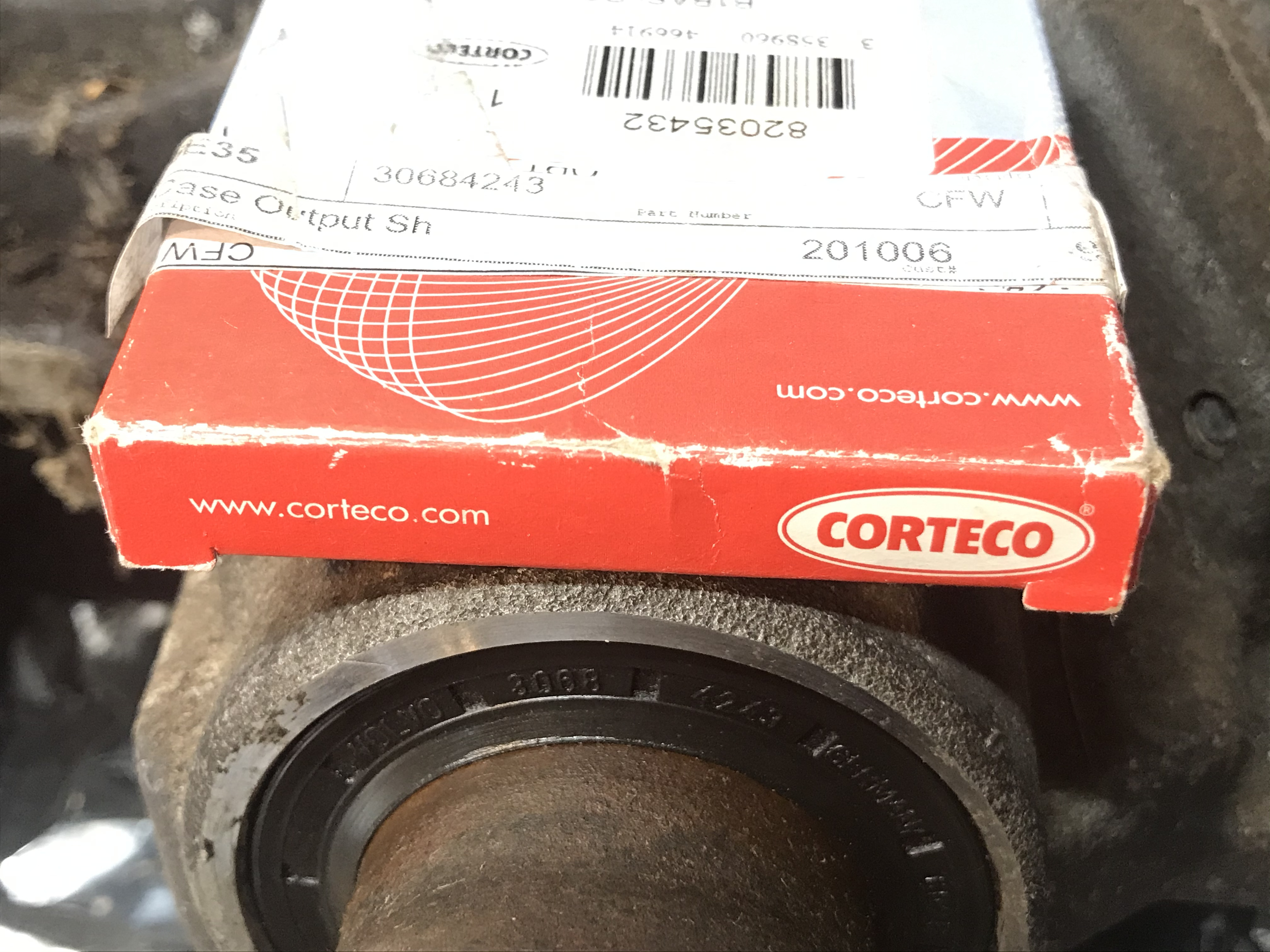

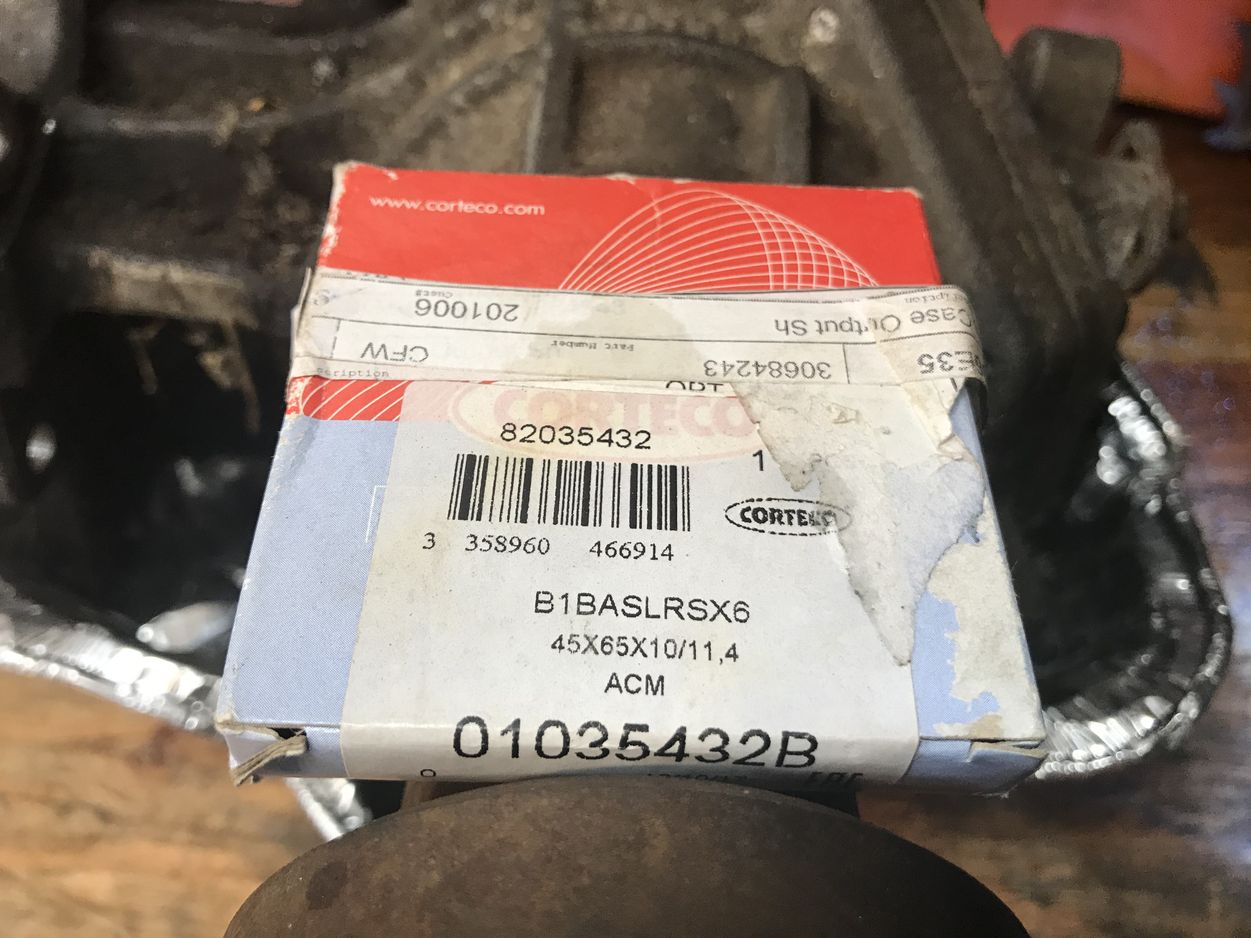

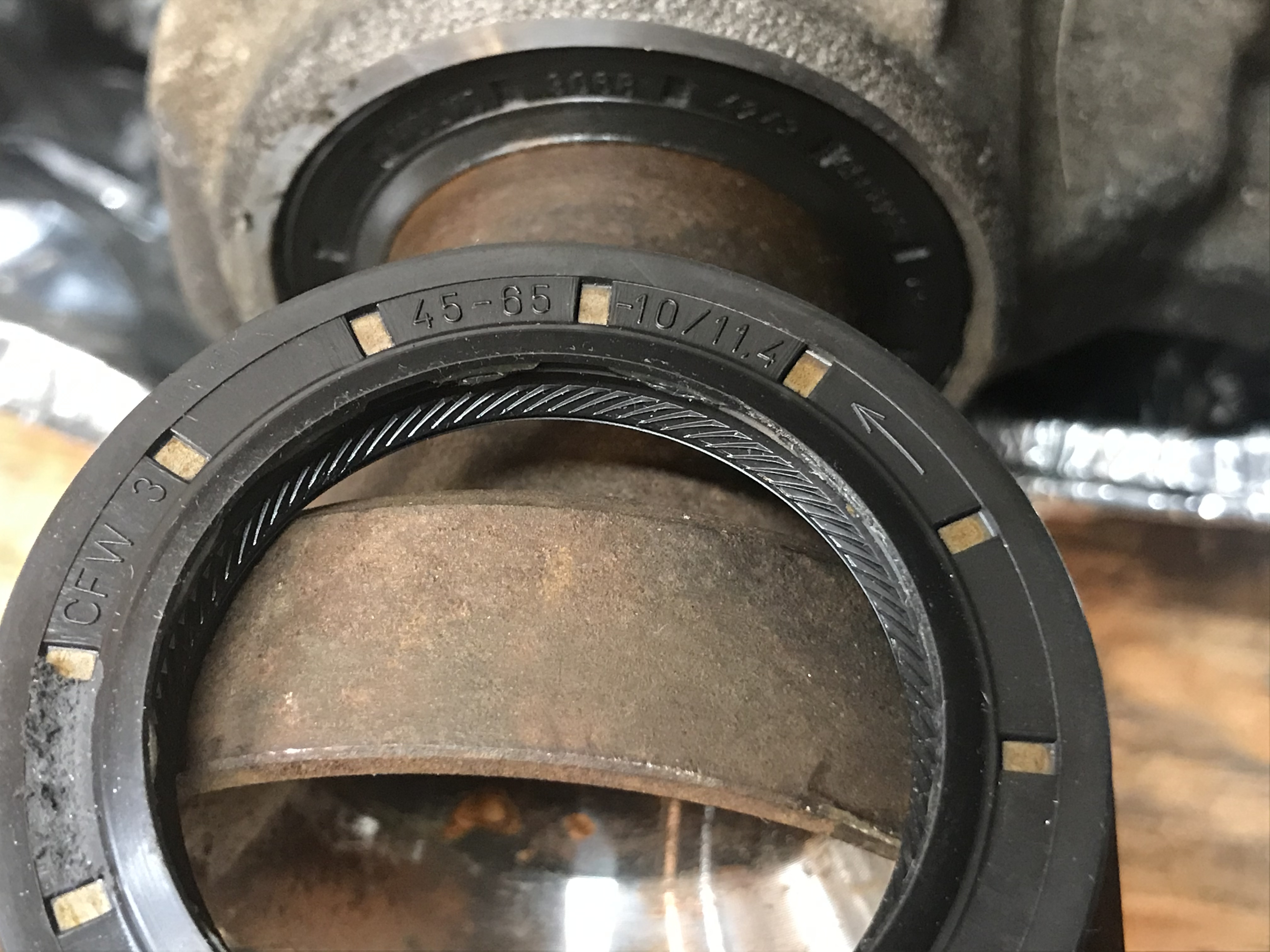

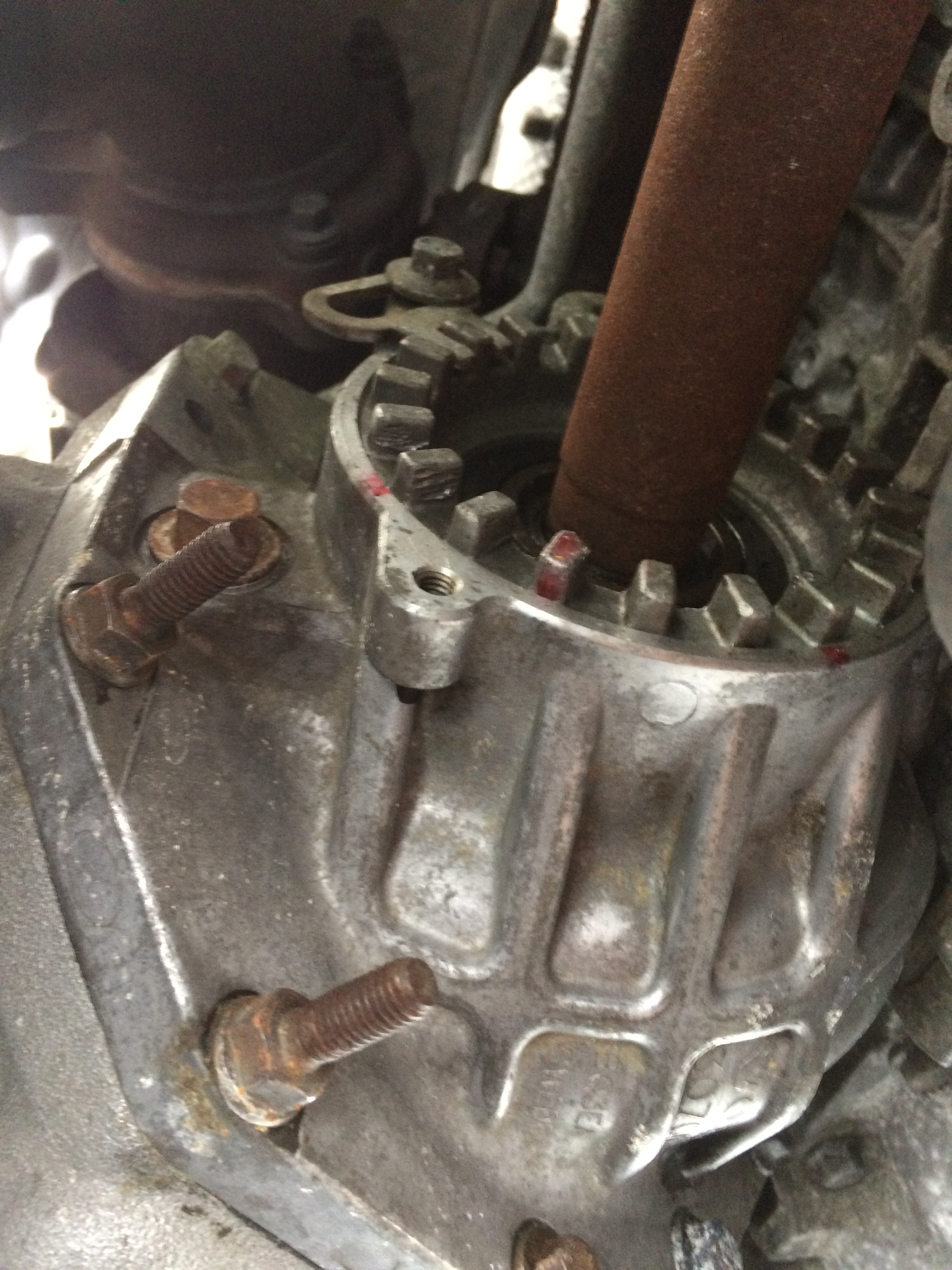

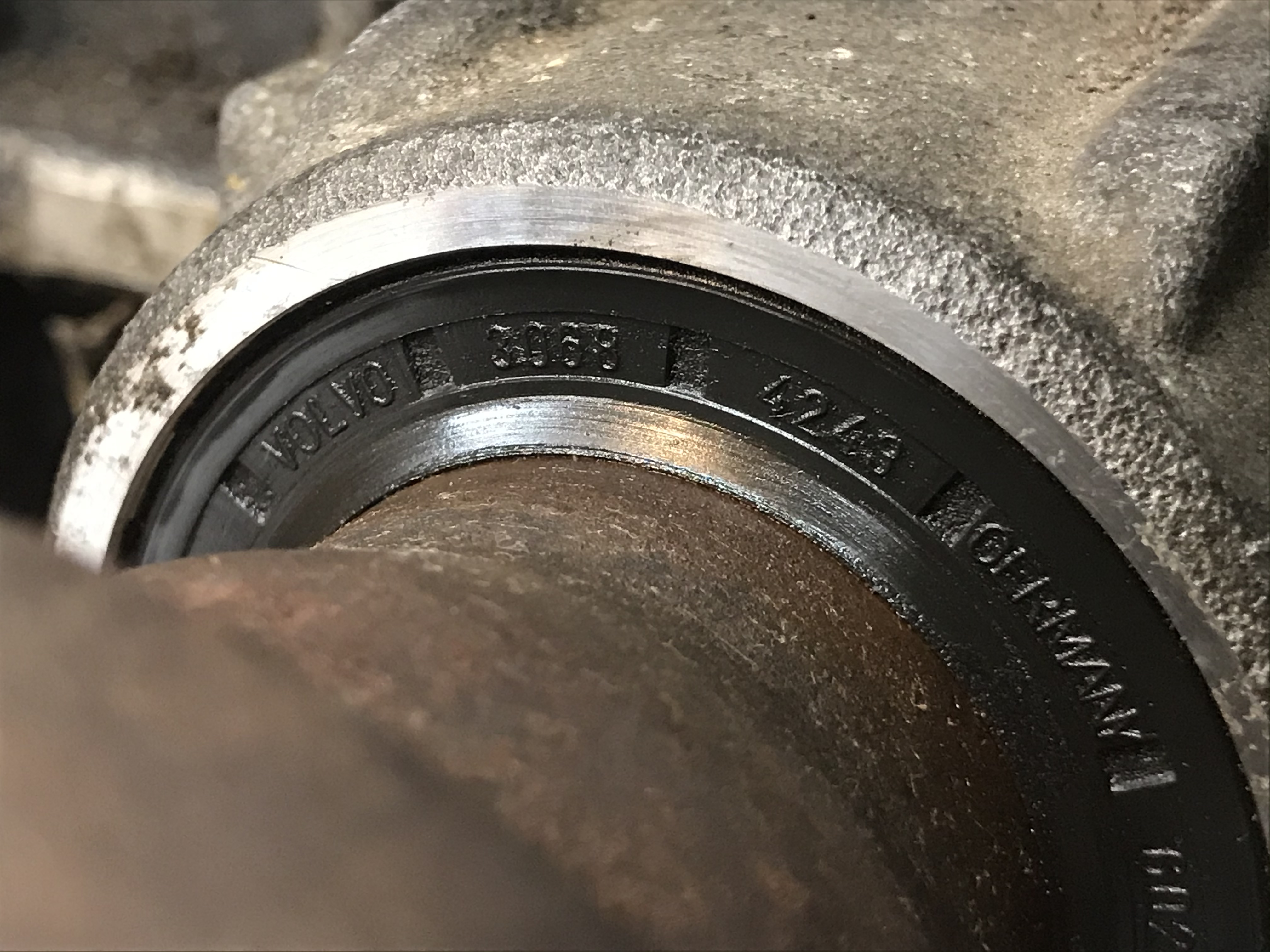

If you don't mind, I'm going to add some photos to your thread of some seals that may also need to be replaced when doing the adjuster nut o-ring. I'll also try to add seal clickable links.
The above 5 pictures are of the rear/driveshaft/output flange BG seal. They are taken from one of my spare BG’s which has already been re-sealed.
Volvo part number 30684243
It has measurements of 45x65x10/11.4
