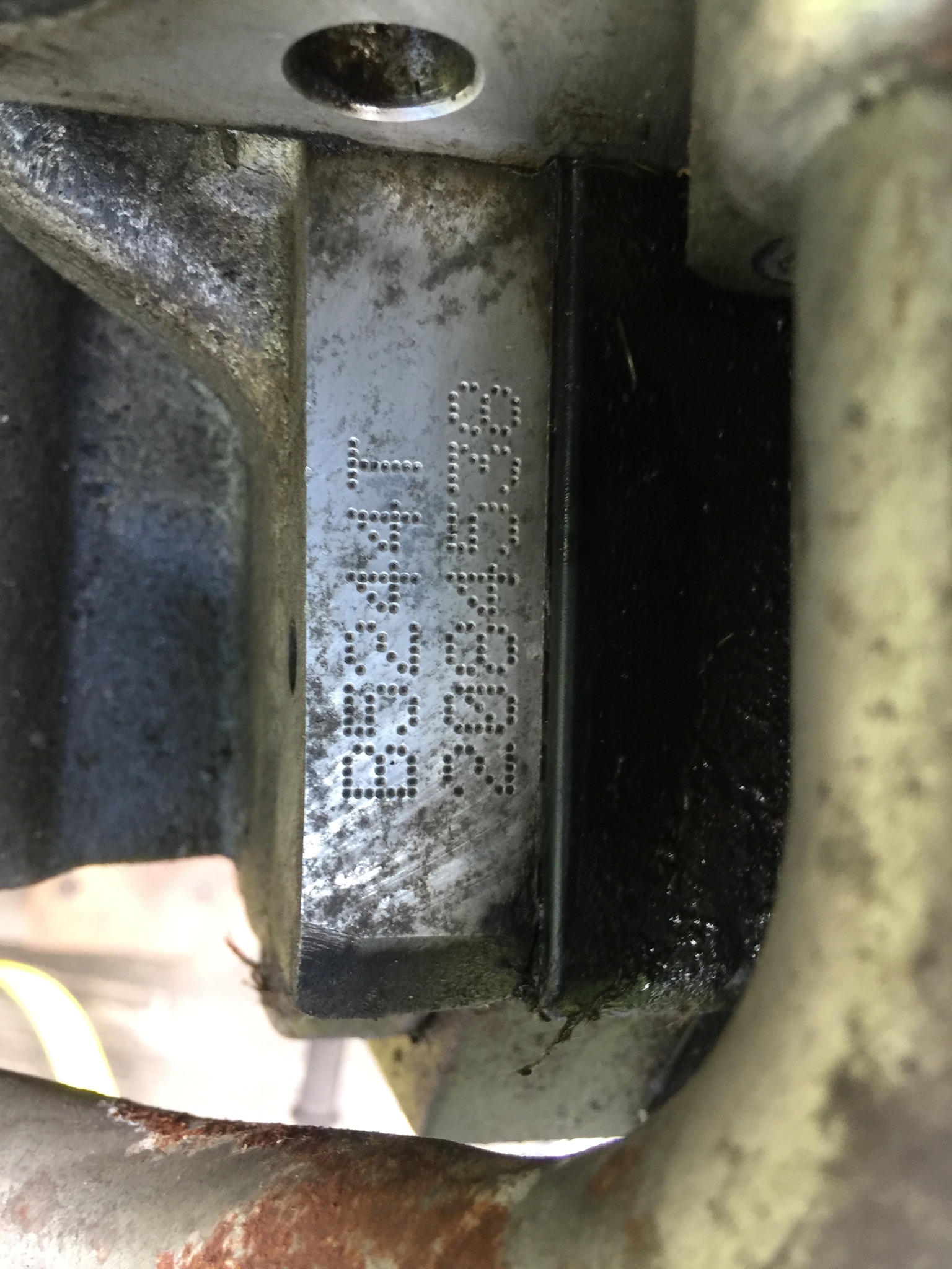

engine serial number where is it

My sticker has long ago unstuck itself from the timing cover, i want to check i have fitted the correct timing belt and tensioner kit. I cannot find info on VIDA, my registration papers have a engine number but it has too many numbers and letters in it. I looked on the engine block but cannot see anything where VIDA says it should be.

You have to remove the exhaust cover plate and look on a shelf right behind the exhaust cam side of the cylinder head, and clean it with a paper towel and gunk remover
Right “behind” to the left side of the water pipe

Its like the crank timing mark, you can't see it with both eyes and only the first 2 numbers are accessible.
And thats if you know exactly where its located and get it cleaned enough to read.
Photo above is probably from a boroscope.
I reached in with my cellphone and took a dozen photos, finally got it after scrubbing the shelf with a toothbrush and brakecleen.

abscate wrote: 13 Jun 2020, 04:57 You have to remove the exhaust cover plate and look on a shelf right behind the exhaust cam side of the cylinder head, and clean it with a paper towel and gunk remover
I wish mine was looking this good
On P2 cars Volvo hired an old lady to stamp the blocks
