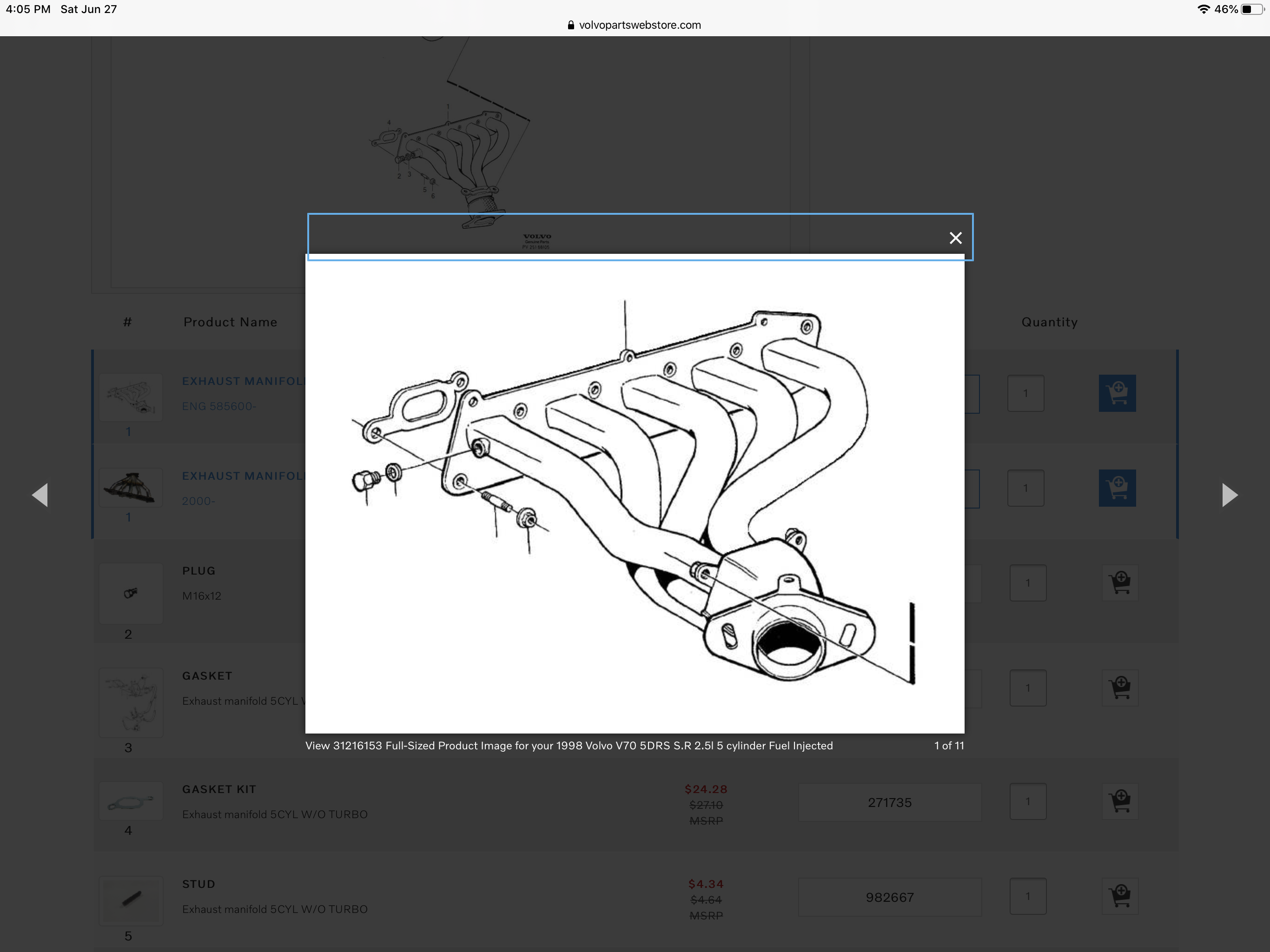

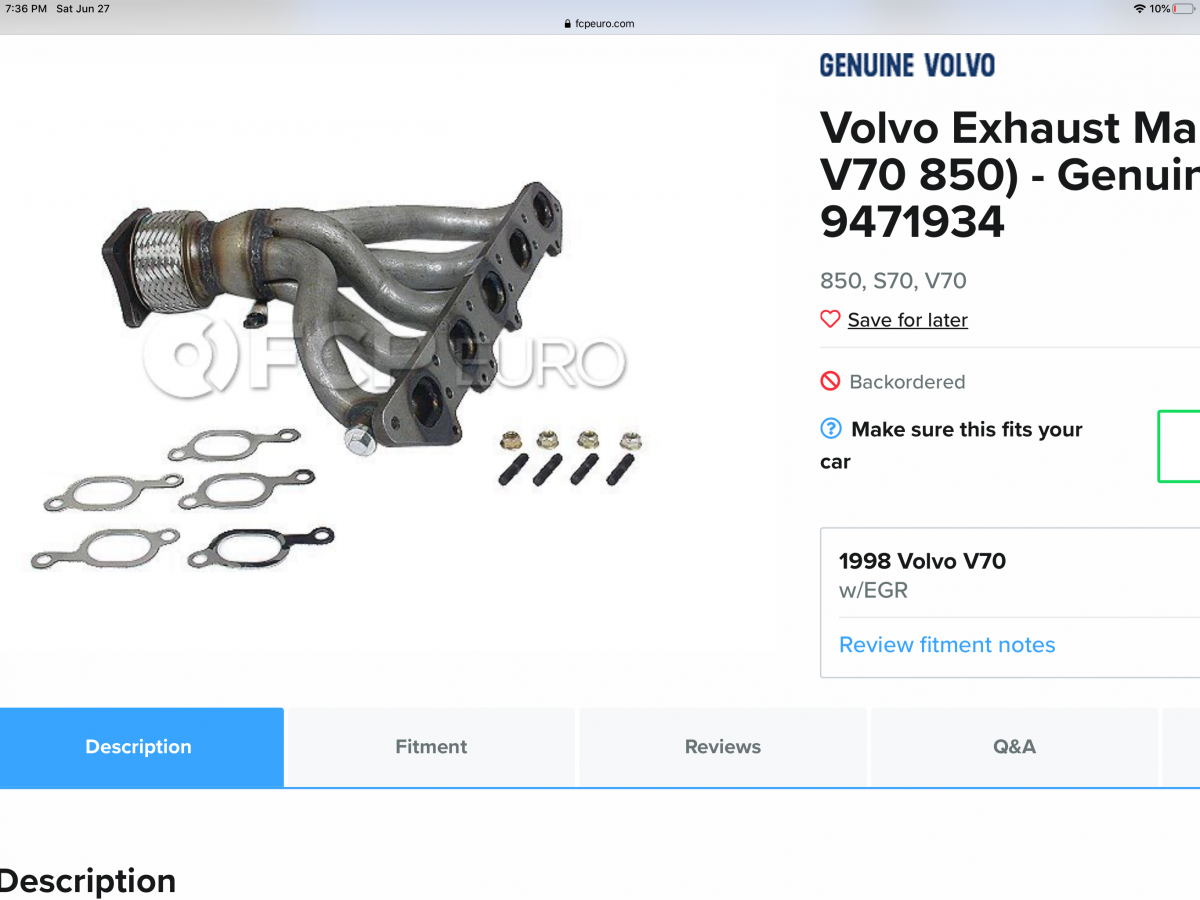

Part 1, the actual exhaust manifold.
There is a accordion flange allowing flex between the head and pipe, and then a mesh steel part that seems to either strengthen the flex or damp the motion. That part is corroded away, and that’s the part I have to make a decision on path
See mesh on the FCP picture
Note the fitment note is wrong , these cars don’t have EGR, they have SAS or air injection
Tats not a hard weld if I can source the mesh material but that seems problematic. Cutting open a flex exhaust piece is an option

I believe you can buy just a replacement mesh flex section and likely get Mike to weld that without too much issue.
