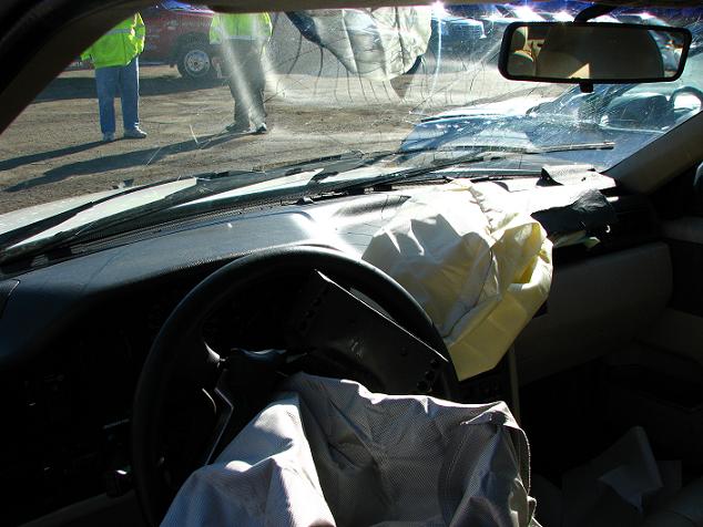

After the accident that deployed my airbags, and spidered my windshield, I tried to put the car back into shape quickly and at a reasonable expense.
I removed a windshield at the Pick and pull yard and it's not difficult on a parts car when you don't care about the trim and paint, but the glass installers have the correct tools to get it out quickly and cleanly.
So after bringing home the windshield from the parts yard, I found it to have wiper scratches I did not want to deal with in night time driving situations. I bought replacement glass and it was done right.
Bottom line, I didn't want to do to my car what I did to the donor car, and secondly, I was much happier with flawless glass for about $120. Install was $80. More than fair for something that is a structural and safety component.
This was probably the only new part I purchased in order to get my car on the road again.
By the way, I still have the one that I removed myself from the parts yard. They don't ship well though.
Good luck.
