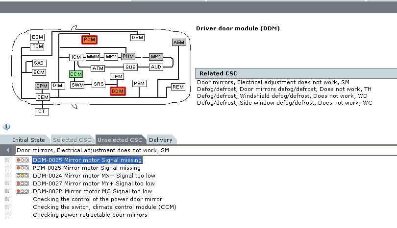

Do you have VIDA and a DiCE? They would make troubleshooting a lot easier.
The module in the drivers door (Drivers Door Module, DDM) controls the window and the mirror and the puddle light directly, which is how your mechanic can apply voltage and move the window. In the passenger door, there is the Passenger Door Module PDM, which controls the passenger door mirror and puddle light directly. The window and mirror can either be activated by the local switches on the DDM, or via digital command over the CAN Bus. When you operate the passenger window and mirror from the drivers door, the signal is sent via the CAN bus, and the PDM actually closes the relay to move the mirror/window.
You can also connect to the DDM and PDM via VIDA and send commands to raise/lower windows, move mirrors, etc. You can also see the status of the switches in the DDM and PDM. With all this visibility, you should be able to see what is working and what is not working.
It's through the CAN bus that the seats and mirrors get reset when you unlock the car. The key talks to the Upper Electronic Module (UEM), and the UEM sends commands to the DDM, PDM, and seat module to move to the stored locations.

Thank you Roger for the amazing info, the mechanic said he couldn't see the side mirror through his software but again he doesn't have the subscription to program it either.
I am trying to see if I should buy another used DDM or send it my existing one to the dealer for software download.
My research shows a DDM needs programming by VIDA but I can't explain why putting a new used switch makes the passenger window and its mirror , both rear windows work?
