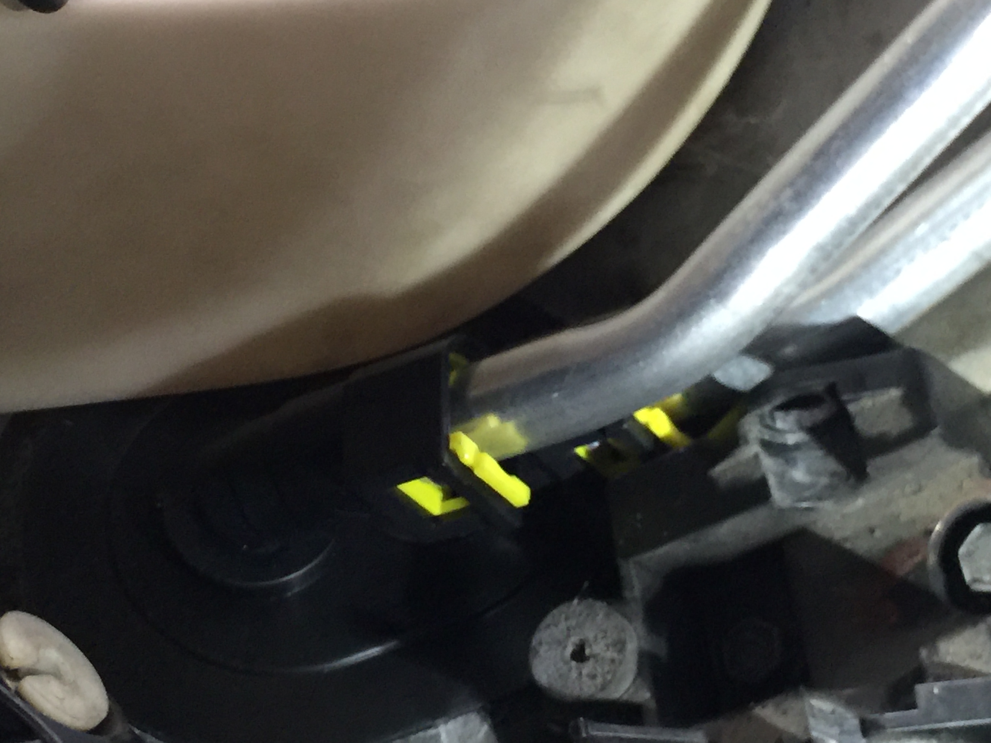

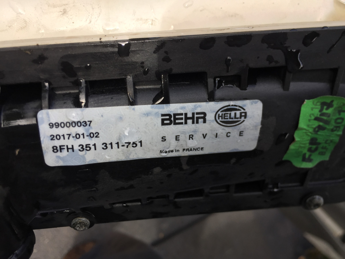

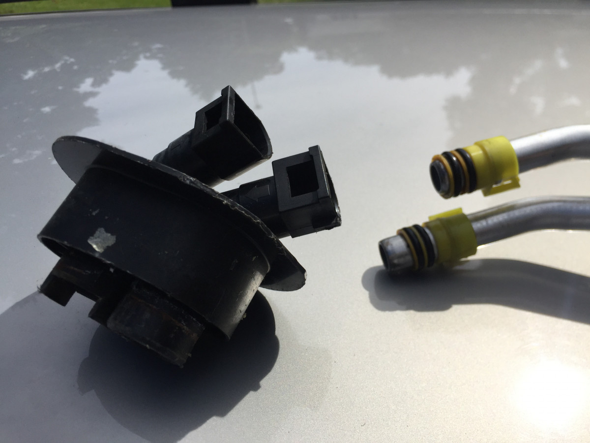

Instead of lunch I put Earls heat back in
New heAter core bulkhead , flush and test
ZionXIX
Posts: 1310
Joined: 11 August 2014
Location: Texas
Has thanked: 65 times
Been thanked: 194 times
Post by ZionXIX »
Fun times. That junction is such a pain for me to get to.
Posts: 35311
Has thanked: 1506 times
Been thanked: 3822 times
Its a real b***** isn’t it?
Job tips to be documented
Pull the gas pedal out of the way, pull pin to left. Unclip pedal
Yellow clamps face down to engage slots
It’s just possible to sneak the bi]ulkhead past the climate unit without removing it.
Top goes spacer oring spacer oring
Torx 25 on heater core screws, Torx 15 on side screws
Torx 25 machine bolt on core bulkhead, dimension in picture
Two orings on water pipe connect
