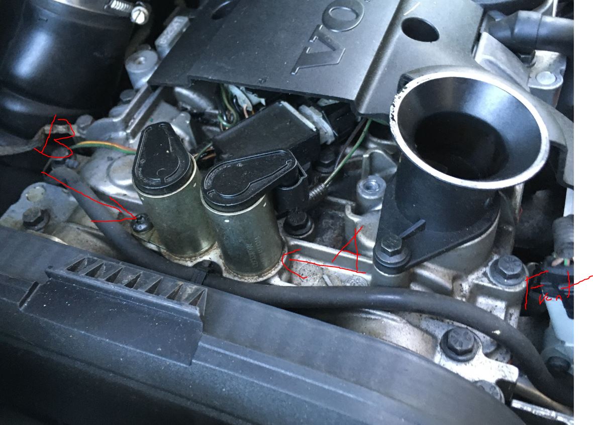

With this code
is it to one or the other? (A or B )
or how should i test those?
Code P0027, which solenoid ?

P0026 Intake (A).
P0027 Exhaust (B).
P0027 Exhaust (B).

Any idea of a good way to release the bolt on B?
i cant seem to be able to release it, not manually and not with impact driver drill. its just on the edge of breaking the hex teeth...

If you are using a Hex bit you are using the wrong tool. It is a Torx so use a Torx bit. If a Torx bit will not break it loose. Heat it with a Micro torch for 90 seconds. Then turn counterclockwise.Mikele82 wrote: 04 Sep 2020, 20:25 Any idea of a good way to release the bolt on B?
