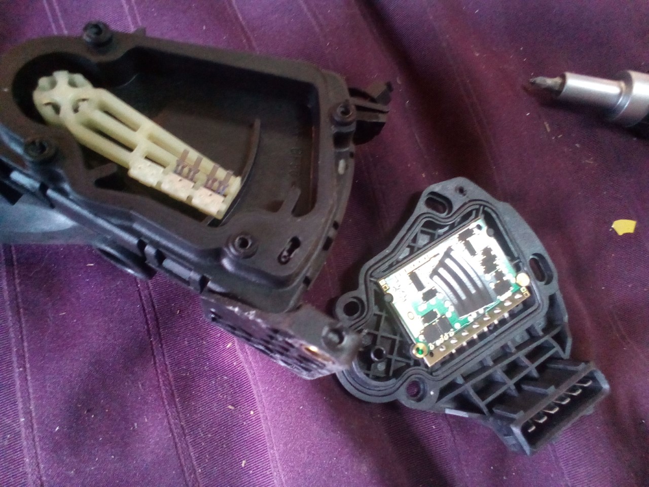

Jumping RPM is i believe the ETM or the early years pedal was also brushed. I changed both my ETM and pedal to contactless to avoid these issues.
- pedal swap
- pedal swap.jpg (38.31 KiB) Viewed 3321 times
