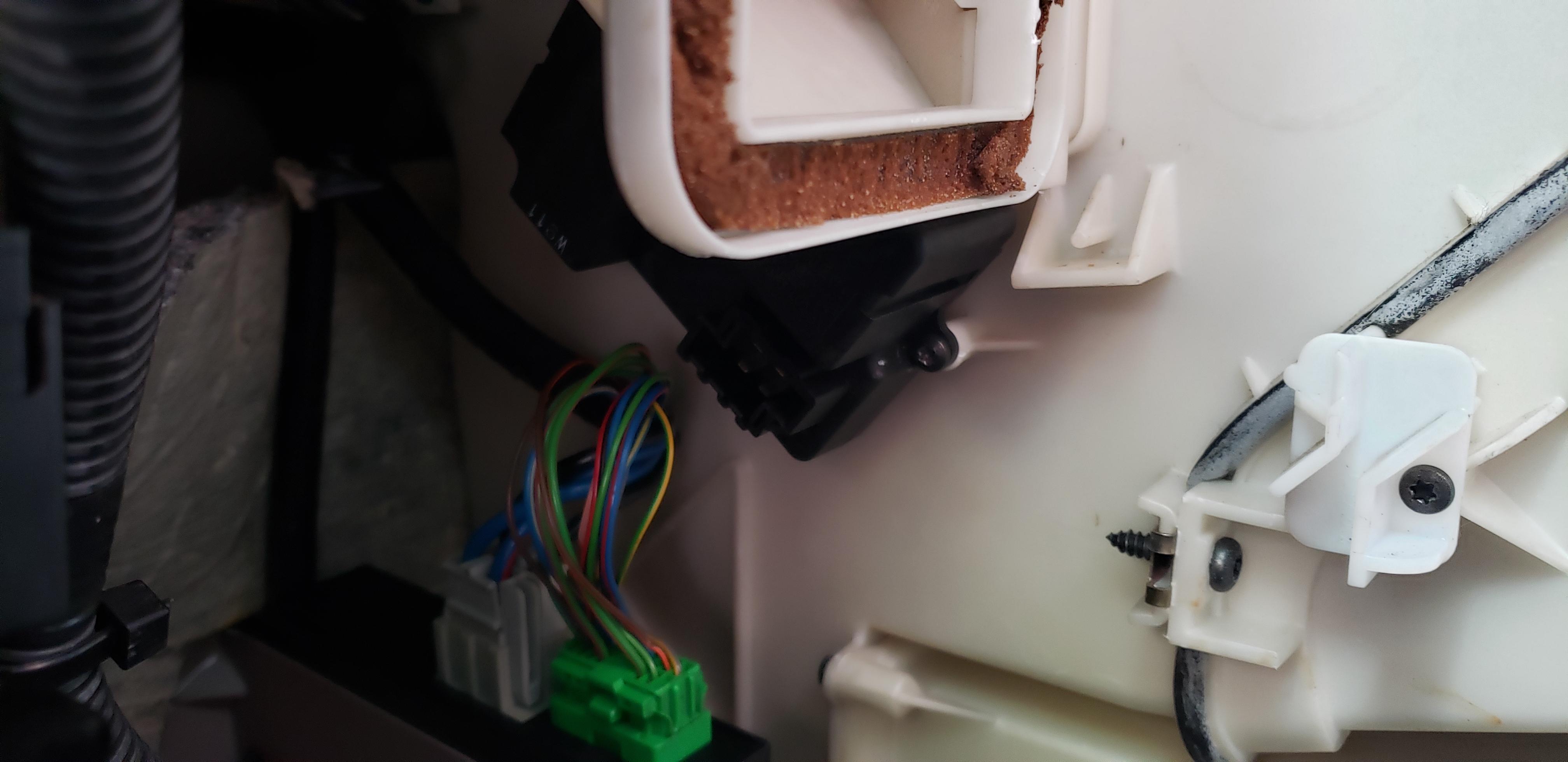

Hello, I am getting flashing green light on ECC and CCM-222 air distribution damper motor signal too high in VIDA, This IS the motor I need to be looking at right? There looks like another motor a bit lower and more towards the outside of the car, but I don't really want to extract it unless I need to. But I THINK the one in the pic is correct. I replaced it with one from ebay and still not getting it to calibrate. any ideas?
Thanks
Rob
