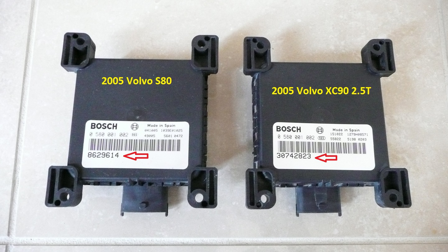

Add another one to the mix:
* 8629614 = Bosch 580 001 002
* 30742823 = Bosch 580 001 002
So basically 8629614 is the same as 30742823.
In other words, to me, all these PEMs are interchangeable, functionally speaking...
