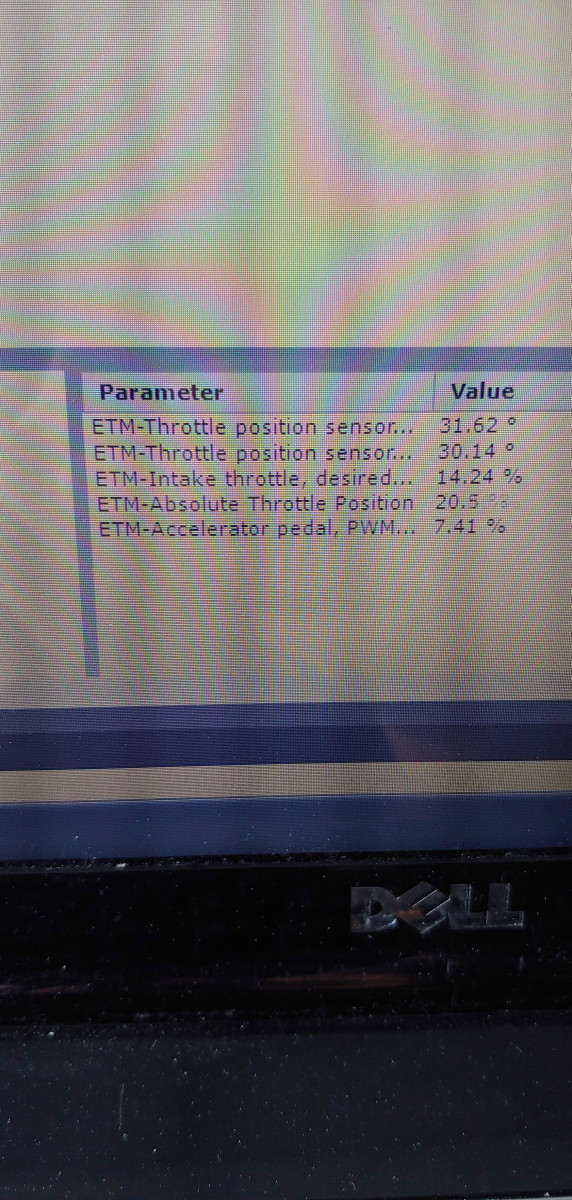

Still trouble shooting my 2002 s60 non turbo.. VIDA is showing ETM at 20% at idle.. Seems a bit high.. Also performed the ETM test and is never went below 16° (I can't remember if that was degs).. Etm reading from both sides was within spec (less than 13° different) it was only max 2° different..
The ETM is a white label from a yard, but not sure what's causing the butterfly valve to be open so much.. The body itself had been cleaned of any gunk..

i will check later.. but i believe during the test it stated i had the correct (2006+) software version installed... here is the etm test... seem ok on the surface..
