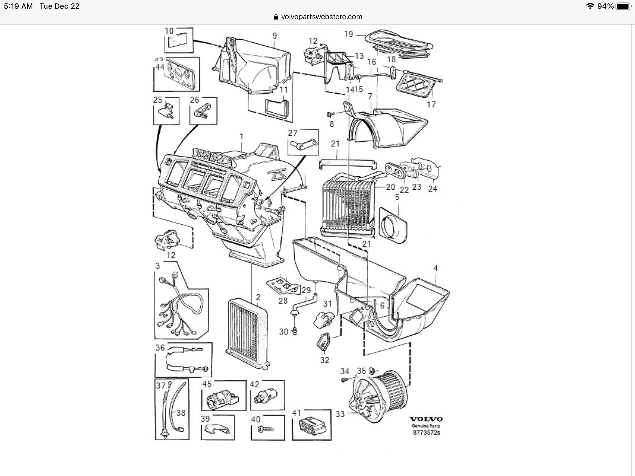

I dont think I am explaining “things” correctly. Essentially I only have air coming out through the defroster area and dash vents. I am getting no air to the floor, regardless of where I place the switch. I think my system is MCC as I dont have temps listed, only the blue and red colors on the temp controller.

You do have dampers, not cables controlling air flow on your 1998 if it is like mine.
Pull the driver kick panel down and see if you are getting any noise from the motors on the sides of the white climate unti. Look up and see if the linkages are in place.
Part 12 in this diagram
